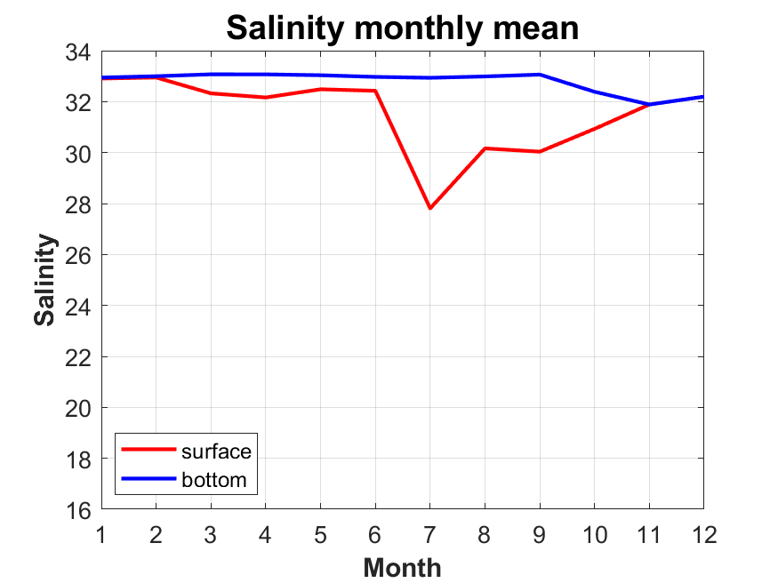

2) How can I calculate vertical salt fluxes's contributions?
Initial salt(in January with homogeneous water) is about 33 and last avg daily mean salt(in December with homogeneous) is about 32 after 1year.
And stflx yearly sum is calculated as -3.3902e-06 m/s as grid mean value.
The lake depth is 10m with plain bottom and vertical layer is 10 layer.
