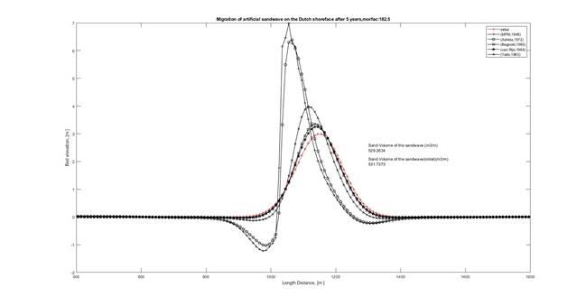

I also try to change this bedload_coeff with the reason, different researchers propose different equation for obtaining the bedload transport rate (from van Rijn, Bagnold, etc.) and change my sandwave migration (my study) significantly as shown in figure below.

zo=zoDEF(i,j)
3. yes you should be able to set bedload coeff =0. There are many bedload formulations, this is not an exact science. there are many factors that influence sed transport such as variations in grain size and flow turbulence.
