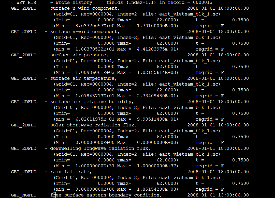

You have a problem with the longwave radiation forcing data:
GET_2DFLD - downwelling longwave radiation flux, 2008-01-01 00:00:00.00
(Grid=01, Rec=0000001, Index=1, File: east_vietnam_blk_1.nc)
(Tmin= 0.0000 Tmax= 62.0000) t = 0.0000
(Min = 1.00000000E+37 Max = -1.00000000E+37) regrid = F

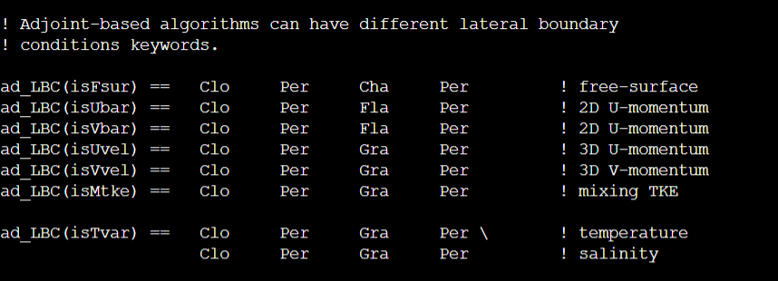

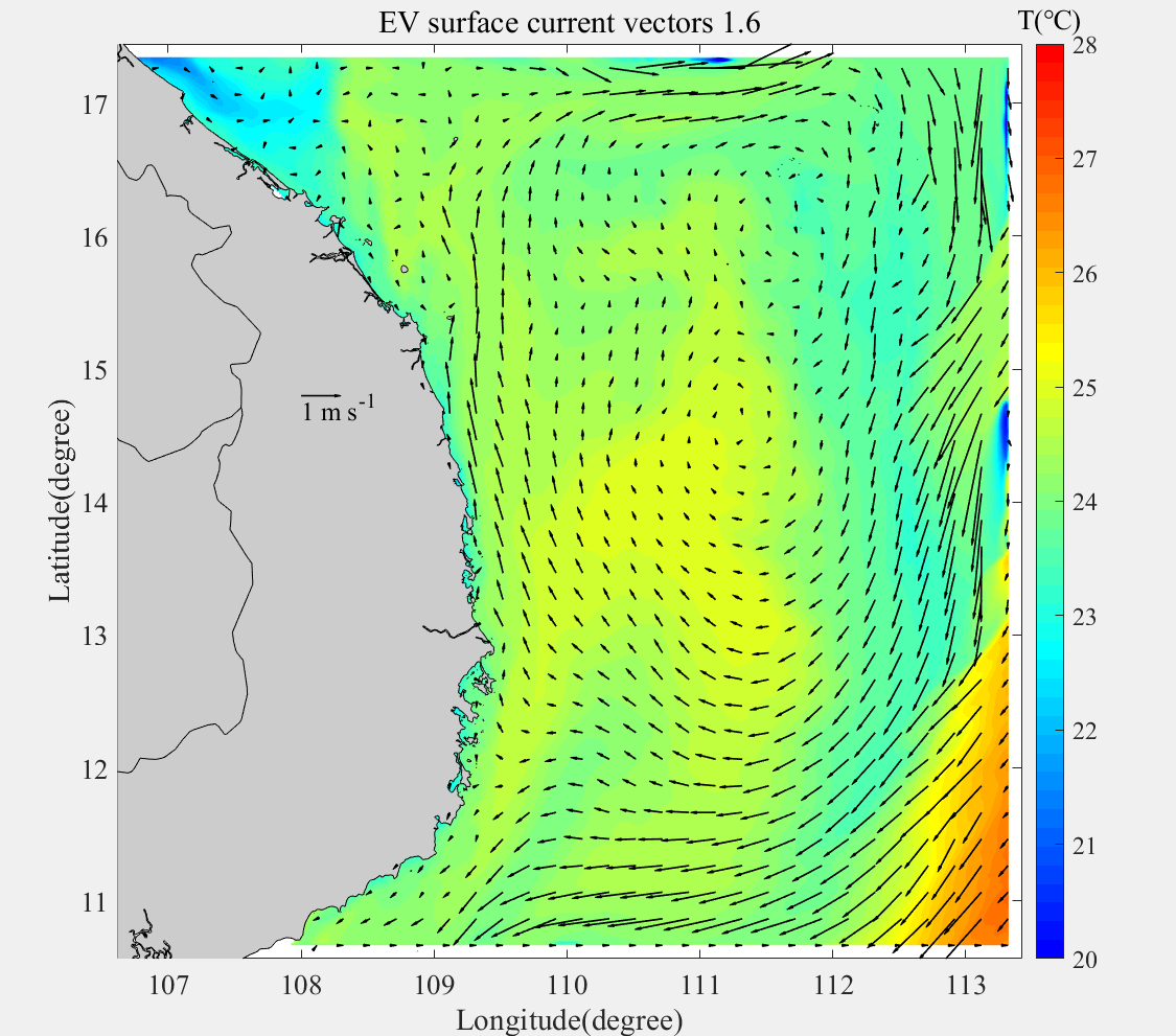

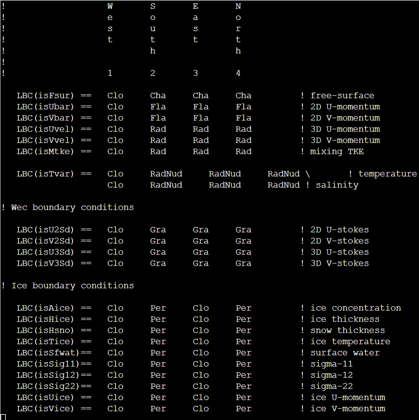

Thank you very much for your reply. Your observation is very careful. After reading your suggestion, I have corrected my forcing data. The surface wind field data is normal after checking the his-output file, it seems that the surface wind is not shown in the avg-output file. However, there seem to be some temperature anomalies at the boundaries of the model. I think this may have something to do with my lateral boundary conditions keyword. Can you check it for me? I would greatly appreciate any help or guidance.
