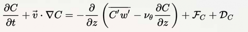

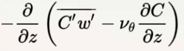

In ROMS, the tracer equation is like follows:
In my application, I only need the advection and local term in the tracer equation. In other words, I just need the left-hand side for the tracer equation. I don't want to any term on the right-hand side.
I have tried many times in myself before. If the right-hand side in the tracer equation above equals zero, the tracer should be conserved, while there is always some dissipation after I edit the code. I don't know how to close it, while I need to close it.
Could anyone tell me how to edit the code in ROMS? Which file should I edit? The right-hand side term is in which file?
