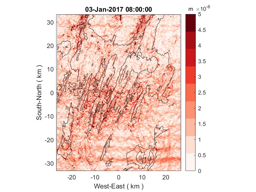

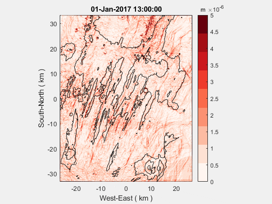

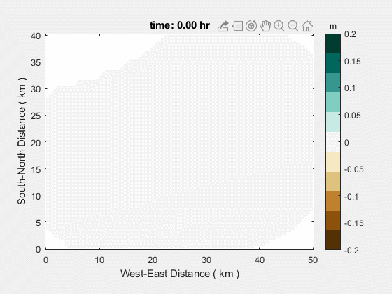

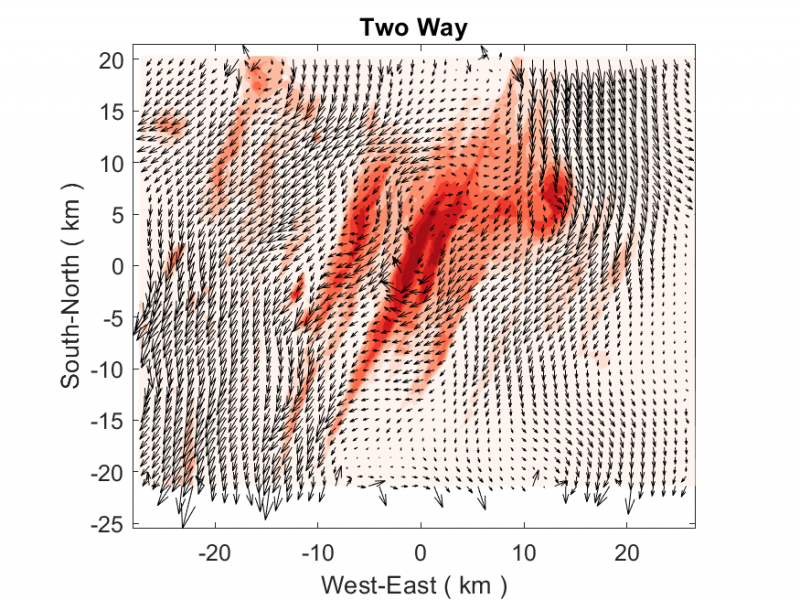

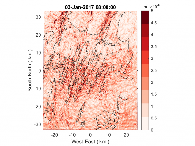

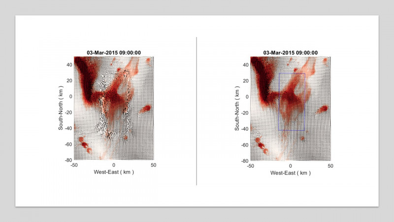

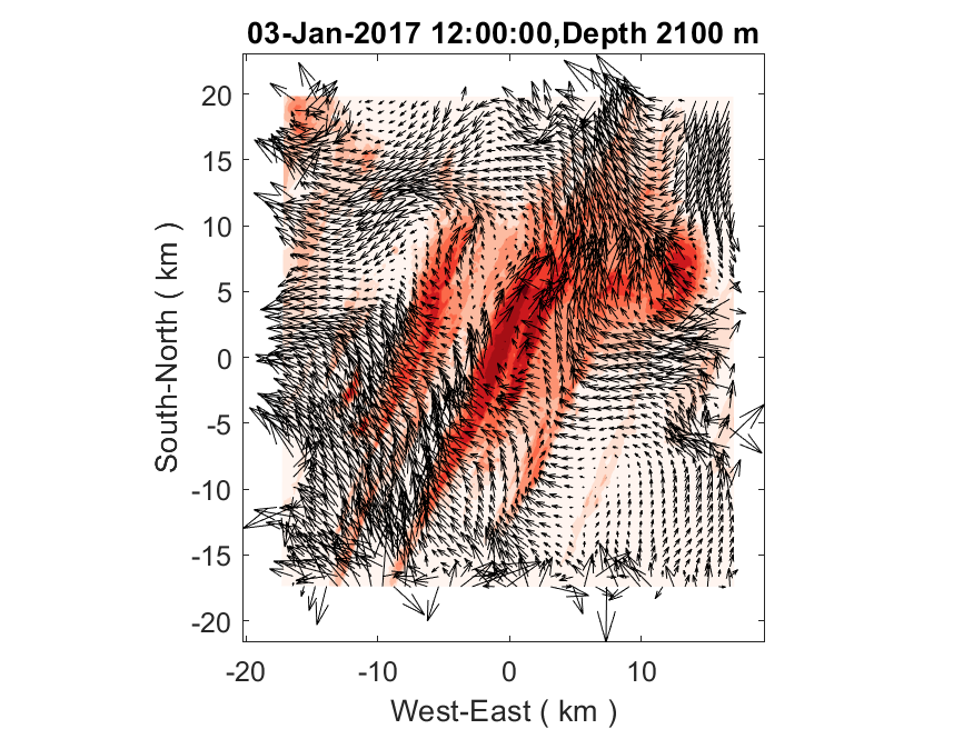

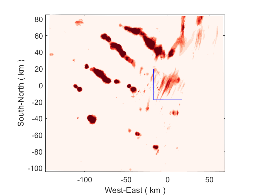

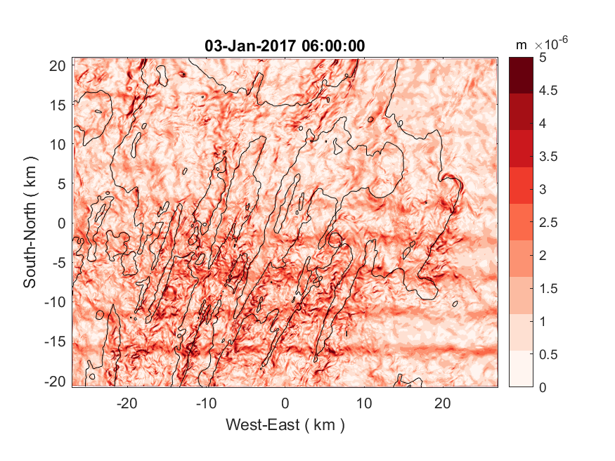

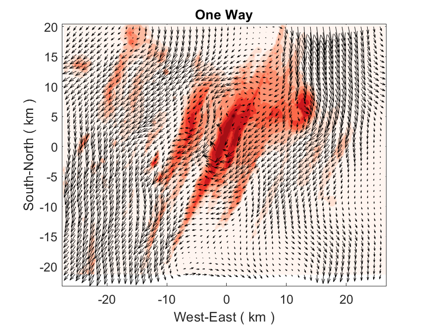

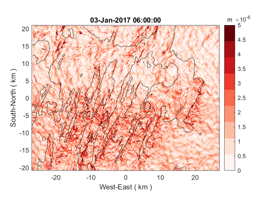

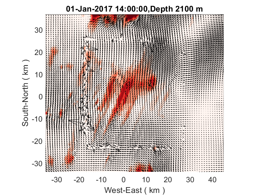

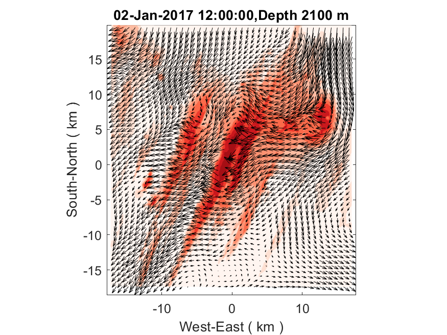

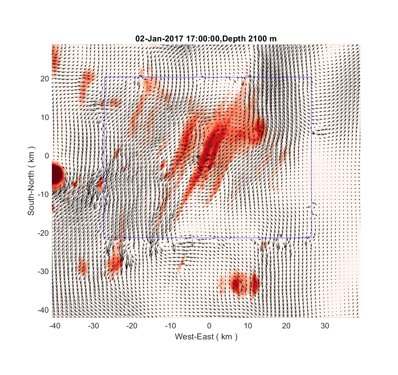

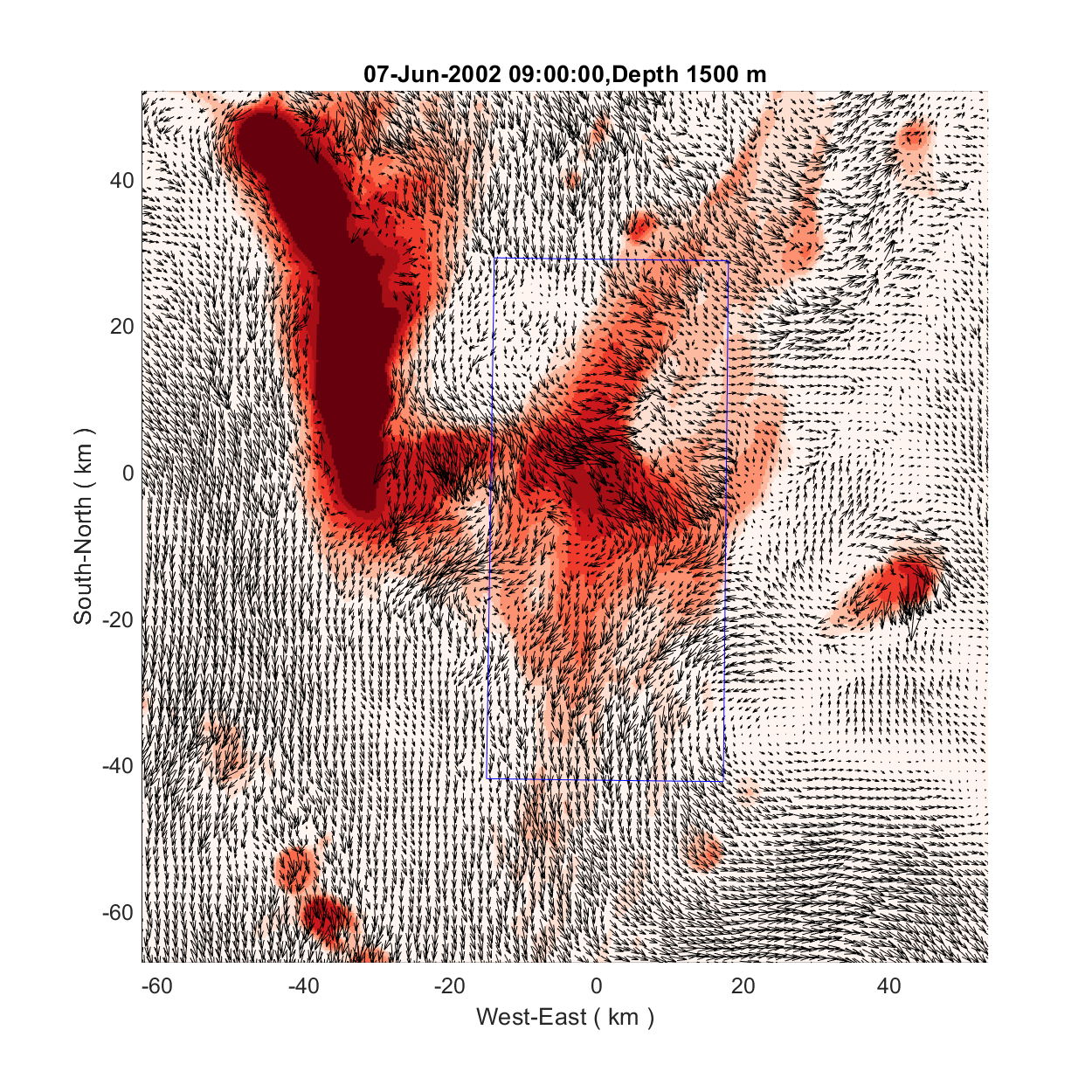

Here is a problem that I have been struggling with for quite a while. I would like to set up two-way nested simulations to study the small-scale dynamics that are influenced by topographic features such as ridges and seamounts. I have done a few experiments so far, but there is one problem that persists in all of them.
I have attached a few plots from a recent experiment that shows the simulated flow field near a ridge segment at 2100 m depth over the refined grid that is embedded in a coarse grid. There is a map that shows the bathymetry with the full domain and the outline of the nested fine grid. The refinement ratio is 5:1. The two plots that show the flow field are from two parallel runs wherein one-way and two-way nesting are used. Comparing the two plots, the results from the two-way run seems problematic as the currents appear to be disrupted at the boundaries whereas the one-way run shows no such disruption. From the answers I got from the forum on my previous post, I suspect the problem lies in the mismatch between the refined and coarse bathymetries. However, in this current experiment, I have relaxed the refined bathymetry to match the coarse bathymetry near the nesting boundaries. Also, if the problem is caused by bathymetry mismatch, it is interesting that two-way nesting is affected to a much greater degree than one-way nesting.
My understanding of the two-way nesting implemented in ROMS is superficial. But intuition makes me think that maybe the problem lies in the feedback of information from the refined grid to the coarse grid, which is the extra step that is unique to two-way nesting. I am interested to know if anyone has had similar problems before or have any suggestions.
Many thanks!
Guangyu
Many thanks!
Guangyu

Thanks for your reply, John. Your point makes sense to me. I initially thought the problem was limited to the bathymetry difference near the nesting interface. But my attempts to relax the fine-grid bathymetry towards the coarse-grid bathymetry at the interface did not make any difference. So the problem likely occurs when interpolating the results across the entire fine grid onto the coarse grid. Indeed, when refinement grids are used, the entire find-grid becomes the contact zone used to feed information back to the coarse grid so that interpolation is done globally. On the other hand, this problem is gone in one of my experiments wherein the coarse bathymetry is used for both grids so that both grids share the same sigma levels globally.
I agree that adding a vertical regridding step may solve the problem. Yet I cringe at the idea of diving into the source code and implement that change myself. Instead of doing that, do you think adding a sponge layer in the coarse grid near the perimeter of the fine grid to absorb those artificial internal waves originating from the interior of the fine grid can serve as a band-aid solution? I am thinking if the sponge layer is narrow enough, it may preferentially absorb small-scale internal waves and still allow the large-scale barotropic tidal waves to pass through without much distortion?
On the upside, I am pleased to report that nesting (both one-way and two-way) appears to be significantly more efficient in the latest revision of the source code compared with the one released in 2019

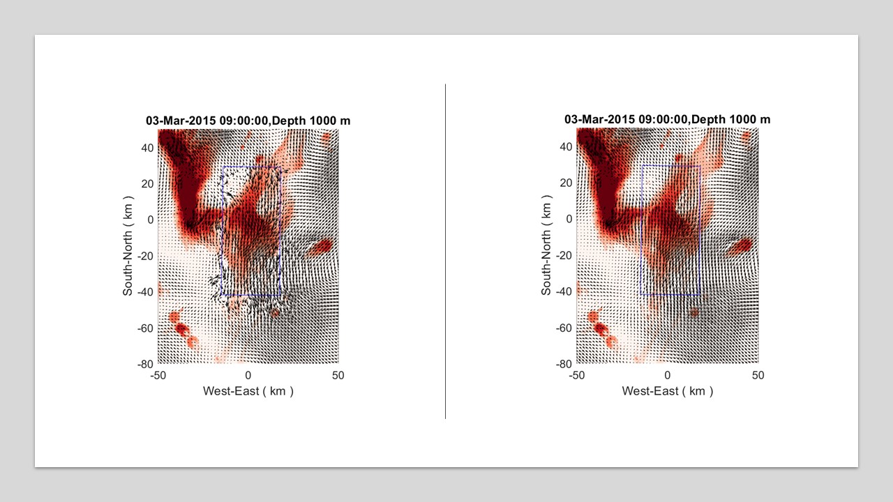

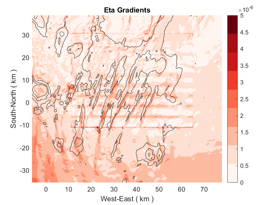

Hi All,

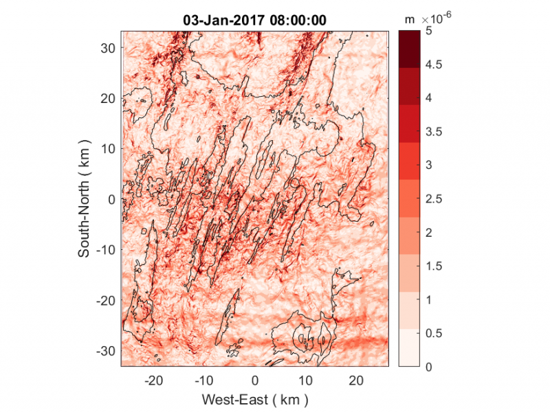

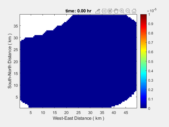

I have done a few more tests since my last post on this issue. The following are some interesting new findings.
First of all, as suggested by Stefan, I did a test wherein the fine and coarse girds share the same bathymetry. Surprisingly, the problem with the nesting interface is still there. I have attached a plot showing the coarse-grid flow velocity where there is apparent discontinuity along the boundaries of the fine grid. The refinement ratio is 3:1 in this experiment. This suggests the current problem is not due to the mismatch in bathymetry within the interior of the fine grid, although I believe the lack of vertical regridding in fine2coarse can still cause trouble.
Second, I have compared the fine and coarse grid bathymetries in the corresponding history files to make sure those bathymetries are indeed consistent. Surprisingly, the bathymetries match up everywhere except for the the outermost layer of grid cells, which are presumably the 'ghost points'. What is more puzzling is that the bathymetry in the fine-grid history file differs from the bathymetry in the fine-grid grid file at those 'ghost points'. So it appears that the fine-grid bathymetry has been modified at the ghost points somewhere inside the nesting code, which leads to the mismatch with the coarse-grid bathymetry.
Based on the findings above, I am now suspecting the problem in my two-way nesting experiment may be caused by the bathymetry mismatch at the ghost points on the fine grid. I am curious to know if this is plausible. If so, could anyone tell me why the fine-grid bathymetry is modified from what is in the grid file at those ghost points?
Thanks!
Thanks!

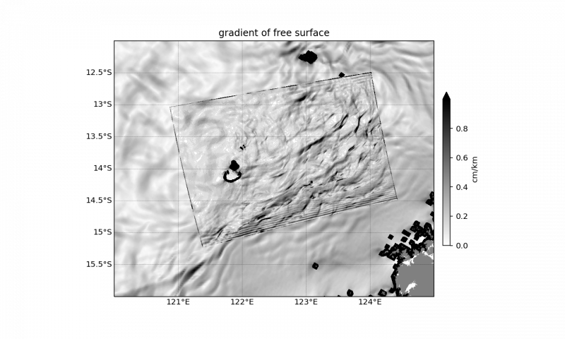

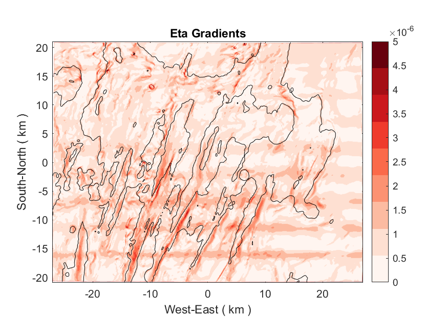

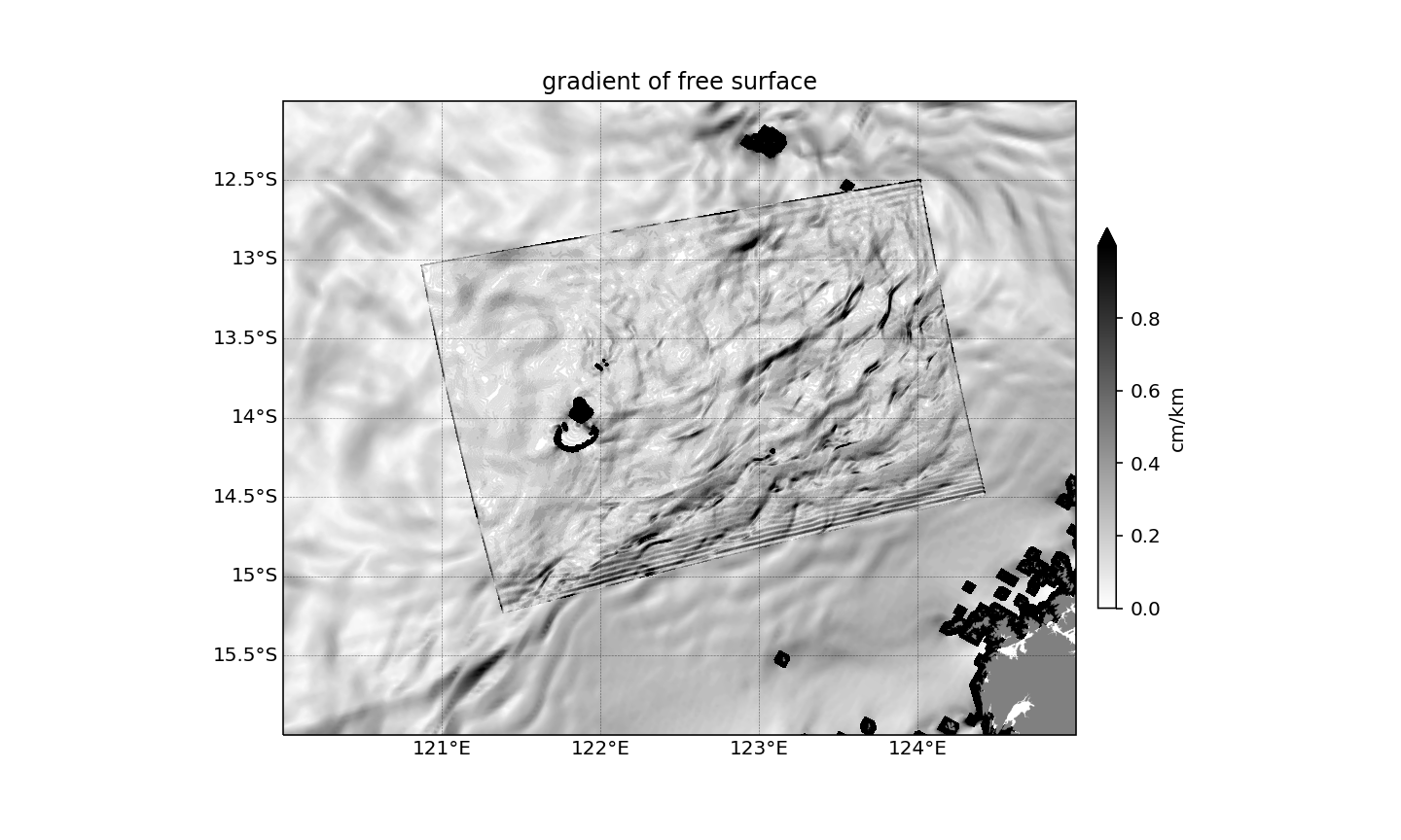

Really good detection of any problems with nesting is to compute free surface gradient, for both parent and child and then plot them together.
I did that for my 2-way case using simple python script, here is snip of the most important part:
My child grid (500m) doesn't match parent bathymetry (2500m) inside its whole domain (it is better-high res in the middle part),

Recently, I saw some strange behaviour at the shallow boundary (southern) using ultimate test of free surface gradient.
I am expecting to have sharper solution for internal tides within nested domain, but think there are some unphysical parallel stripes close to bry.
def roms_fs_grad(zeta, pm, pn):
dphi_y, dphi_x = np.gradient(zeta, axis=0)
return dphi_x*pm, dphi_y*pn
def make_plot_grad_two(rp, pvar,rc, cvar, title, fileout):
fig, ax = make_map(projection = ccrs.PlateCarree())
ax.set_extent(bbox, crs = ccrs.PlateCarree())
ax.add_geometries(shp.geometries(), ccrs.PlateCarree(), facecolor='gray')
cf = ax.contourf(rp.lon_rho, rp.lat_rho, pvar, levels = clevs, cmap = cmap,
transform = ccrs.PlateCarree(), extend = 'max')
c2 = ax.contourf(rc.lon_rho, rc.lat_rho, cvar, levels = clevs, cmap = cmap,
cb = plt.colorbar(cf, orientation = 'vertical', ticks = zrange, extend = 'max',
extendrect = False, shrink=0.6, pad = 0.02, label = 'cm/km')
plt.title(title)
if fileout != None:
plt.savefig(fileout, dpi = 144, transpearent = True)
plt.close()
p = xarray.open_mfdataset('archive_qck_000*.nc', concat_dim='ocean_time')
c = xarray.open_mfdataset('archive_qck_nest_000*.nc', concat_dim='ocean_time')
px,py = roms_fs_grad(p.zeta[160,:,:],p.pm, p.pn)
cx,cy = roms_fs_grad(c.zeta[160,:,:],c.pm, c.pn)
grad_p = np.abs(px + 1j*py)*1e5
grad_c = np.abs(cx + 1j*cy)*1e5
# plot them for time index 160
make_plot_grad_two(p,grad_p[160,:,:],c,grad_c[160,:,:],
'gradient of free surface', 'gradient_zeta_parent_child.png')

Here are my new test results. The first three files shows the flow velocity at 2100 m depth and the last three plots show gradients of sea-surface elevation as suggested by Ivica. I have also attached my grid files and contact file.jcwarner wrote: Fri Feb 26, 2021 12:03 am either way please let us know. would like to figure this one out.
First of all, the velocity appears to have improved after correcting the mismatch of bathymetry in the contact file in a sense that there is now less disruption near the nesting interface. However, the interface still stands out in the plot of coarse-grid velocity, so the propagation from fine to coarse grid is still not perfect. Again, this issue only shows up in two-way nesting. In addition, as suggested by Ivica, I computed the gradients of sea-surface. Surprisingly, the results also show horizontal stripes that look suspicious. Also, those stripes are present in both two-way and one-way results, which are very similar to each other. I am thinking maybe those stripes in sea-surface gradients are waves that bounce back from the nesting interface because they are not resolvable on the coarse grid? I would think the averaging in fine2coarse will smooth out waves on fine scales but probably the smoothing is not 100%.

Re: problem with two-way nesting
I have also encountered a similar problem of the artificial u/v fluctuation at the boundaries between the coarse and refine grids.
In my understanding, the boundary values of ubar/vbar for the refine grid are stored in REFINED(cr)%DU_avg2(1,m,tnew)/REFINED(cr)%DV_avg2(1,m,tnew) through the get_persisted2d subroutine and are set through the routine in the u2dbc_im.F/u2dbc_im.F.
On the refine grid boundary, all the ubar/vbar values of the refine grid cells inside a cell of the coarser grid are set at the same value as the coarser grid ubar/vbar value through the get_persisted2d subroutine.
It means that the same velocity values' blocks (five cells' block in the case of refine_factor = 5) are aligned on the boundary, and the discontinuous velocity exists between the blocks.
I understand that this treatment is for conserving mass-flux through the refine grid boundaries, but it seems that this treatment makes step-like changes in u/v velocity on the boundaries and is sometimes induced small artificial eddies near the discontinuous area of velocity.
To resolve this problem, I modified the Lines 5002-5025 of get_persisted2d subroutine in nesting.F with new CPP flag of REFINE_LINIEAR_DUV_AVE2_BOUNDS as follows:
This edit seems not a smart solution and may induce a new problem related to mass-flux conservation..., but, in my case, but the problem improved after applying the above modification.
I hope this helps.
I have done a couple more tests and found that those artificial stripes in sea-surface gradients only appear when tidal forcing is applied. Those stripes disappeared when I turned off tides. My understanding is that tidal forcing is applied at the open boundary of the coarse grid in a nested simulation with refinement grids. The tides are then introduced into the fine grid through the contact points. I do not know why adding tides in my simulation has led to the artifacts in sea-surface gradients. The following are the CPP options I used. I am hoping someone can let me know if any of those options are inappropriate.
Boundary tides are going to input a lot more barotropic energy than without. I don't think it's directly relevant to the nesting issue you are seeing, just making it more apparent because there is so much more high frequency zeta variability.
Clutching at straws a bit, but ... try without SMAGORINSKY.
And try #define MIX_S_UV instead of #define MIX_GEO_UV
Also, what is your NDTFAST? Are you resolving the split-explicit coupling well.
Hi John and Ivica,
As Ivica suspected
I reduced my coarse-grid time step from 30 sec to 10 sec to match the one used for the fine grid. The refinement ratio between the coarse and fine grids is 3 in my experiment. Surprisingly, those horizontal stripes in sea-surface are gone on the fine grid as shown in the attached plots. The first one is the previous result obtained with coarse grid dt = 30 sec and fine-grid dt=10 sec, the second one is the new result obtained with coarse-grid dt = fine-grid dt=10 sec.
So Ivica, it seems that your suspicion of a time-stepping problem is on point. Could you please explain why using different time steps in refinement nesting could cause problems like this? My understanding is that the nesting in ROMS is designed to have the coarse and fine grids run at different time steps that match the grids' respective resolutions.
John, to answer your question, the 'NDTFAST' in my simulation is 30, which should satisfy the CFL criterion based on my computation. The deepest spot in my full domain is at h = 2800 m depth. So the phase speed of barotropic waves is sqrt(g*h) = 166 m/s. The grid spacing on my fine grid is 80 m. So the maximum dT in the barotropic mode is dt = 80 m /166 m/s = 0.5 sec. The actual barotropic dt used for the fine grid is 10 sec/30 = 0.33 sec. So the CFL is about 0.66. Maybe that is this still too high?
As Ivica suspected
,jivica wrote: Tue Mar 02, 2021 8:38 am My feeling is we have problem with grids time stepping mismatch and to eliminate this I will run both grids with the same time stepping

There is approximately 5km between the stripes and the barotropic wave speed is 166m/s, so there is a period of 30s, which is in sync with the baroclinic time step? So assuming the signal is generated at the nesting boundary and propagating into the fine domain, maybe check the effect of the cpp option TIME_INTERP_FLUX. You mentioned in a previous post that waves "bounce back from the nesting interface". Is that really how they propagate? I
I just took another look at my old results and it turned out that the horizontal stripes in eta gradients were also present. I missed that because I did not think to check sea-surface gradients back then.
That said, I also reread Arango's post on setting up nesting grids: viewtopic.php?t=3663. One thing I have missed before is that it is preferable to build nested grids using the fine-to-coarse strategy, which involves building a large, fine intermediate grid first and extract from it the final coarse and refined grids to use. I have been doing it the opposite way, which is to build a large, coarse grid and then extract from it the fine grid using coarse2fine.m. The reason given by Arango for taking the first approach is that
Anyways, I am now back to the drawing board and will rebuild my grids using the fine-to-coarse strategy and restart from there.

Hi Hernan, I went ahead to rebuild my nested grids following your fine-to-coarse approach. However, I did not go very far before running into further issues, so some more help will be appreciated.arango wrote: Fri Mar 12, 2021 8:57 pm

Hi Hernan and all,arango wrote: Wed Mar 17, 2021 9:13 pm Yes, I recall issues with the global attributes. In such cases, I manipulate the global attributes using my matlab/netcdf functions that are distributed in the ROMS Matlab repository:Since it is important information to have, I read old attribute values, create a new global attribute with such values, and delete the problematic attributes. It is very simple. Users of ROMS need to learn how to create and modify the NetCDF files. We provide lots of generic Matlab functions to do so. If the user is allergic to Matlab, they can use other software that is available elsewhere.Code: Select all
>> Imin=nc_getatt('my_file.nc', 'parent_Imin'); >> Imax=nc_getatt('my_file.nc', 'parent_Imax'); >> Jmin=nc_getatt('my_file.nc', 'parent_Jmin'); >> Jmax=nc_getatt('my_file.nc', 'parent_Jmax'); >> refine_factor=nc_getatt('my_file.nc', 'refine_factor'); >> nc_attadd('my_file.nc', 'parent_extraction', int32([Imin Imax Jmin Jmax refine_factor])); >> nc_attdel('my_file.nc', 'refine_factor') >> nc_attdel('my_file.nc', 'parent_Imin'); >> nc_attdel('my_file.nc', 'parent_Imax'); >> nc_attdel('my_file.nc', 'parent_Jmin'); >> nc_attdel('my_file.nc', 'parent_Jmax');
Thanks a lot for all the instructions. I managed to rebuild my grids using the fine-to-coarse approach and finished a test run using one-way nesting. The refinement ratio between the coarse and fine grids is 3. I have attached an animation showing hourly sampled sea-surface gradients over a 2-day span since the start of the simulation. Unfortunately, those much dreaded horizontal strips are still there despite the change in the domain size of the fine grid and switching to the fine-to-coarse approach. Note that those stripes seem to come and go like a surface wave originating from the southern nesting interface. As Stefan pointed out previously, the wavelength suggests a period of 30 sec, which is the coarse-grid time step. So it seems that a perturbation in sea surface is introduced at the southern interface each time the fine grid reads outputs from the coarse grid. I do not know if this is a time stepping issue as suspected by Ivica but my previous test seemed to suggest those stripes are gone after using the same time step for both fine and coarse grid.
Having said that, I still suspect there is something wrong in my grids and the ngc file created using 'contact.m'. Hernan, in order to make the grids extracted from the intermediate grid work for contact.m, I manipulated the global attributes in the coarse and fine grids as follows. I added the attribute 'refine_factor=0' to the coarse grid file and change the value of that attribute from '1' to '3' in the fine grid file to match the refinement ratio between those grids. The reason for those changes is that 'contact.m' seems to determine whether the grids are nested in the refinement configuration based on the value of 'refine_factor'. As mentioned in the instructions in the Matlab code, 'refine_factor' needs to be 0 for the coarse grid. I have attached my grid files and ngc file. I would much appreciate if you can take a look and see if there is something wrong. I am hoping a fresh pair of eyes can spot some error that has long eluded me.
- eta_grad.gif (4.16 MiB) Viewed 380710 times

Hi Stef and Ivica,stef wrote: Mon Mar 22, 2021 9:40 am But if there is a problem with the grid topology, how come the experiment with the same timestepping does run fine. Hmm, it's surprising, isn't it?
After scrutinizing the results from the simulation conducted with the same dt between the coarse and fine grids, I now think those stripes are present in both cases. I have attached two snapshots of sea-surface gradients from two parallel runs respectively. It appears that those stripes are also present when the coarse-grid dt is reduced to match the fine-grid dt. The difference is that those stripes are now more closely spaced because the coarse-grid outputs are fed into the fine-grid at shorter time intervals (10 sec vs 30 sec before). So I still suspect the problem is due to the some hidden error in my contact file.
Ivia, I am curious to know whether you have solved the problem of artificial stripes near the nesting interface in your case. Do you think your problem and mine share any similarities?

Hi All,
I have done a few more tests over the past couple of weeks. In these new tests, I have removed bottom topography, open boundary, and surface forcing so that the simulations are forced with tides alone. Although this did not solve the problem of those artificial stripes in sea-surface gradients, the much simplified settings did make those artifacts stand out more clearly. It is evident that those stripes originate from the nesting interface and propagate from there into the small domain. What is more surprising is that those artifacts also appear near the open boundaries of the coarse grid. This makes me wonder if those artifacts are a general problem with open boundary conditions rather than an exclusive problem with nesting.
I also did a sanity test on the Lake Jersey test case using the original input files I downloaded from the 'test case' repository. I have attached two animations showing sea-surface elevation and its gradients over the mother grid (i.e., grid a). There is only one nested grid (grid c) in this experiment. The refinement ratio is 5:1. Surprisingly, artificial stripes in sea-surface gradients showed up again both within the daughter grid and near the open boundary of the mother grid. This finding seems to suggest the problem is likely not caused by some error in the input files I created myself. Also, since the Lake Jersey test case only has wind forcing, those artifacts are not exclusively related to tides either.
I am keen to hear your thoughts on this.
Guangyu
Guangyu

Hi All,
Here are some more test results from a realistic experiment. The model grids include a coarse grid and a fine grid embedded within that is centered at the Axial Seamount in the Northeast Pacific. The top of the seamount is at 1500 m depth. The grids were built using the fine-to-coarse approach recommended by Hernan with a refinement ratio of 5:1. I have done two experiments using one-way and two-way nesting respectively. The model flows are driven by tidal, and sub-tidal forcing at the coarse-grid lateral boundaries plus surface wind/pressure. The same settings were used for both experiments except for the nesting scheme (one-way vs two-way). Special care was taken to make sure the bathymetry between the two grids matches so that the grids share the same sigma levels.
The plots below show 2D velocities and the 3D velocities sampled at 1000 m depth. The two-way results are on the left and the one-way results are on the right. For those one-way results, I averaged the fine-grid solutions based on the 5:1 refinement ratio and used the averages to replace the coarse-grid solutions at collocated grid points. It is noticeable that the two-way results show apparent discontinuities near the nesting interface. The disruption in flow mostly occurs at the locations where the bathymetry changes significantly across the nesting interface. In comparison, the one-way results are much smoother, in which the nesting interface appears almost transparent, which is a sign that the interface is behaving properly. Such differences between one-way and two-way experiments are persistent in all the tests I have done that feature realistic bathymetry as shown in my previous posts.
I know that the two-way nesting differs from its one-way counterpart mainly by having an additional fine2coarse step, in which the fine-grid solutions are averaged and substituted for the coarse-grid solutions at collocated grid points. It seems to me that the averaging currently done in the fine2coarse subroutine could become problematic when the bathymetry changes significantly over the five fine-grid cells that occupies a same coarse-grid cell. In that case, the simple averaging done in fine2coarse for 2D variables, which does not take into account changes in bottom depth, may not yield results that match the coarse-grid solutions. This will result in discontinuities in mass fluxes across the nesting interface when the fine grid 2D variables are passed to the coarse grid.
If my supposition above is correct, I am wondering if that is the reason why it is recommended to place the nesting interface where the bathymetry is smooth. I am also wondering if one can modify the averaging done in fine2coarse to make it more robust in the presence of significant bathymetry across the fine-grid cells that are averaged over. Any thoughts?

Hi All, sorry for taking so long to write back.
To answer Stef first, I read your old post and see how that could be problematic. But I do not think that is the cause because that issue seems to affect the input of information from coarse to fine grid and thus the artifacts seen in my results would be present in both one-way and two-way nesting. Please let me know if you agree.
Arango, I am very surprised to hear that you could run such simulations on your laptop with only 8 CPUs. The grid size of the coarse grid is 1000 by 1000 at 250 m intervals with 64 sigma layers. The time step size is 30 sec. A 30-day single-grid simulation takes me about a day to finish using 72 CPUs. Increasing the resolution 5 fold will need a grid size of 5000 by 5000 and time steps 5 times smaller, which will take much longer to finish and too much storage space on the computer I am using. Maybe there is some weird setup issue that slows down the simulation at my end substantially?
Wilkin, I read the paper you recommended and saw that the 'fine2coarse' step, which is called 'update' by those authors, is quite different from what is implemented in the current version of ROMS. There are two major differences that I noticed. First, the update of coarse-grid solution only occurs in a 'feedback' interface on the coarse that lies near the boundary the fine-grid rather than the entire interior of the fine grid. Second, as shown in their Figure 7, taking the average of fine-grid solutions does not properly damp the small-scale features that are unresolved on the coarse-grid. The procedures described in that paper also includes 'flux correction' as mentioned by Hernan. I presume the nesting scheme described in that paper is used in the other implementation of ROMS that is called CROCO. I have downloaded that model and will play with it when I have more fee time.
Lastly, my temporary solution is to stick to one-way nesting to generate results for my project. But I am keen on continuing this dialogue with you guys. I think the online nesting (both one-way and two-way) capability of ROMS is a powerful feature that seems to be underused since the feature was added several years ago. It would be great if someone who is more experienced with nested simulations can write a general post summarizing the pros and cons of the different nesting schemes (online vs offline, one-way vs two-way) available.
