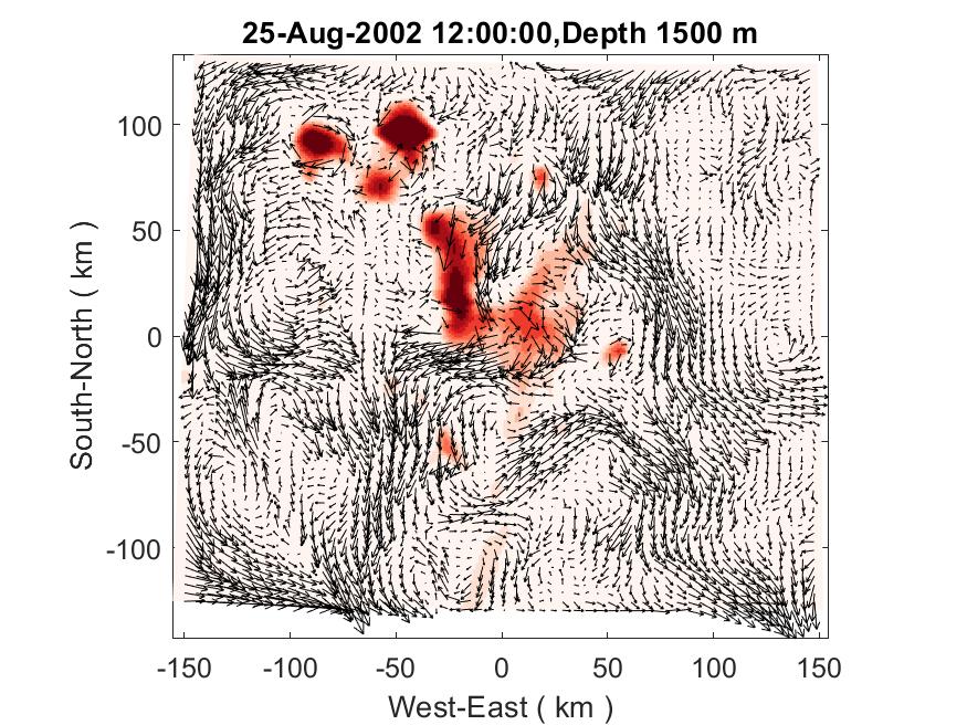

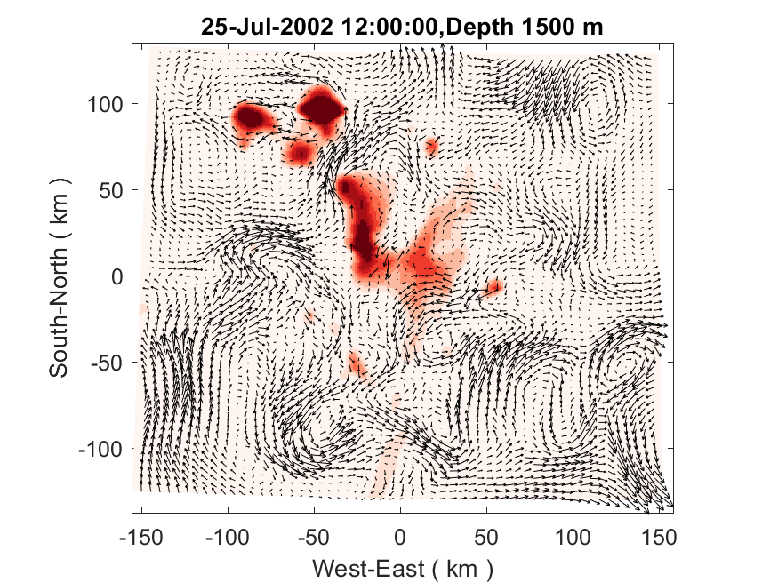

I have a few general questions about adding tidal forcing in a realistic simulation. The attached diagrams show the flow velocities at 1500 m depth near Axial Seamount in the Northeast Pacific from two simulations: one without tidal forcing and one with it. The open boundary conditions used are Chapman for free surface, Shc for 2D momentum, and RadNud for 3D variables (e.g., u, v, T, and S). As you can see, the model flow field looks okay without tidal forcing. However, after adding tides, strong artificial ‘rim currents’ appear along the lateral boundaries. I have attached the header and dot in files used for the with-tide simulation.
First, I would like to know the appropriate open boundary conditions for 3D velocities when there is tidal forcing. My understanding is, with the add_fsobc and add_m2obc cpp options, tidal elevation and currents are added to the sea-surface and 2D velocities in the open boundary conditions. This seems to suggest similar adjustment needs to be made to 3D velocities to make them consistent with the 2D velocities. If so, I suppose I need to manually add tidal currents to the 3D u and v in my open boundary file. Is this right?
Second, my domain includes a sponge layer to absorb the waves originating from the interior. I am wondering if this is no longer advisable when there is tidal forcing since the presence of a sponge layer may distort the phase and amplitude of the tides.
Lastly, my cpp options also include the ones for conserving volume at all four boundaries (e.g., EAST_VOLCONS). I am wondering if I should turn them off when there is tidal forcing.

Many thanks to your replies, Miguel and John. I did a little bit more fiddling and found that the a lot of the rim currents were caused by forcing volume conservation at the four boundaries as John pointed out. I now see that conserving volume no longer makes sense for a regional simulation when there is tidal forcing. I have attached the flow field from a simulation where the volume conservation flags are turned off in the dot-in file (Miguel, you are right that the CPP options are obsolete). As you can see, there are still hints of the rim currents but the overall flow field has improved significantly.

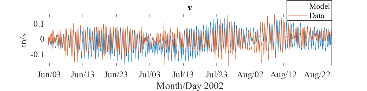

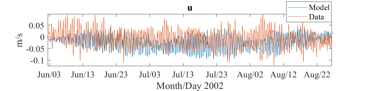

Regardless of the potential inconsistency, the model velocities look reasonable to me. The attached diagrams show the comparison between the simulated and measured velocities at roughly 500 m above the seamount in the middle of my domain. As you can see, the match between the model and observation is reasonable. Furthermore, the phases of tidal oscillations also appear to be approximately consistent, which is encouraging.

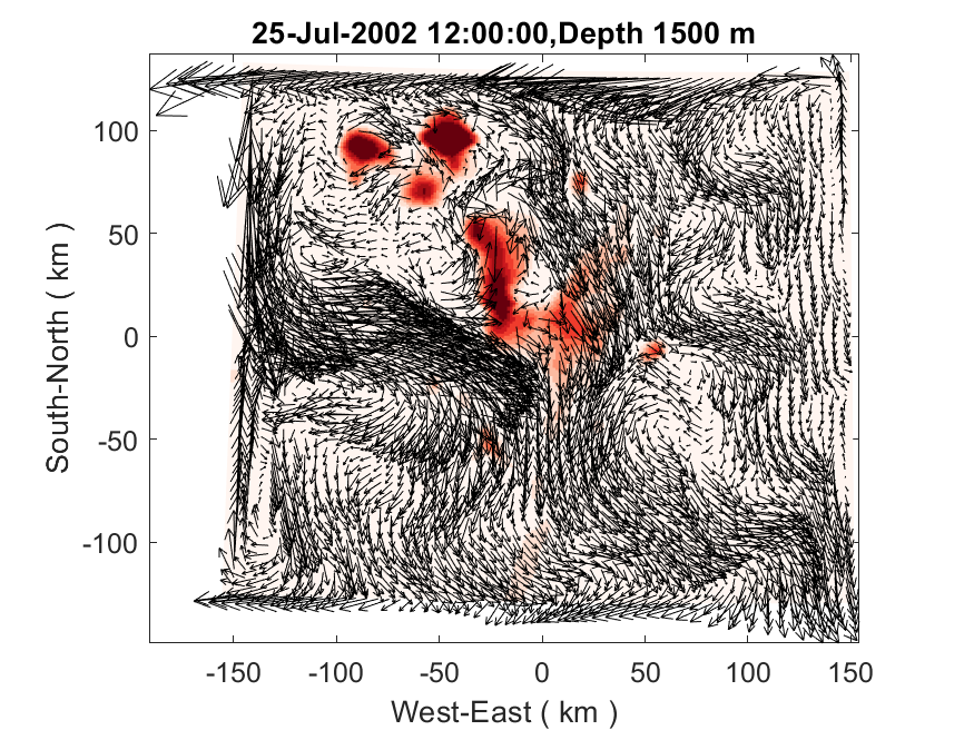

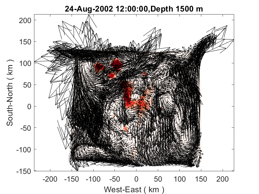

I did the test John suggested. It turns out that changing the boundary conditions for 3D variables from 'RadNud' to 'Rad' has backfired in a big way. As shown in the attached diagram. The simulated flow field is completely overwhelmed by the rim currents. This sharp contrast with the previous results seems to suggest that it is important to nudge the inflow to match the boundary conditions and radiation alone is not enough. I intend to do another test in which I will add tides to 3D velocities in the boundary conditions and see if the results improve because of that.
