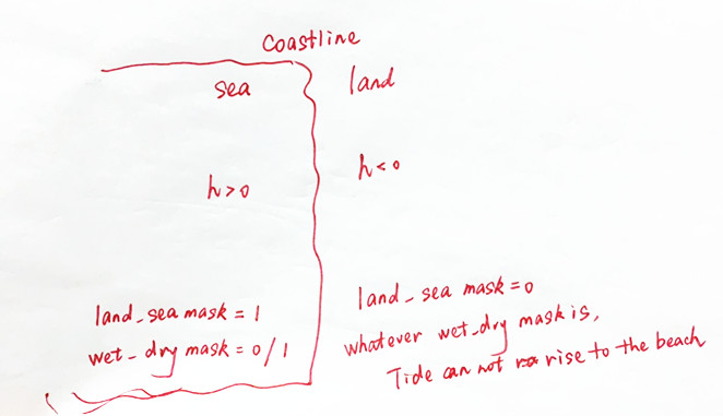

Hi there,
I met a problem with WET_DRY option.
When I use WET_DRY to run a simple coastal ocean case, ROMS blows up quickly (19 steps, 1.9s). I set DCRIT=0.1m.
Notice: I use Gridbuilder and set h of land area as negative value(though people usually set all h>0), for example,-15m. And rx0 and rx1 is very fine.
Methods I have tried to fix it:
(1)When I set all h > 0 and turn off WET_DRY, the model runs successfully. But I still want to use WET_DRY.
(2)Changing dt and Ndfast only delays the time of blow-up, for example,1.9s to 45s.
(3)Decreasing rx0 and rx1 does not work.
(4)I checked the value of u,v and w in the whole area before blow-up, it seems good, and no large value appeared.
I consider some other possible reasons:
(1) I import myself bathymetry into Gridbuilder but still use Gridbuilder's GSHHG coastline, maybe the value of h does not match mask (for exmample h<0 but mask=1, but dry place cannot make calculation) ? --------So if I import myself bathymetry, should I also input corresponding coastline (I don't have coastline data, I can only use matlab to generate it according to my bath data)
_
(2) The zeta of land area changed with time, which is weird.
_
Here is result.out, thanks!

- zhangtianhao
- Posts: 50
- Joined: Fri May 11, 2018 5:36 pm
- Location: Beijing Normal University
Re: WET_DRY and Gridbuilder Problem
What I do these 2 days:
(1)My COAWST version does not need to define limit_bstress.
(2)I found that many people's model blowed up because of large T,S and velocities. So I checked T and S, they seemed also fine before blowing up, the same as uvw.
(3)My model blowed up with kinetic_enrg, poten_enrg and total_enrg suddenly becoming NaN. I don't understand why velocities are small but energy is large.
(4)I activated WET_DRY and my hmin was ~-100. I turn hmin to -15, result did not change. But when I turn it to -5, it can run without blowing up.
So I kept to turn it to 0, it can also run.(I use gridbuilder to generate grid)
Noticed that rx0 and rx1 are always small(I use gridbuilder to check them).
I can't explain this phenomenen.
Hoty
2020-01-14
-changing hmin to zero is basically removing all the 'land' parts of your grid, so that removed your wet dry problem.
- an hmin of -100 means that you have a small hill about 100 m above sea level. that might be troubles for roms. so maybe you could set landmask=0 for cells that are above, lets say, -10 m elevation.
so landmask (h<-10) = 0;
- for wet_dry, zeta is draped over the bathy.
- what value of Dcrit did you use? this grid seems rather course for wetdry, but it should work.
- use ncview or similar to step through the netcdf output file. where is the model blowing up?

- zhangtianhao
- Posts: 50
Thanks for your reply,jcwarner wrote: Tue Jan 14, 2020 2:50 pm -changing hmin to zero is basically removing all the 'land' parts of your grid, so that removed your wet dry problem.

Thanks for suggestions from Kate, johnluick and jcwarner, that's really useful.
Firstly, I read this papaer https://darchive.mblwhoilibrary.org/bit ... sequence=1. I found I misunderstood some parameters.
I confused land/sea mask with wer/dry mask.
Now I have a question. In previous case, I set landmask(h<0)=0 using Gridbuilder. I consider it's a mistake, according to jcwarner's suggestion( set landmask(h>-10)=1 )and I shoud set intertidal place which -10<h<0 as landmask=1.
But I found when using Gridbuilder, I can't set sea mask on land, when I change the mask, the depth changes to adapt it.
For example, I set sea mask on land(-10<h<0), but depth of these cells changed from negative to positive values automatically.
The consequence is
h<0~~~~ landmask=0
or
h>0~~~~ landmask=1
So I generate a normal grid by gridbuilder firstly, and then use matlab to modify the mask ( mask_rho(h>-10)=0) , but after modifying mask, I found rx1 became very large. And model blowed up...
Thanks again and hope anyone can help me out

I am so sorry that I didn't make myself clear
I use topograpy in the land area(h<0). But if the land/sea mask of land area equals 0, the tide will never rise into the beach (or the land). So I want to change the beach mask from 0 to 1. So the key point is that I want to set mask of a h<0 cell (beach cell) euqals 1.
So your mean :
I should set depth of beach area even land area >0 (for example, add 10 meters to all cells) and set initial zeta(1:xi_rho,1:eta_rho) =-10m in initial.nc file, then sea level=-10m and the depth of land area is positive. So Gridbuilder and ROMS can deal with it?
Hoty
- picutre.jpg (39.67 KiB) Viewed 35297 times
