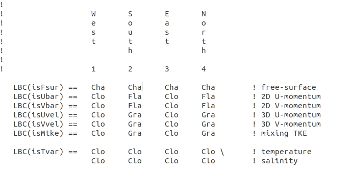

Attached is my bry condition
- bry.png (30.67 KiB) Viewed 13936 times
Re: Index '282' of dimension 2 of array 'finp' above upper bound of 281
The Flather condition requires values from outside the domain for both ubar/vbar and zeta. You can provide them via ANA_xxx options or you can specify a file:
NBCFILES == 1 ! number of boundary files
BRYNAME == /center1/AKWATERS/kshedstrom/Arctic/Files/Arctic4_bdry_1980_SODA3.3.1.nc |
/center1/AKWATERS/kshedstrom/Arctic/Files/Arctic4_bdry_1981_SODA3.3.1.nc |
/center1/AKWATERS/kshedstrom/Arctic/Files/Arctic4_bdry_1982_SODA3.3.1.nc

Now I can run this case but it blows up after several steps.
And it's weird that: usually results become large and model blows up, but this time results suddenly become NaN.
So I checked my forcing file, but there are no NaN in it.
One thing I noticed:
I turn on WET_DRY, and I set depth of land area < 0.
I find that before model blows up, zeta in land area changed bigger(changed up tp 20m). (Why land-mask has zeta value??)
I wonder if this matters? (!!!!I CHECKED U V W BEFORE BLOW-UP, they are fine! all=zero )
Thanks!!

zeta 1 Chapman Imp Chapman Imp Chapman Imp Chapman Imp
ubar 1 Closed Flather Closed Flather
vbar 1 Closed Flather Closed Flather
u 1 Closed Gradient Closed Gradient
v 1 Closed Gradient Closed Gradient
temp 1 Closed Closed Closed Closed
salt 1 Closed Closed Closed Closed
tke 1 Closed Gradient Closed Gradient
PALU palu
