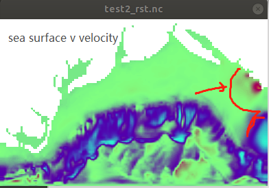

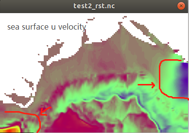

I'm trying to run ROMs by bulk forcing,and initial condition, but it blows up.
Because my area is near the coast and my blow-up point is in the shallow water area(~10m), I try to decrease my dt from 300s to 10s and decrease my N from 36 to 25.
It does work but it just delay the time of blow-up, not solve the problem.
So I think maybe there are some problems in my grid.file, and I generate my grid.nc by Gridbuilder, here is my result.out and grid.nc:
Thanks!!

Thank for your reply, Kate and Wilkin! I have modified my model, but there are still some problems
The blow-point is near the boudary, and if I change the boudary condition, it appears in the shallow water area, as shown in the picture below:
1)As for the boundary condition, because I don't have the boundary data and I just want to run a little case, I set GRA on all but zeta. Now I have change it into
Gra Clo Gra Clo, but it is still a little strange in my left-down corner, as shown in the picture below, which I think results from the boundary conditon;
