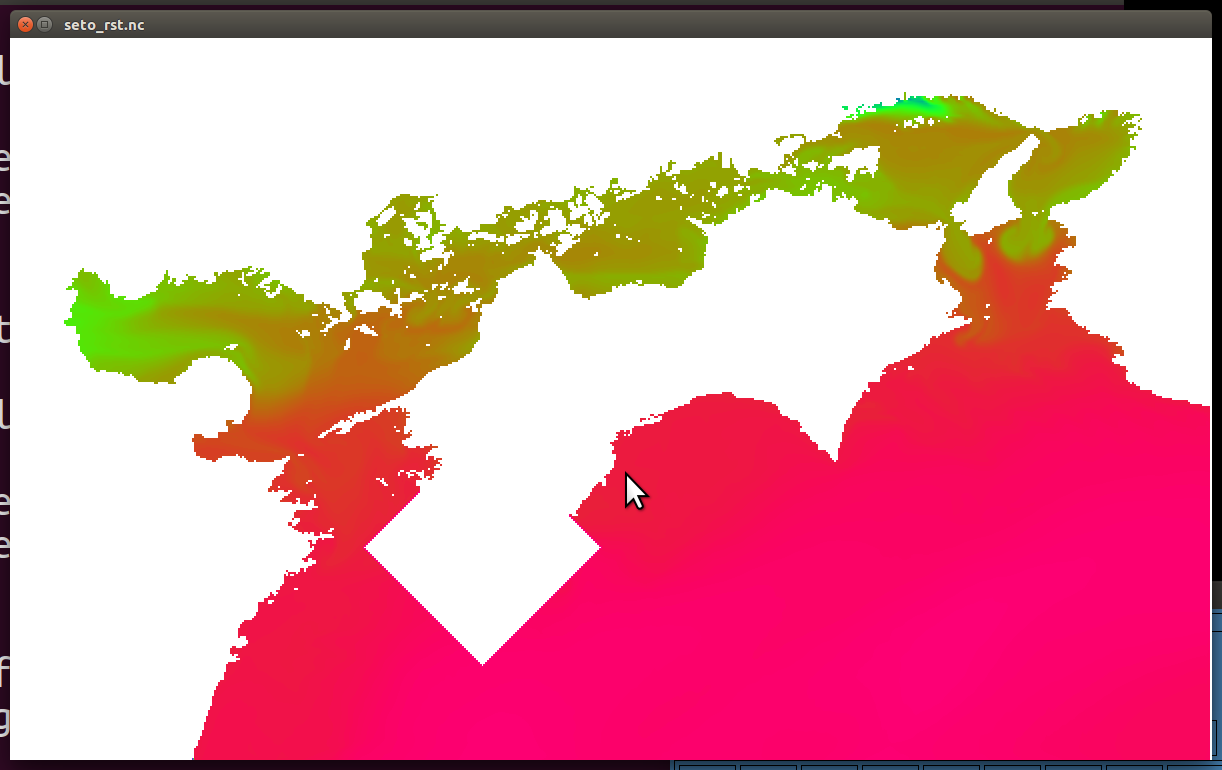

Attached figure file:
SST at the latest model state: "sst_Latest.png"
After driving in 5137 time step run (14 hours 16 minutes 10 second),
the model blow up. Checking all 2d-vars (ubar, vbar, zeta) and all
layers of 3d-vars (temp., sal., u, v, rho) at the latest model state,
obviously missing values are found in diamond shape (e.g., see
"sst_Latest.png" in case of SST).
Using Ncview (http://meteora.ucsd.edu/~pierce/ncview_home_page.html),
these missing values are 9.96921e+36, while the value at land-masked
points are 1e+37.
Would you please give me any advice to fix this 'blow up' trouble?
Thank you very much in advance.

Re: Model Blow Up After 5137 Time Step Run
Those 1.e36 values are NaN. I'm sure you'd find that the first one happened in the middle of that diamond and they are spreading from there quite rapidly. If you ask ROMS for NINFO=1, it will check for NaN or other weird values every timestep and stop before you have that many NaN values. Still, it is now up to you to find out what caused it - do you have shallow water there? Do you have wetting and drying? Did you try again with a shorter timestep?
Is there some reason you're using such an old code?
