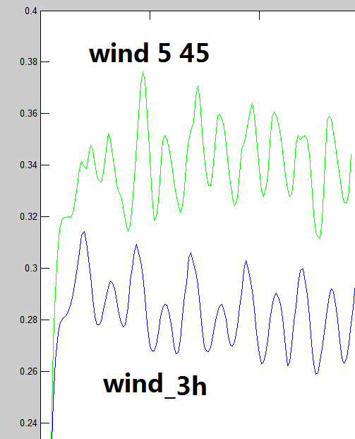

I couple roms with swan, I use
MODE NONSTATIONARY TWODIMENSIONAL
SET DEPMIN 0.05 INRHOG 1 NAUTICAL
COORDINATES  SPHERICAL
CGRID CURVILINEAR 200 200 EXC 9.999000e+003 &
        CIRCLE 36 0.02 1.2 60
READGRID COORDINATES 1 '/home/data/grid_coord.grd' 4 0 0 FREE
INPGRID WIND CURVILINEAR 0 0 200 200 EXC 9.999000e+003 &
NONSTATIONARY 20170101.000000 3 HR 20170130.000000
READINP WIND 1 '/home/data/wind_3h.dat' 4 0 FREE
or
WIND 5 45
the wind_3h.dat is the wind(5m/s 45°) at x and y component (xi and eta component) every 3 hours.
however, the result show the wave height of 'WIND 5 45' is bigger/higher than the 'wind_3h.dat '.
Why the same wind but the wave height is different?

#2 Unread post by lfparejar »
I would double check that the direction in wind_3h.dat is in the same coordinate system as when you prescribe WIND 5 45
