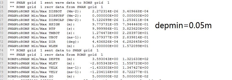

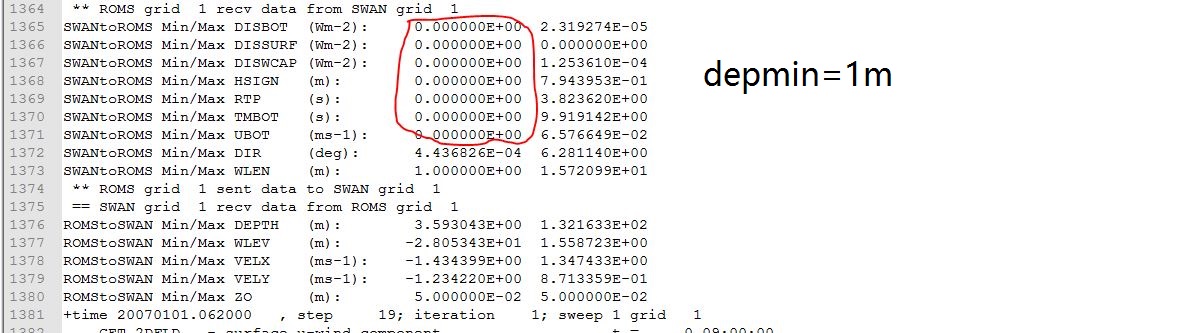

3) I change depmin=0.05 to depmin=1 (same as DCRIT )in my swan.in, to exclude dry points during wave computations. why some parameters of SWAN turn into zero during the data exchange.
Posts: 1220
Re: Blowing-up when using COAWST to couple ROMS and SWAN
#5 Unread post by jcwarner »
the water levels go from roms to swan, so wet dry will affect swan.
when you increase the min depth for swan to 1 m, then there will be locations that will turn dry and this will change the wave dynamics in the very shallow parts. suggest you do 2 runs with the different depths, and then pcolor some of the fields to see where the differences are. this might make it m ore obvious.
