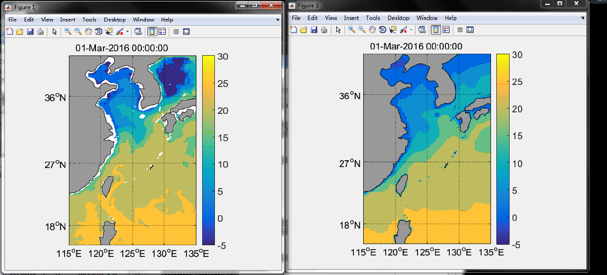

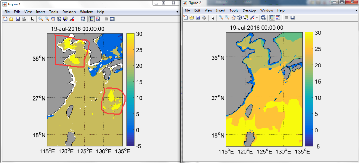

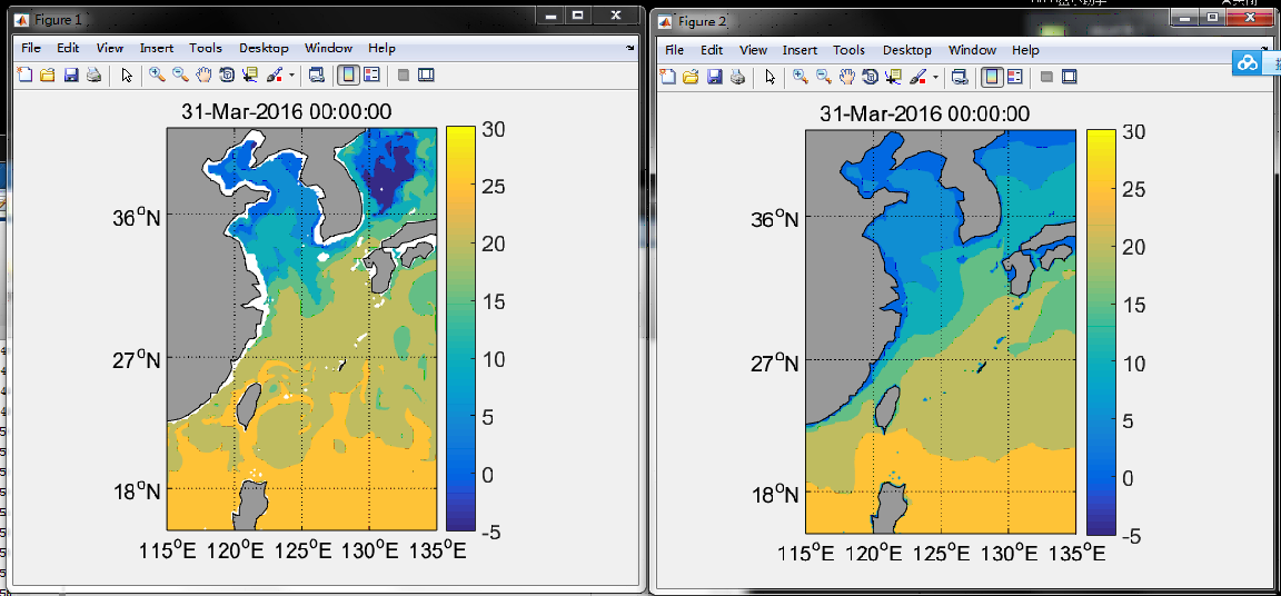

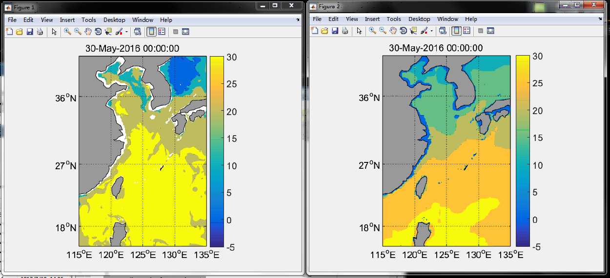

my roms model is running from 2016.01.01-2016.12.31, the frc data get from ECMWF in 3h step, the bry data get from HYCOM
data in 1day step, but when the model running 201 days it is blow up, i check the temperature,and find that the pattern of
temperature becomes more and more wrong , and the temperature are greater than 40℃ (Red circle area)in some point after 150 days,(The left figure is the model temperature)
I really don't know how to find this problem, i am sure that my data of grid bry and frc are no problem, are my *.h , boundary conditions wrong?
Can you give me some advice?
