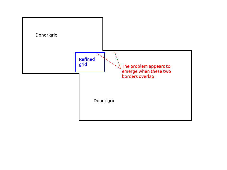

Hi, I was wondering if anybody came across this before. In my nested application, it seems like the code is assigning the coarse grid as 00 instead of 01. Also the timestep ratio is zero instead of 3.
 Refined Nested Grid(s) Information:
 Refined    Donor   Refined   Timestep   Refined
  Grid      Grid    Scale      Ratio   Timesteps
    02        00       03      0.00000      03
 WARNING: Usually the number of Refined Timesteps must be the same
          as the Refined Scale for numerical stability.
The run exits after the first couple of steps with
#3 0x48BE02 in __nesting_mod_MOD_nesting
#4 0x45CAE8 in main3d_
#5 0x4035D4 in MAIN__ at master.f90:?
mpiexec noticed that process rank 2 with PID 4067 on node stamlab-500-165ev exited on signal 11 (Segmentation fault).
and the output of the debugger is
  At line 706 of file metrics.f90
Fortran runtime error: Index '0' of dimension 1 of array 'dt' below lower bound of 1
I'm using coarse2fine-contact to make the fine grid.
Any hints?

Moreover, when I run the exact same model set up with a refinement factor of 7 for the fine grid, the model runs.
The problem is that I get this error when I try it with ref. factor 3 or 5.

I managed to solve this by changing slightly the borders of the refined grid, in coarse2fine.
It seems that the complex geometry of the Donor grid interferes with the refined, as I illustrate in the graph.
