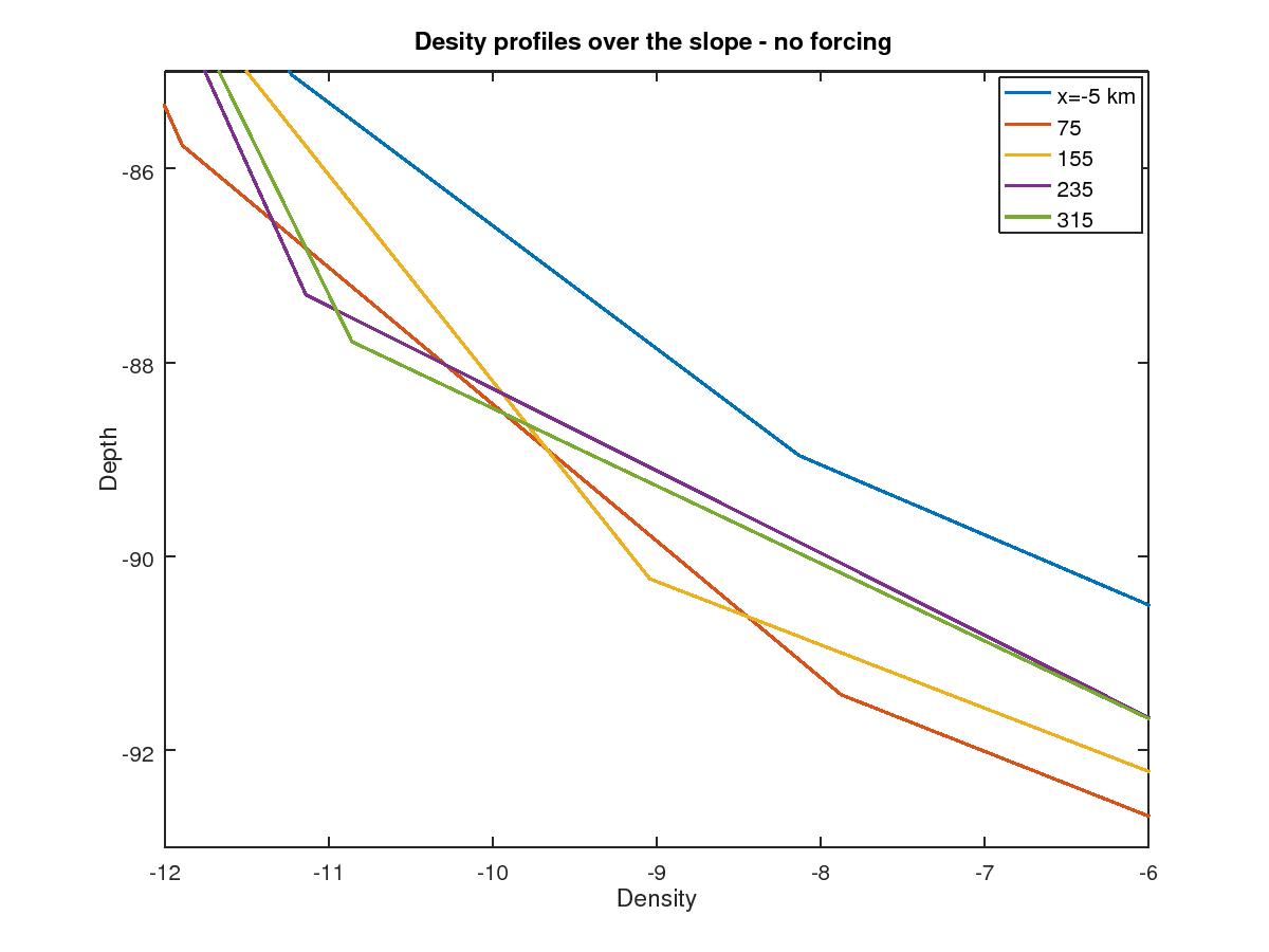

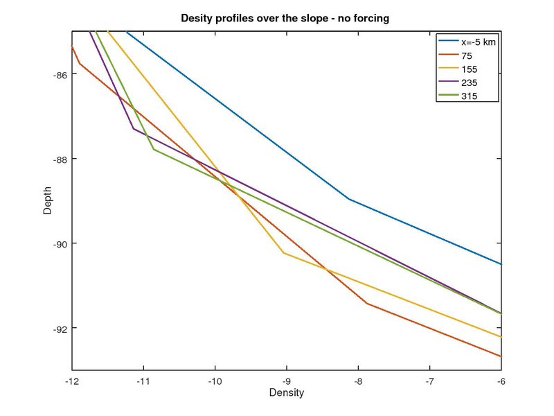

The case starts from an initial condition where rho varies in the
vertical as (-tanh alpha(z+hbar)) where hbar is the thermocline depth,
and alpha is a moderate slope. I can take the rho values given in
the output at the initial time, and use set_depth.m and stretching.m
to compute the depth corresponding to each vertical bin (there are
40). A blow up of the resulting profiles at 5 points is in the
attached figure. Each line corresponds to a different value of x_rho,
ranging from the edge of the basin (blue) to twice the shelf depth
(green).

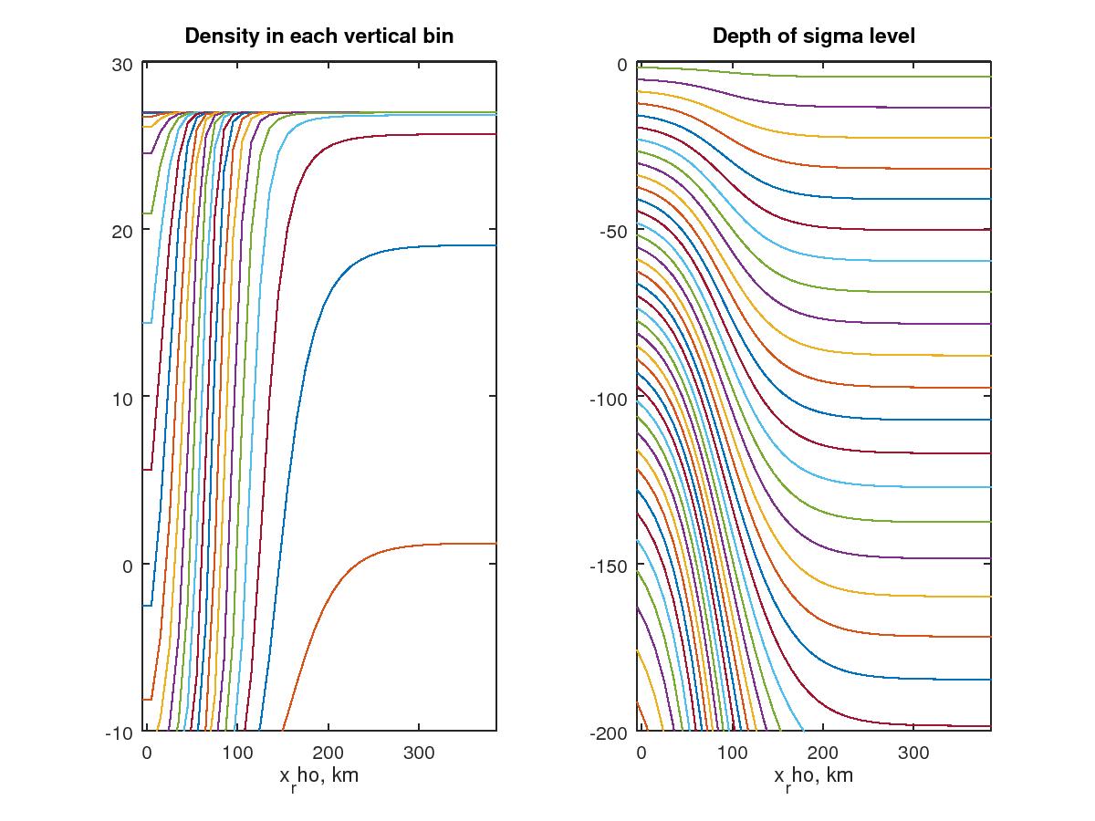

Even though the density profile should be exactly the same at all
points, the sigma-coordinates result in uneven sampling depths, and as
a consequence, the density profiles cross each other. The surface
corresponding to a density of say, -5 is highly contorted. The density corresponding to each bin and the bin depth are illustrated in the second plot.
