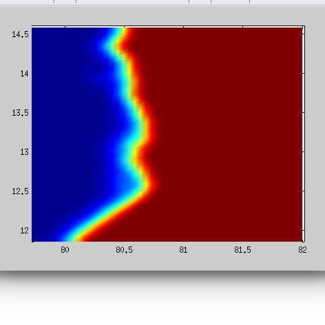

How to specify boundary conditions.. please have a look at the attached figure. I have grid that has west side land. right side open to ocean. I guessed that north and south are periodic.
Therefore i defined CLO , PER, CLO , PER in input file. Please look at the attached input file ocean_upwelling.in

- mygrid.png (22.64 KiB) Viewed 22689 times

If the image is of bathymetry, it is not periodic north-south, so using PER is not appropriate for those boundaries. I usually use RadNud, but that requires values from outside around the boundary. You can get values from SODA or from HYCOM and interpolate to your grid. Or you can set it analytically to match your initial conditions.roopakotta wrote:Hello,
