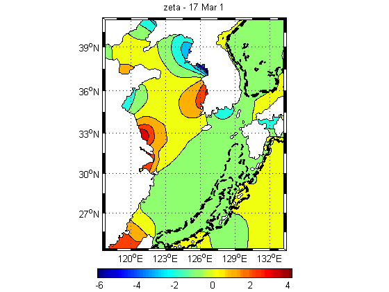

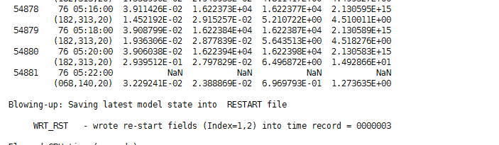

I run my model with ecmwf surface forcing(only contain sustr,svstr,shflux,swflux,swrad),tide and river,and the hmin=5m,hmax=5000m,and the initial condition come from hycom ,the boundary condition come from SOAD.my model blow up(fig 1) ,in the first time(dt=180s), it is a point with too large speed in ubar field,then i change the dt from 180s to 120s, and it blow up too ,and in the last record of rst file ,the zeta ,ubar,vbar, u, v, temp and salt is all nan in some region(around Korea)(fig 2 show the zeta).
Can someone give me some suggestions . Thank you very much.

You could try a shorter timestep yet again. If the model blows up at the same model time with that, then you know it's something else, not the timestep. Once things have gone to NaN, it's hard to know what's the cause. You could run to a step or two before the blow up and plot those fields.

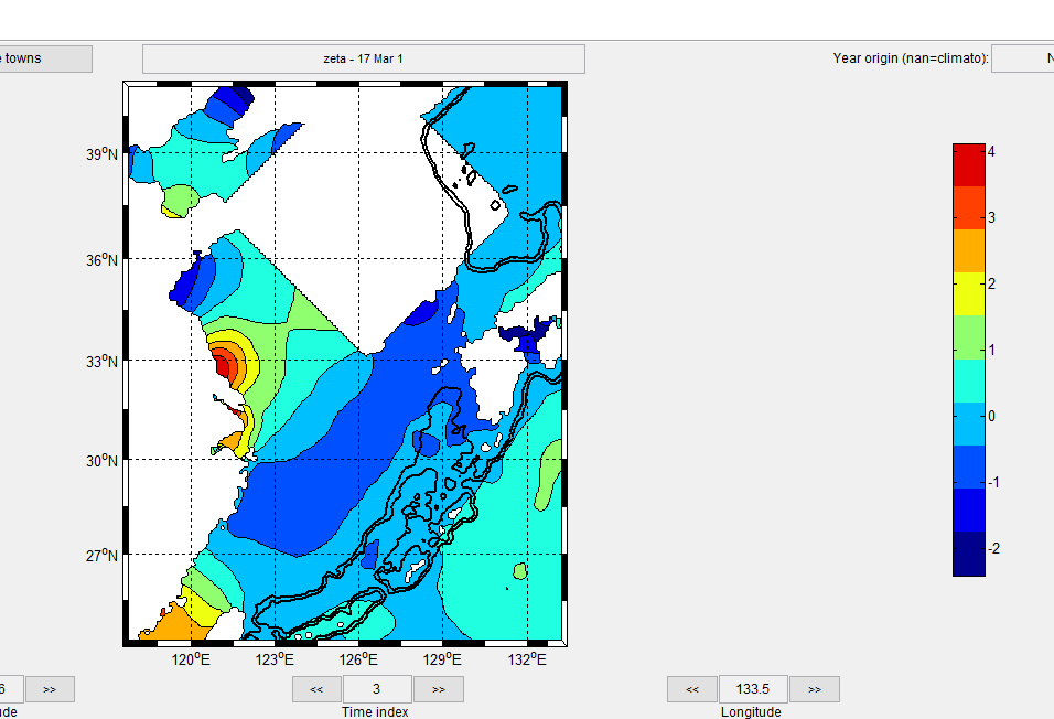

This doesn't belong in ROMS-ice,maybe i post my problem in wrong topic.I have try a shorter timestep(60s),the model blows up at the same model time with a large speed point in ubar field(i=314,j=183).And i find the h+zeta near this point (i=314,j=184)with value -0.1243 small than zero.I think this would be the reason lead to model blow up.And i find the zeta value(Fig1 last record from -6.2 to 4.2 m) is strange to the value of soda monthly data(-0.1296 to 1.5208 m in the average of 1999 to 2010 in my research region).Could anyone tell me what may lead to my zeta field different from SOAD value.

You've got tides turned on. Are there large tides in that bay? If your model tides don't match the real ones it could be the bathymetry. What is the source of your bathymetry and how good is it? You could also turn on the WET_DRY option so that the model won't let h+zeta go negative. We have resorted to modifying the bottom drag to change the tides too.

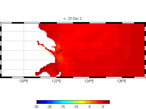

I turn on the WET_DRY(dcrit=0.1),and the model blow up again in the model time 712 day with speed v field in 12 sigma layer(total 20)(fig1),Can someone give me some suggestions.Thank you very much.

Reduce the timestep until you get past the blowup time?
