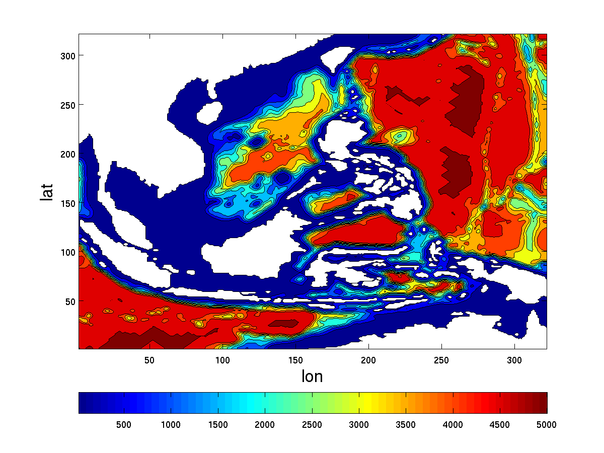

The first thing I would do is change NINFO from 30 to 1 so that you have a better chance of watching things go bad. The second thing I would do is change Vtransform and Vstretching to 2 and 4, respectively.
You have a negative DZmin, perhaps because of the above problem with your vertical coordinate system since your hmin is under water. Your horizontal grid has a significant range of dx,dy values - making sure the grid varies smoothly is important too. Will you show us the grid?

thanks for reply.
I have modified the NINFO, Vtransform and Vstretching as your advise.
I also modified the depthmin to 15, depthmax to 5000 of the grid file.
Here are the result file and my grid picture.
what's the problem? Thanks a lot.

Re: Blowing up of south china sea in COAWST
11 56228 00:44:00 8.445392E-02 2.057582E+04 2.057591E+04 5.396080E+16
(187,123,11) 1.391172E+00 1.990482E-02 1.802320E+00 5.233135E+01
DIAG speed trouble 52.331346771928267
DIAG speed ijk 71.540996526572471 187 123 11
By the way, it happened at (i,j,k) = (187,123,11).
thanks kate, i modified the DT == 120.0d0, it run correctly, thanks for your help
