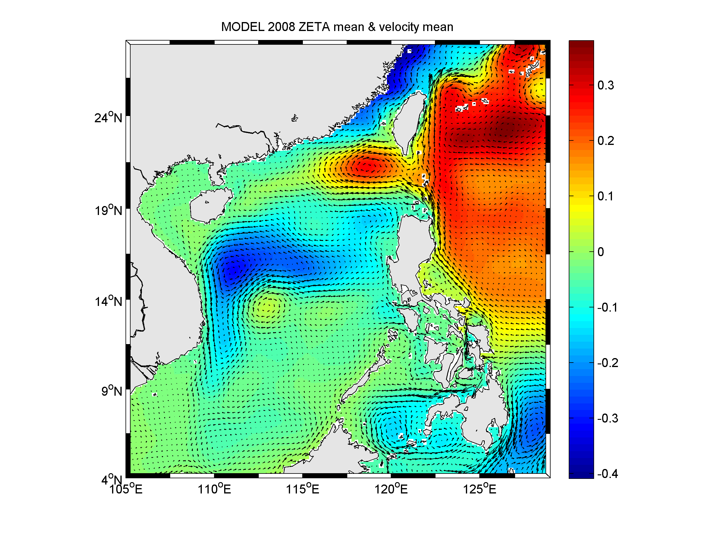

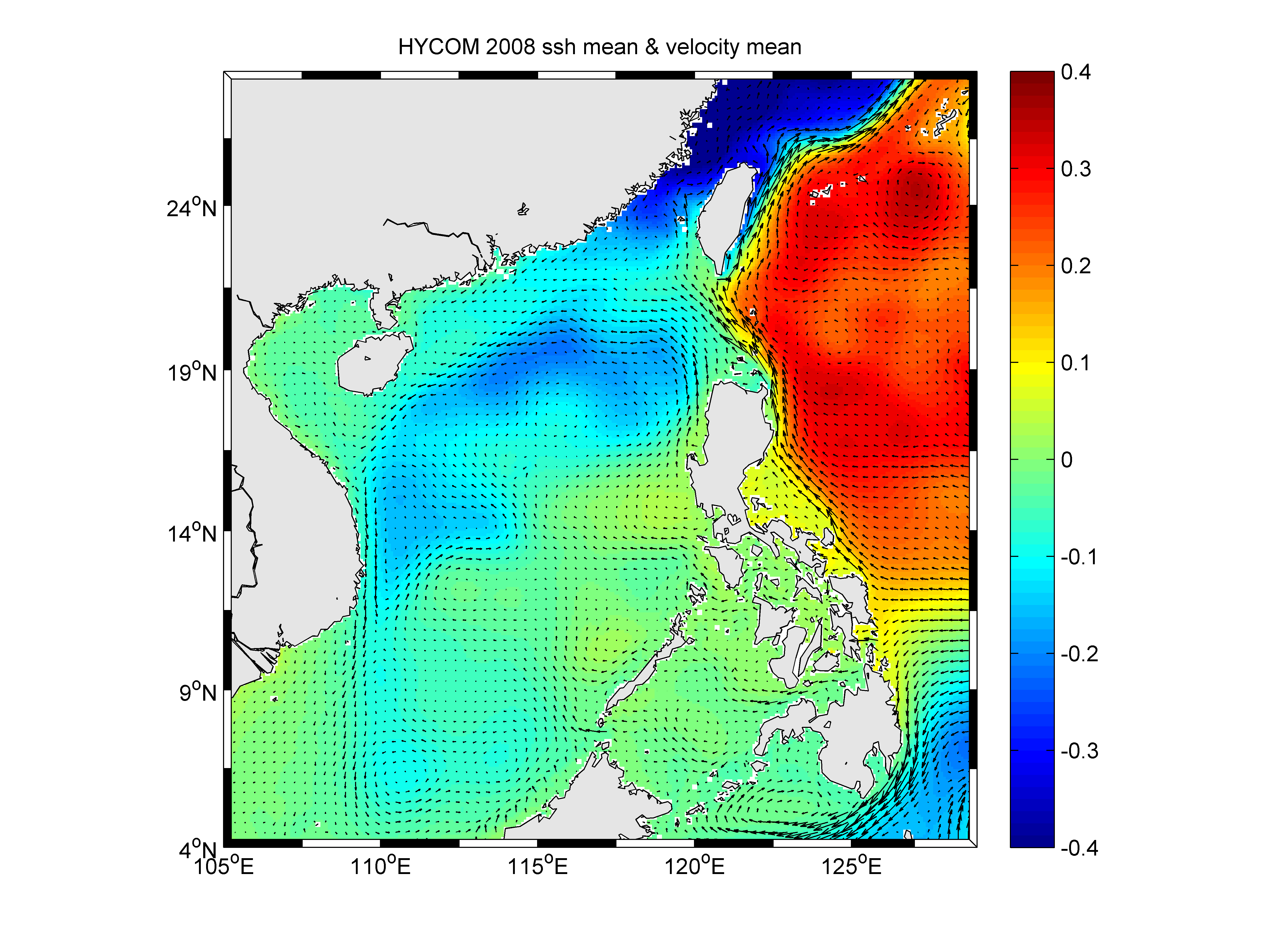

Hi,
I wanna to make my model closer to the hycom in order to run some sensitive experiments.I use the hycom data as the boundary and initial condition.The only force is wind from CFRS.
The outcome is bad,and I suspect that I don't set the parameters well because most of them are difficult to undertand. I also upload the model output as a picture which compares to the hycom.You can see the Kuroshio intrusion is so strong even form an eddy in the western of Luzon strait.
Here are my parameters.I wonder that someone could give me advice and point out some obvious mistakes.

data from my model whose Kuroshio intrusion is much stronger.
data from Hycom
data from Hycom
