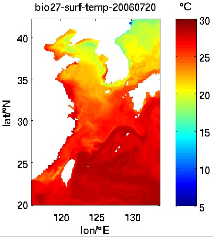

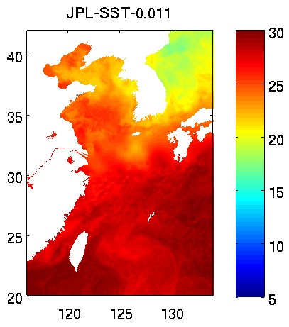

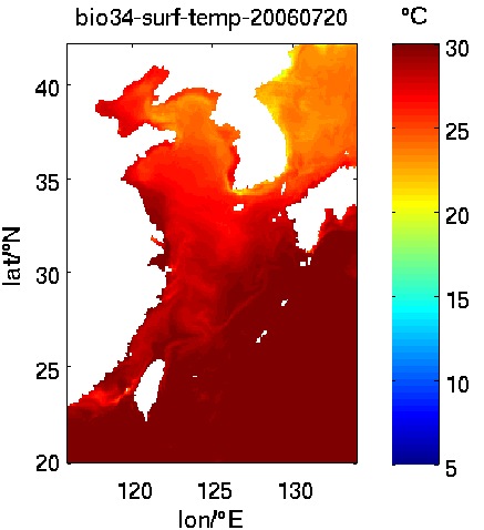

I tried two cases, one with 'define bulk_flux', the other one without bulk_flux. All the atmospheric forcing are from ECMWF-ERA-interim. Simulated salinity of two cases are similar.
The simulated surface temperature without 'bulk_flux' is similar with SST of JPL data. But the simulated temperature with 'bulk_flux' is overestimated (see figures). The only difference of the two headfiles is that 'bulk_flux' was defined in 'with bulk_fulx' case. So the problem should be related to the 'bulk_flux' formula. What should I do about it?
I saw a post viewtopic.php?f=14&t=3066 about overestimating the temperature. Should I add 'define ALBEDO' in the 'with bulk_flux' case?
Thanks.

with bulk_flux case: SST
JPL SST:
JPL SST:
without bulk_flux case: SST
