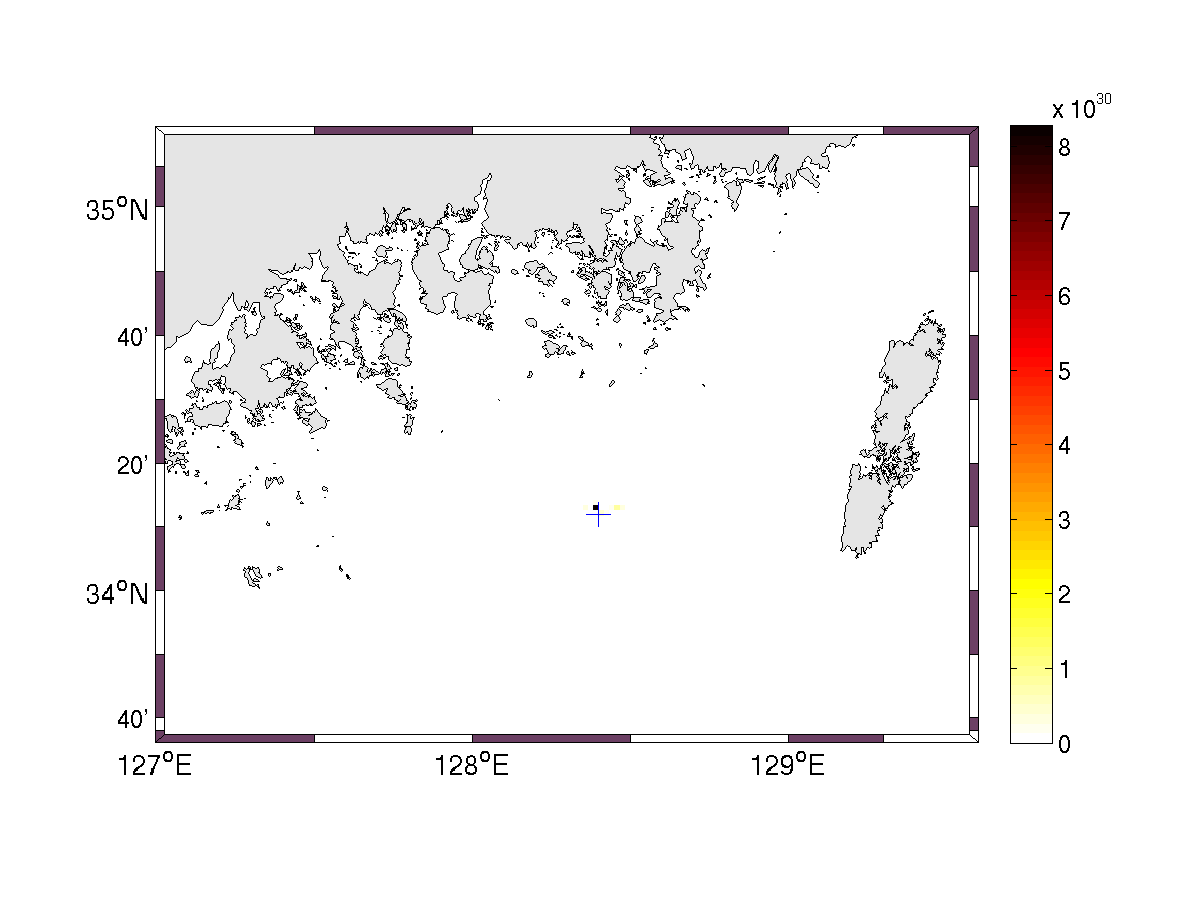

The sediment in my domain was only fed from the aforementioned river source, not from the initial condition nor boundaries (sand_01, mud_01 =0). However, I still can not figure out why the bed mass kept increasing as shown in the attached pictures (please find the attached figures including bedthickness.JPG and sandmass_bottom.JPG. In those figures, the cross sign describes location of releasing sediment source, some different colorful cells around cross sign show the value of them)

is the river coming in from a masked area? It needs to be coming in from a masked area. What was the flow rate?
