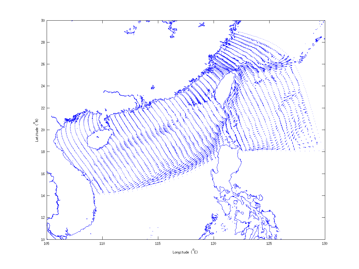

Hi everyone!
I run a Northern South China Sea case. I get some velocity vector fields that look abnormally at south boundary.
Here are the plot, *.h file and *.in file:
Velocity vector field on Jan 31,2008
LBC(isFsur) == Clo Cha Cha clo ! free-surface
LBC(isUbar) == Clo Fla Fla clo ! 2D U-momentum
LBC(isVbar) == Clo Fla Fla clo ! 2D V-momentum
LBC(isUvel) == Clo RadNud RadNud clo ! 3D U-momentum
LBC(isVvel) == Clo RadNud RadNud clo ! 3D V-momentum
LBC(isMtke) == Clo Gra Gra clo ! mixing TKE
LBC(isTvar) == Clo RadNud RadNud clo \ ! temperature
Clo RadNud RadNud clo ! salinity
#define UV_QDRAG
#define TS_U3HADVECTION
#define TS_C4VADVECTION
#define MIX_S_UV
#define MIX_GEO_TS
#define SPLINES
#define SPHERICAL
#define SSH_TIDES
#define UV_TIDES
#define BULK_FLUXES
#define LONGWAVE_OUT
#define LMD_MIXING
#define LMD_RIMIX
#define LMD_CONVEC
#define LMD_SKPP
#define LMD_BKPP
#define LMD_NONLOCAL
#define LMD_DDMIX
#define ANA_SMFLUX
#define ANA_STFLUX
#define AVERAGES
#define DIAGNOSTICS_UV
#define DIAGNOSTICS_TS
Though I have read the CPP options in the manual ,I still confused. Something wrong in my *.h file or my lateral boundary conditon type,I think.
