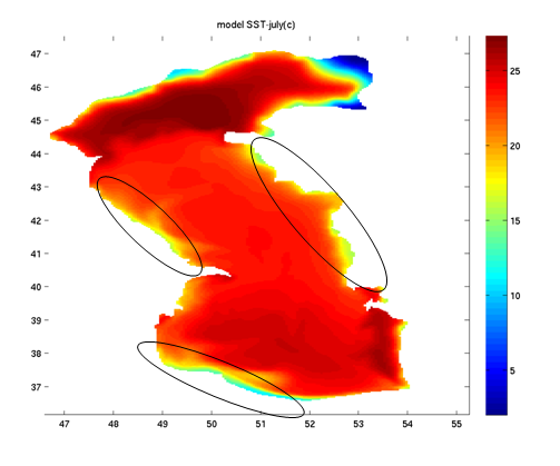

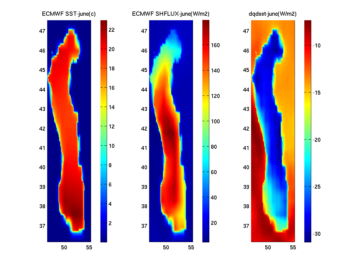

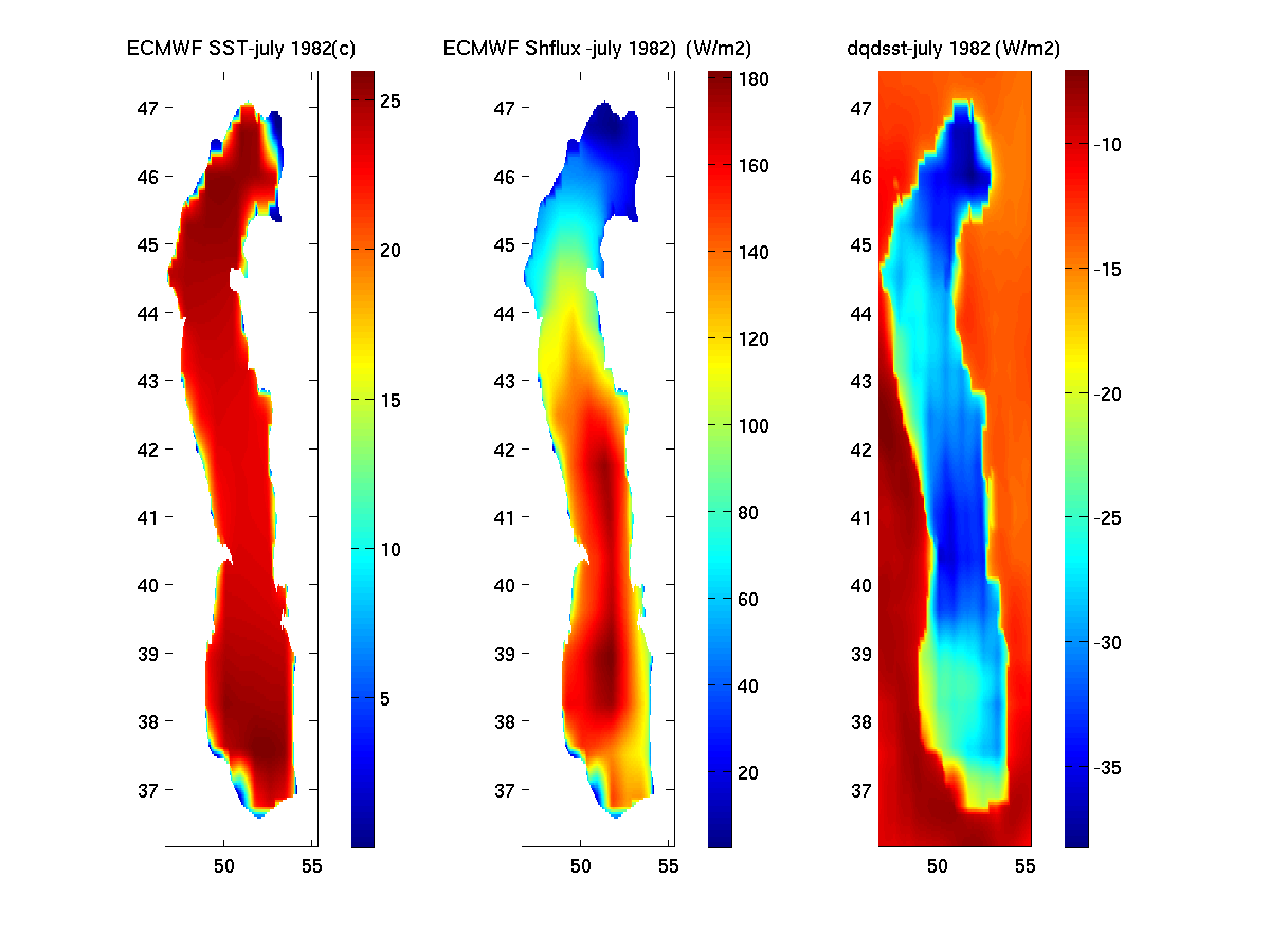

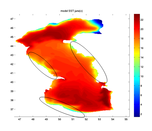

Wind stress, surface net heat flux, surface net fresh water flux, net solar radiation flux, are applied force files in my case. Then, SST and dqdsst (base on formulation in Barnier et al 1995) have been added to get better model's SST. BUT now model's SST has problem near the shore line (area in elliptic). It is strange that in that shallower area, model's SST is less than middle area(especially in summer months :shock: ). I can't recognize that input files cause this error or it needs to active another option in header files :oops: what is your comment for me? using SST from another data base, or using larger time interval for SST nudging ( i have used 3 hourly)?
I have attached June and July model's SST and also some input data to model (such as shflux, sst and dqdsst) for both months.
Many thanks for your attention to help me
P.S
All input data provided form ECMWF_Interim in forecast version with 3 hourly time interval. Also applying its SST in reanalysis version (with 6 hourly time interval) cant solve above problem, too.

This looks to me like you are interpolating zero values from the ECMWF land mask into your coastal ocean. You instead need to be extrapolating ocean values into the land areas before you do any interpolation. ROMS can handle the interpolation, but not the extrapolation - this should be done as a preprocessor step in the tool of your choice. There is a sosie package which someone helped me get going with to do the extrapolations for the MERRA fields. I'm sure others do this in Matlab.
