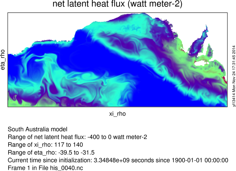

Hi everyone,
I am using ROMS (Version 741) trying to simulate South Australia ocean (15oE - 40oE, 30oS - 40oS). However, after 1 month run, the SST is 2~3 degrees lower compared with HYCOM data (which is the initial and boundary condition). It seems that the main error is from latent heat flux, which is about -500 ~ -100 W2m-2. The atmosphere forcing I use is CFSR dataset, including rain, 2m air temperature, 2m specific humidity, 10m wind speed, MSL pressure, cloud cover, shortwave and longwave radiation. The varinfo.dat is as following,

I notice that wikiROMShttps://www.myroms.org/wiki/index.php/R ... eat_Fluxes mentions q10m in latent heat calculation. But it seems that previous versions of ROMS use q2m. Should I switch to q10m? If not, where may the problem be?
Thank you

Hi Hernan and Paula,
Thanks for your reply. I confirmed that the settings in .in file are correct. In addition, I compared the bulk_flux.F of ROMS 741 (which I am using) and ROMS 451 in COAWST(some colleagues have used before) and found that the calculation of latent heat is different. I tried to modify the code according to the old one and it seems to work properly now.
Here's what I modified,
# if defined LONGWAVE
!  Use Berliand (1952) formula to calculate net longwave radiation.
!  The equation for saturation vapor pressure is from Gill (Atmosphere-
!  Ocean Dynamics, pp 606). Here the coefficient in the cloud term
!  is assumed constant, but it is a function of latitude varying from
!  1.0 at poles to 0.5 at the Equator).
! liyi add 20141125 begin
#  ifdef SPECIFIC_HUMIDITY
!  specific humidity in units of kg/kg
          vap_p=PairM*RH/(1.0_r8+0.378_r8*RH)             !WPB
#  else
      IF(RH.lt.2.0_r8) THEN                               !WPB
! liyi add 20141125 end
          cff=(0.7859_r8+0.03477_r8*TairC(i))/                          &
     &        (1.0_r8+0.00412_r8*TairC(i))
          e_sat=10.0_r8**cff   ! saturation vapor pressure (hPa or mbar)
          vap_p=e_sat*RH       ! water vapor pressure (hPa or mbar)
      ELSE                                                !WPB
          vap_p=0.001_r8*PairM*RH/(1.0_r8+0.000378_r8*RH) !WPB
      ENDIF                                               !WPB
#  endif
#if defined CORE_FORCING || defined SPECIFIC_HUMIDITY
! Incoming humidity is specific humidity in (kg/kg)
          Q(i)=RH
#else
          IF (RH.lt.2.0_r8) THEN                       !RH fraction
            cff=cff*RH                                 !Vapor pres (mb)
            Q(i)=0.62197_r8*(cff/(PairM-0.378_r8*cff)) !Spec hum (kg/kg)
          ELSE          !RH input was actually specific humidity in g/kg
            Q(i)=RH/1000.0_r8                          !Spec Hum (kg/kg)
It seems that ROMS calculates Q (Q=RH/1000) and vap_p (vap_p=0.001_r8*PairM*RH/(1.0_r8+0.000378_r8*RH)) from RH. But if 'RH input was actually specific humidity', this code may cause errors especially when the unit of RH is kg/kg. So should I times the input specific humidity by 1000 and specify it in varinfo.dat?
Thank you
Yi
