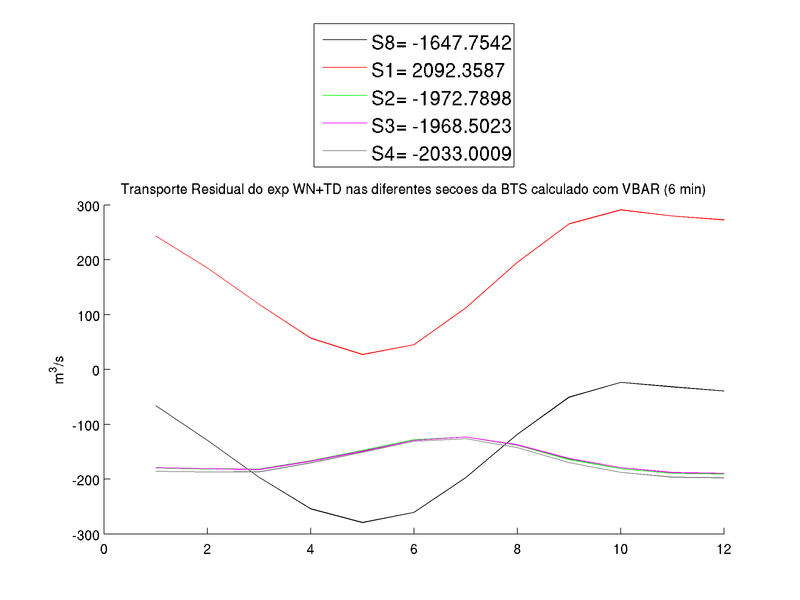

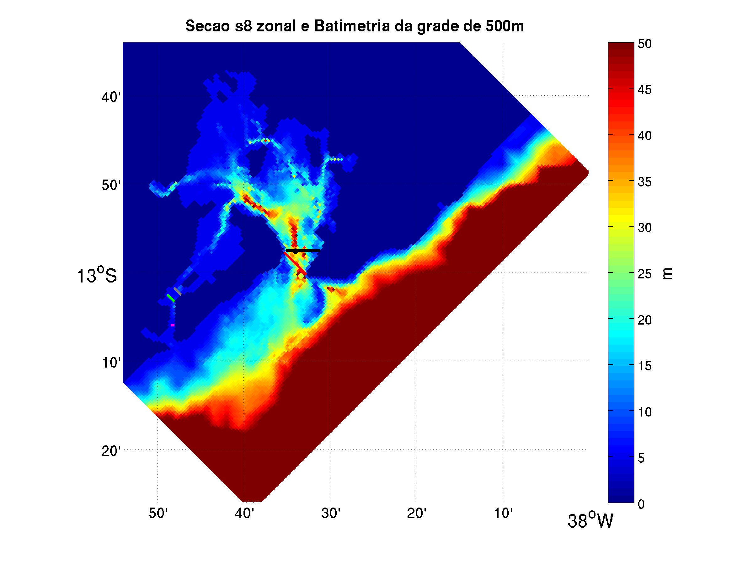

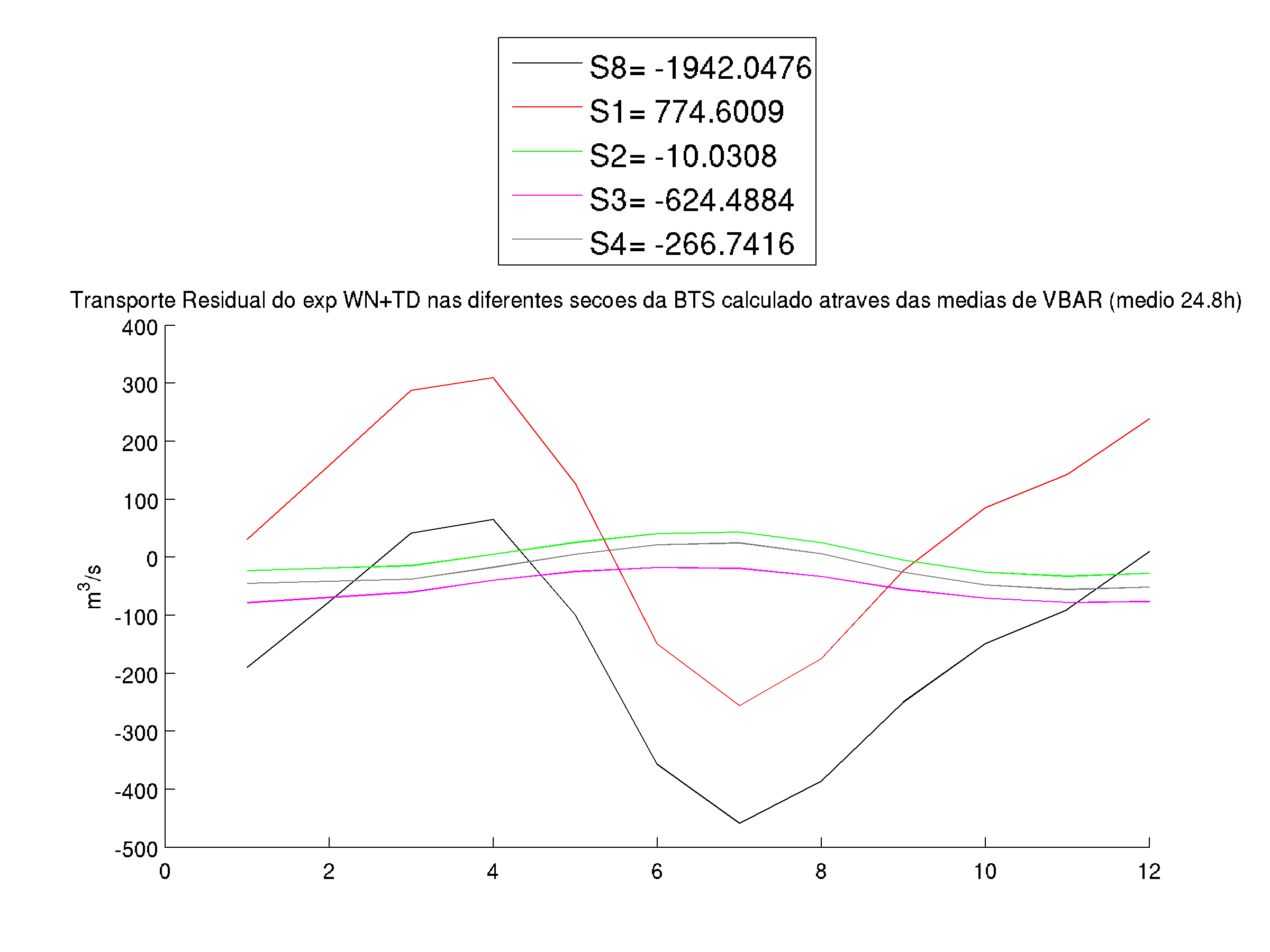

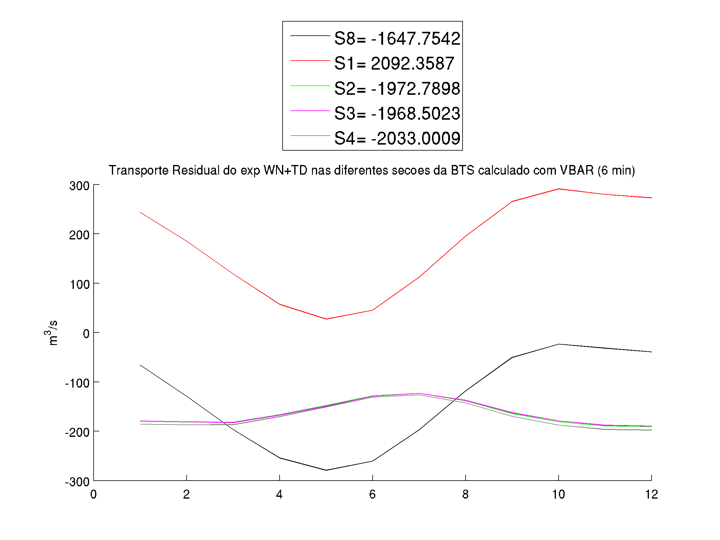

Actually, at the beginning I used residual (or monthly averages) of vbar_northward (at rho points)*dx*(h+zeta residual). Then I summed the residual transport through the section, positive transport plus negative transport to obtain the residual transport.
I was wondering if the eulerian residual circulation do not represent well the residual transport of volume. Because I calculated the residual transport in five different sections (Fig 1 and 2) of the bay using averaged vbar and it showed contrasting values (Fig 3). However, when I interpolated the hourly outputs to six minutes I got better results (~2000 m3/s of inflow and outflow in both bay entrance) (Fig 4) (five minutes ago) . I am starting to believe that with more discretized outputs to calculate the transport (approaching an integral) I can achieve more reliable results. Although, there are some questions to answer, as: Why residual transport is constrasting at the same entrance?
Monthly residual transport (calculated 6 min VBAR)for different sections. Legend shows annual residual transport in m3/s.
Monthly residual transport (calculated with averaged VBAR)for different sections. Legend shows annual residual transport in m3/s.

Grid bathymetry with 5 sections. Sections' colors match the residual transport in Fig 3 and 4.
