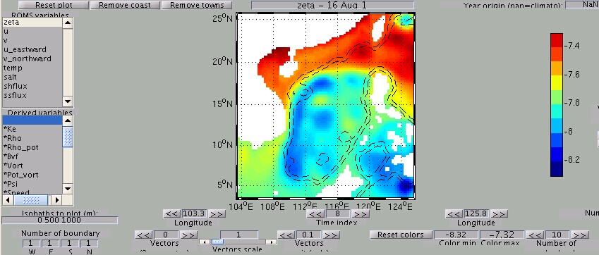

Sorry,I don't say totally,before I change lateral boundary condition type to be shown follow:
LBC(isFsur) == Clo Cha Cha Clo ! free-surface
LBC(isUbar) == Clo Fla Fla Clo ! 2D U-momentum
LBC(isVbar) == Clo Fla Fla Clo ! 2D V-momentum
LBC(isUvel) == Clo RadNud RadNud Clo ! 3D U-momentum
LBC(isVvel) == Clo RadNud RadNud Clo ! 3D V-momentum
LBC(isMtke) == Clo Gra Gra Clo ! mixing TKE
LBC(isTvar) == Clo RadNud RadNud Clo \ ! temperature
Clo RadNud RadNud Clo ! salinity
the result is abnormal,the northern of temperature is high,and ssh is big,water out without into.I think the reason for this is caused by setting boundary.
