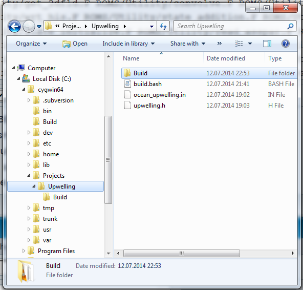

Attaching my build.bash file and file structure;
File structure
File structure

The $HOME variable wasn't set. I also rearranged the file structure to resemble the one suggested in the guide.
