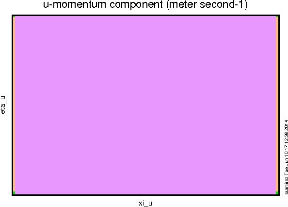

1 At time step = 0 we can see that the LBC at the 4 corners of the domain doesn't have the value that is expected to be.(green color)
The corners have the mean value between m3obc at the LBC and the next value in the interior grid point. (0.1+0)/2 = 0.5 m/s

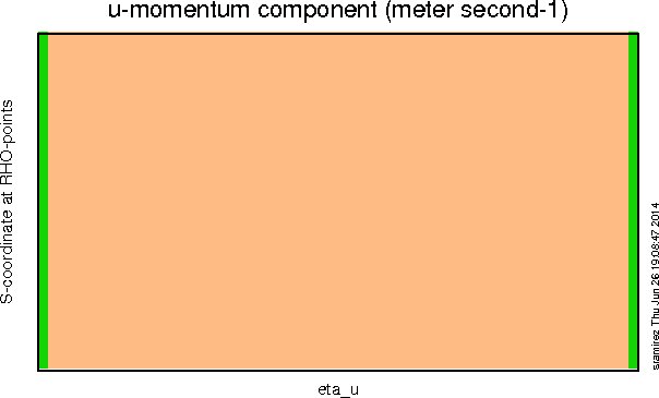

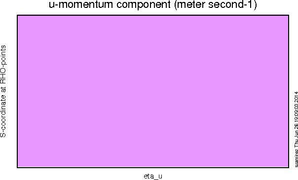

2 The Clamped "profile" disapear at the second time step, beeing the same value that for the initial conditions = 0 m/s

To see what is going on with the corners, the place to look is u3dbc_im.F:
        IF (DOMAIN(ng)%SouthWest_Corner(tile)) THEN
          IF (LBC_apply(ng)%south(Istr  ).and.                          &
     &        LBC_apply(ng)%west (Jstr-1)) THEN
            DO k=1,N(ng)
              u(Istr,Jstr-1,k,nout)=0.5_r8*(u(Istr+1,Jstr-1,k,nout)+    &
     &                                      u(Istr  ,Jstr  ,k,nout))
It looks like LBC_apply is True unless you are nesting, so you just get the average of the two nearest edge values.
