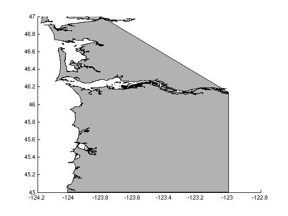

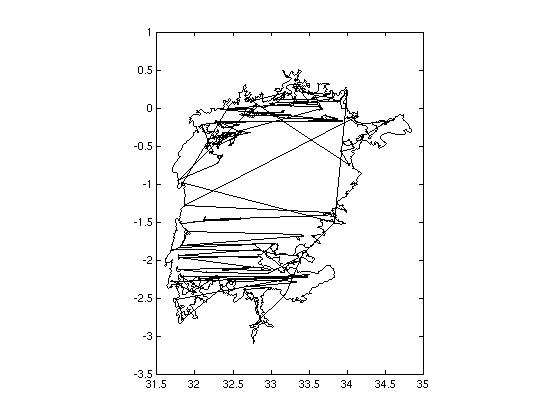

Re: Easygrid creating grid problem
I have looked the files you sent me. mexcdf libraries works for me, so I tried the original version of easygrid as well, just to make sure and it is generating the same result.
I think the problem is with your coastline file. I attached how my coastline looks like and how your looks like. It seems to me that easygrid is having problem understanding the edges of your domain. It took me a while also to generate a proper coastline file and it is not trivial (at least for me). I do not have a general script for that unfortunately, but I basically tried to follow a video tutorial from Richard Signell as far as I remember.
About initial condition: the matlab code I wrote extracts the solution from a coarser grid. Is this something you are looking for?
- mcr_coastline.jpg (21.74 KiB) Viewed 27323 times
- lake_victoria_coastline.jpg (27.02 KiB) Viewed 27323 times
Cigdem
Thanks very much for your reply and your time. Let me try to fix the coastline before proceeding further.
Regarding the initial conditions, yeah that is the script I am looking for. I do appreciate your assistance very much.
Regards
Regards
I have been able to successfully fix the coastline problem. With the easygrid scripts you sent me I can be able to create, plot, edit mask as well as save the grid. I have a problem in saving the in creating the initial conditions (save_init). Kindly help me out.
Regards
Chrispine
Regards
Chrispine

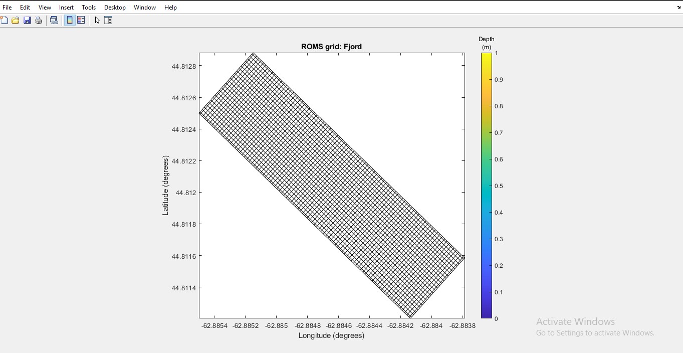

Hi Vilandra,
Thanks for your reply. Till now I have been using the Fjord example. I can plot the .mat files (bathymetry and coastline) with the same results as easygrid_v0.
However, when I run the easygrid_v2 .m file only the grid is plotted with no coastline or underlying bathymetry plotted. I do receive warnings:
** EASYGRID ***************************************************
GENERATING grid...
Warning: Duplicate data points have been detected and removed - corresponding
values have been averaged.
> In griddata>useScatteredInterp (line 184)
In griddata (line 125)
In easygrid (line 332)
DONE!
As a work around I have been able to run easygrid_v0 initially to define the grid and then cd to the easygrid_v2 dir and successfully write out .nc files by setting create_grid = 0 in the easygrid_v2 .m file, (using the grid produced by easygrid_v0.m).
David

I am new to creating grid using Easygrid. I downloaded easygrid_v2 as in the forum and also applied all the changes discussed in this thread. My generation also ran without any error message. But my grid looks empty for the default fjord case.I am hereby attaching my photo of the grid and my easygrid_v2 package for your reference. I have my mexcdf,snctools, matlab_dir all added to matlab path correctly. Here is my user settings:
% USER SETTINGS *************************************************************************************************************************************
% SWITCHES ( ON = 1; OFF = 0 ) --------------------------------------------
create_grid = 1; % Create GRID. Turn OFF to work with a previously created grid (i.e. grid variables existing on Workspace)
plot_grid = 1; % Plot grid
smooth_grid = 1; % Smooth bathymetry using H. Arango's smth_bath.m , which applies a Shapiro filter to the bathymetry
edit_mask = 0; % Edit rho-mask using interactive plot. Use this to manually change sea-pixels into land-pixels and vice-versa
screen_output = 1; % Displays (on screen) many parameters that need to be copy-pasted in the ocean.in file
save_grid = 1; % Save GRID in a NetCDF file
save_init = 1; % Create (and save) INITIAL CONDITIONS (from grid)
% ON = 1; OFF = 0
% GRID SETTINGS -----------------------------------------------------------
% Geographical and Grid parameters --------
lat = 44.8125; % Latitude (degrees) of the bottom-left corner of the grid.
lon = -62.8855; % Longitude (degrees) of the bottom-left corner of the grid.
X = 9100; % Width of domain (meters)
Y = 2550; % Length of domain (meters)
rotangle = -43; % Angle (degrees) to rotate the grid conterclock-wise
resol = 100; % Cell width and height (i.e. Resolution)in meters. Grid cells are forced to be (almost) square.
N = 10; % Number of vertical levels
% Bathymetry -------------- % Bathymetry for ROMS is measured positive downwards (zeros are not allowed) see: https://www.myroms.org/wiki/index.php/G ... Bathymetry
% To allow variations in surface elevation (eg. tides) while keeping all depths positive,
% an arbitrary offset (see minh below) is added to the depth vector.
hh = nan; % Analytical Depth (meters) used to create a uniform-depth grid. If using a bathymetry file, leave hh = nan;
minh = 4; % Arbitrary depth offset in meters (see above). minh should be a little more than the maximum expected tidal variation.
Bathy = 'Fjord_bathy.mat';% Bathymetry file. If using the analytical depth above (i.e. hh ~= nan), then Bathy will not be used.
% The bathymetry file should be a .mat file containing 3 vectors (xbathy, ybathy and zbathy). where xbathy = Longitude,
% ybathy = Latitude and zbathy = depth (positive, in meters). xbathy and ybathy are in decimal degrees See: http://en.wikipedia.org/wiki/Decimal_degrees
%Bathymetry smoothing routine... See "Switches section" (above) to turn this ON or OFF
if smooth_grid == 1;
order = 2; % Order of Shapiro filter (2,4,8)... default: 2
rlim = 0.35; % Maximum r-factor allowed (0.35)... default: 0.35
npass = 50; % Maximum number of passes.......... default: 50
end
% Coastline ----------------------
Coast = load('Fjord_coast.mat'); % If there isn't a coastline file... comment-out this line: e.g. %Coast = load('Fjord_coast.mat');
% The coastline is only used for plotting. The coastline .mat file should contain 2 vectors named "lat" and "lon"
% OUTPUT: File naming and NetCDF descriptors ------------------------------
Grid_filename = 'Fjord'; % Filename for grid and initial conditions files (don't include extension).
% "_grd.nc" is added to grid file and "_ini.nc" is added to initial conditions file
% INITIAL CONDITIONS ------------------------------------------------------
if save_init == 1; % See "Switches section" (above) to turn this ON or OFF
% Initial conditions will be constant throughout the grid domain
ref_date = datenum(2000,1,1,0,0,0); % TIME_REF in your ocean.in file
ocean_time = 360; % start of your ROMS model (DSTART in your ocean.in file)
NH4 = 0.1; % Ammonium concentration (millimole_NH4 meter-3)
NO3 = 10; % Nitrate concentration (millimole_N03 meter-3)
chlorophyll1 = 0.3; % Chlorophyll concentration in small phytoplankyon (milligrams_chlorophyll meter-3)
chlorophyll2 = 0.3; % Chlorophyll concentration in large phytoplankyon (milligrams_chlorophyll meter-3)
detritus1 = 0.03; % Small detritus concentration (millimole_nitrogen meter-3)
detritus2 = 0.03; % Large detritus concentration (millimole_nitrogen meter-3)
detritusC1 = 1; % Small detritus carbon concentration (millimole_carbon meter-3)
detritusC2 = 0.2; % Large detritus carbon concentration (millimole_carbon meter-3)
phyto1 = 0.02; % Small phytoplankton concentration (millimole_nitrogen meter-3)
phyto2 = 0.02; % Large phytoplankton concentration (millimole_nitrogen meter-3)
phytoC1 = 0.2; % Small phytoplankton carbon concentration (millimole_carbon meter-3)
phytoC2 = 0.1; % Small phytoplankton carbon concentration (millimole_carbon meter-3)
salt = 30; % Salinity (PSU)
temp = 9; % Potential temperature (Celsius)
u = 0; % u-momentum component (meter second-1)
ubar = 0; % Vertically integrated u-momentum component (meter second-1)
v = 0; % v-momentum component (meter second-1)
vbar = 0; % Vertically integrated v-momentum component (meter second-1)
zeta = 0; % Free-surface (meters)
zooplankton = 0.01; % Zooplankton concentration "millimole_nitrogen meter-3"
zooplanktonC = 0.5; % Zooplankton carbon concentration "millimole_carbon meter-3"
end
% END OF USER SETTINGS ******************************************************************************************************************************
Any help from you is actually appreciated.
Thank you in advance
Neel
