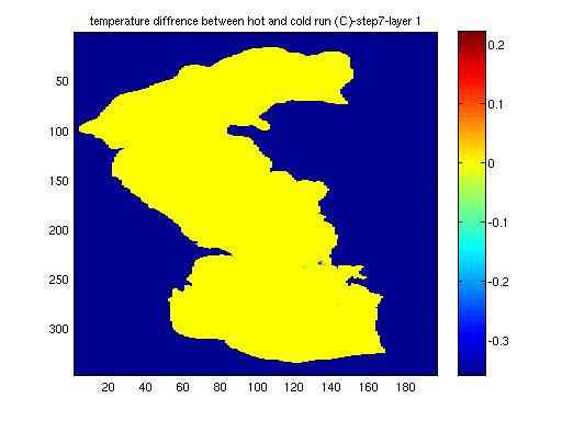

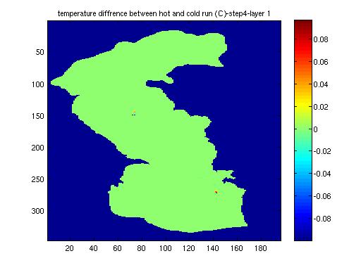

fereshteh
Posts: 79
Joined: Sun Dec 30, 2012 2:58 pm
Location: inio:Iranian National Institute for Oceanography
Re: different restart files
#7 Unread post by fereshteh »
Dear kate
i have tried your new approach.3-days-long model (16 to 18 jan)from beginning and 5-day-long model (18 to 22 jan) started from the restart file of 3-day-long model.
In first one:
Dt=90
Ntimes=2880  %3 days
NRREC=0
LcycleRST=F
NRST=960   %1 day
LDEFOUT == T
Dstart=15.2188
Time_ref=20090101.0
ININAME=initial.nc
RSTNAME == ocean_rip_current_rst.nc
in second one:
Dt=90
Ntimes=7680   %(2880 (3days for restart.nc)+4800+ (5days))
NRREC=-1
LcycleRST=T
NRST= 960
LDEFOUT == T
Dstart=15.2188
Time_ref=20090101.0
ININAME =ocean_rip_current_rst.nc
RSTNAME == ocean_rip_current_rst1.nc
comparing of second model result with 8-long-model ( which were from 16 to 22t January) shows that results are different again :( . It makes me confused :cry:
In attached i put some results of bottom, layer for different steps.
i am worried that after long time those difference increase and effect on hot-start model's results, badly. With regard that i don't have appropriate software equipment to do try-error it for long time modeling ,i become grateful if you have any idea about result tell it to me
I would like to offer my heartfelt appreciation to your patient to help me
Thanks for you patient to help me
cheers
fereshte
P.S
sustr and svstr in all time steps were same in hot and cold run.
max difference =.3379
max difference =.224
max difference=.042
max difference=.042
max dirrerence=.097
max dirrerence=.097

#8 Unread post by kate »
You've got the idea of doing diffs on the netcdf files. Now try again with 3 timesteps instead of 3 days. Save a restart record after 2 steps, then history records after every step, running only 3-4 steps total.
