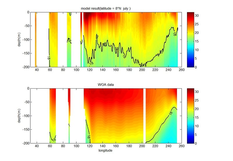

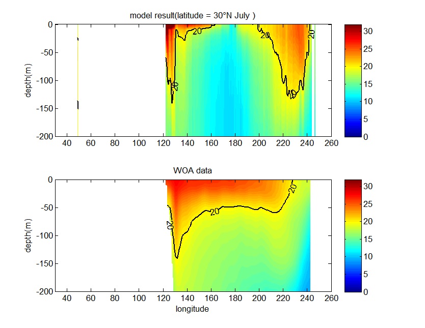

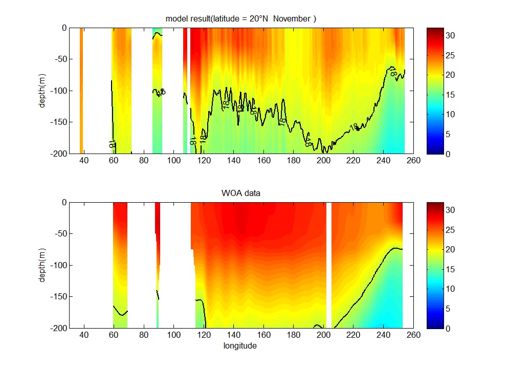

hi,

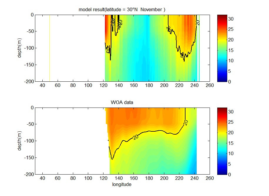

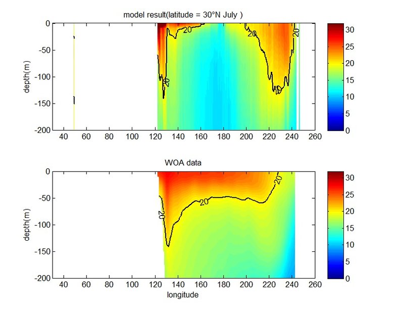

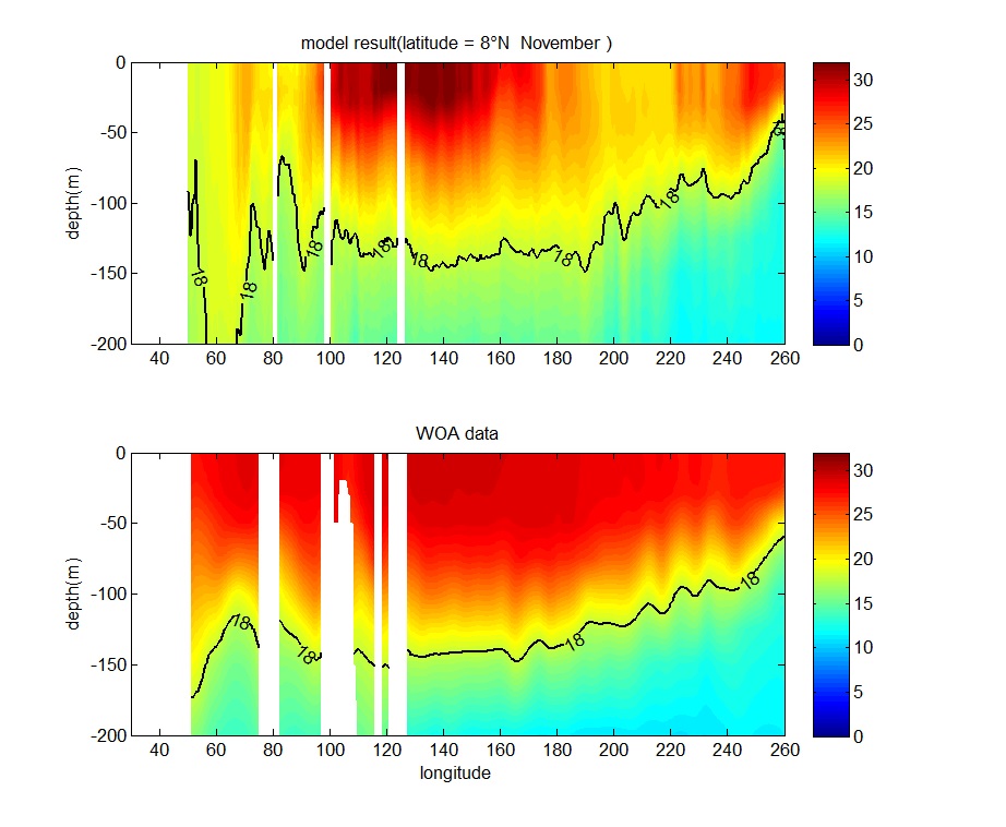

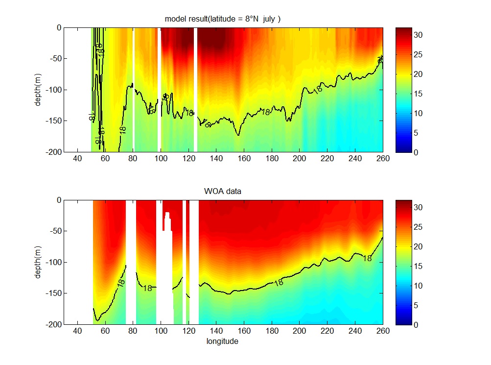

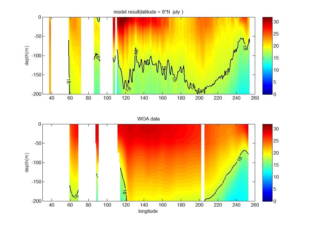

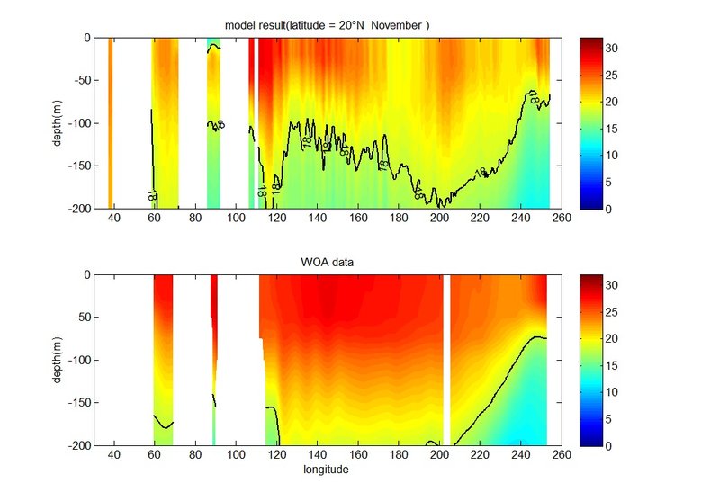

I have learn ROMs some time. I calculate 15 years,and get some results,
when I check the 15th year result which are shown in the below figure,
I am confused, I want to know Whether my result is reasonable,if not,how to improve my calculation?
I use force,ini,bry and grid files,
