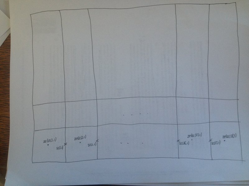

I have found why there are so many peaks. Because u(1,:,:,:) are zeros even not in land. And I checked the depth-averaged continuity equation for the grid (1,400). It is not closed just because of ubar(1,400,:) are zeros. For other grids, such as grid (2,400),the depth-averaged continuity equation is closed. Just like the attachment.
So why the u(1,:,:,:) in output are zeros, even not in land.

The size of ubar is (37,644,60) and zeta is (38,644,60). zeta(1,:,:) are not zeros when there are no lands. So I don't think ubar(1,:,:) is the boundary.
Re: Calculation of river discharge with ROMS outputs
In ROMS, variables are dimensioned for a staggered grid, the numbering starting at i=0 for some, at i=1 for others. This is possible to do in Fortran. When reading ROMS input into other tools like Python and Matlab, all variables start with the same index. I don't remember what it is in Matlab, but in C and Python, all variables start at i=0. That means that preprocessing code must take that into account: the range of u indices becomes 0 to 36 instead of 1 to 37 while the zeta indices remain 0 to 37 for 38 values.
So does it mean ubar(1,:,:) in Matlab is the same as ubar(0,:,:) in Fortran? In the output, the length of the first dimension of u is 37, and zeta is 38.I think the positions of u and zeta in output are like the figure I upload. Am I right? If I am right, the problem is that, u(1,:) are all zeros, but zeta(1,:) and v(1,:) are not zeros. And when I calculate the continuity equation for the grids in the first row,such as grid (1,2), the continuity equation is not closed.
The ROMS view is shown here:
The grids I sent is in matlab.Maybe there is something wrong in the output data. Thank you very much for your help, Kate.
