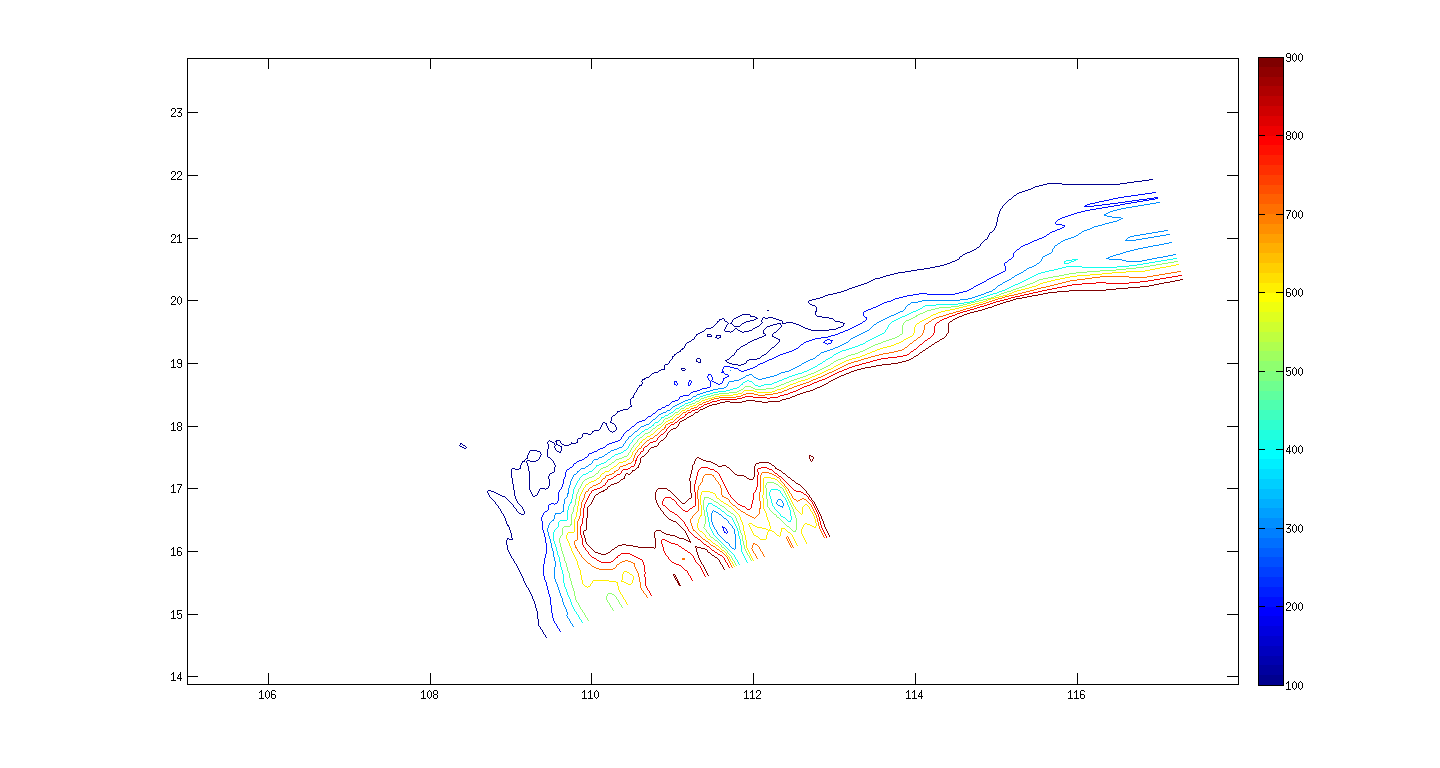

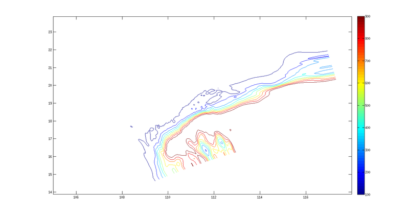

I have a problem when I rum the ROMS,the depth and mask are wrong on the boundary. The depth and the mask are correct in the file grd.nc, but it is change west,east,south and north over in file his.nc. That is to say, the south and north boundary have be switched while the west and east switched. I don't know what happen, and just think some Syntax is wrong in ROMS.

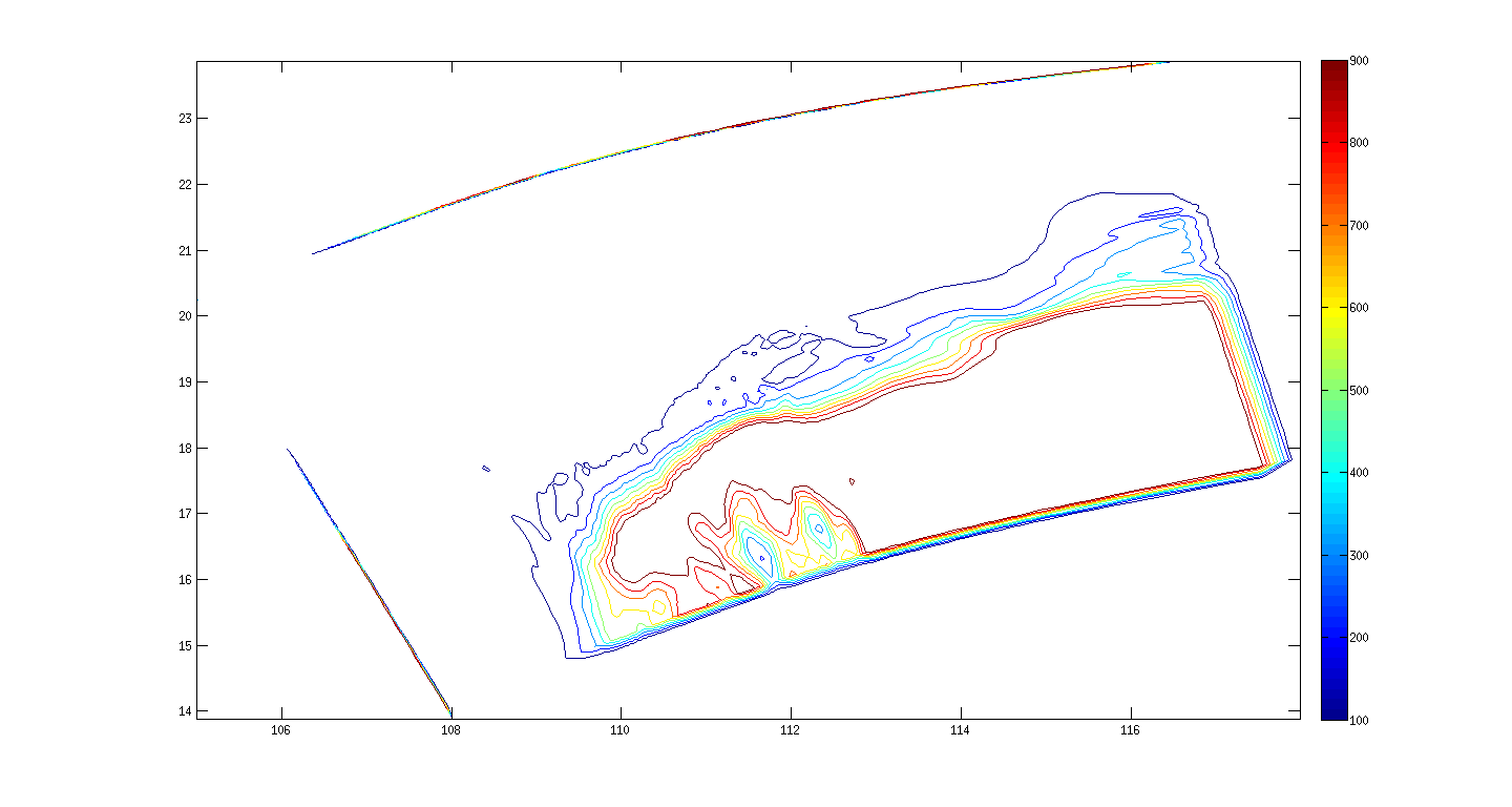

I have played the contour of the depth in his.nc,and found the problem in ROMS3.6. I don't know the reason.
