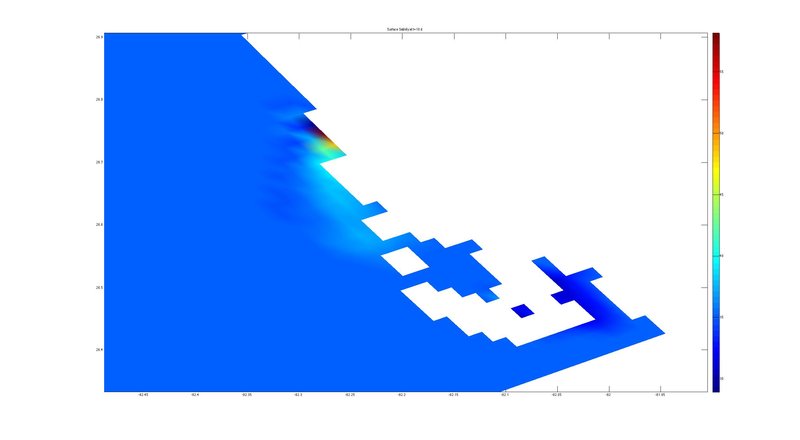

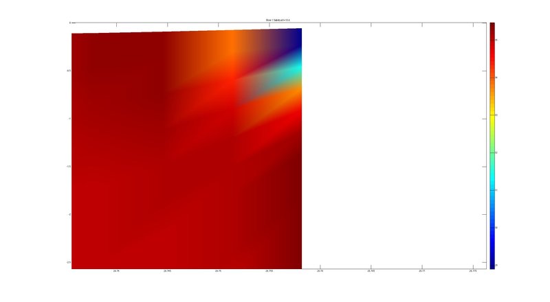

I have added rivers into my domain. The bathymetry was created using SeaGrid. I have checked several times to make sure that my river source points are in the correct locations and they are. I am running the code with both salinity and temperature. Both are showing unrealistic values.
The background salinity is 35 and the rivers have a salinity of 30. The maximum final surface salinity is 59.
If you could point me in the proper direction to a solution I would be forever grateful.
