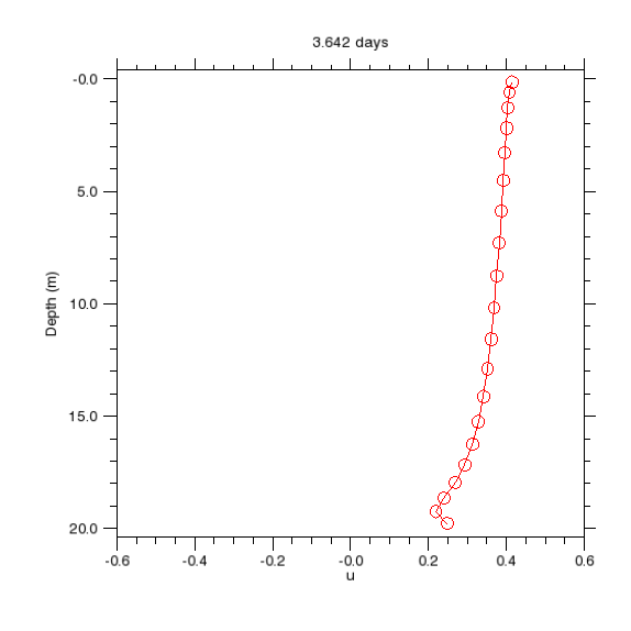

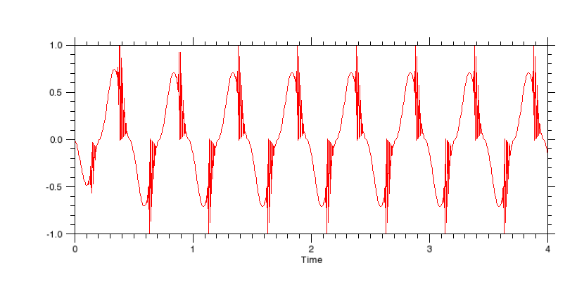

I have attached the necessary header files and the input file, also a time series plot of bottom stress (bustr) and a snapshot of velocity (u).
The toy case involves an oscillating tidal flow (period 12 hours) in a 20m deep, periodic domain. The expected behaviour is that velocity oscillates between about -0.4m/s and +0.4m/s, with a more-or-less logarithmic drop-off towards the bottom. When SSW_BBL and GLS_MIXING are enabled and a reasonable large bottom orbital velocity is imposed (here 0.5m/s) there are rapid oscillations in the near-bottom velocity, bottom stress and TKE when the tidal current is reducing in amplitude. These oscillations develop and die away rapidly. In the velocity snapshot shown here, the bottom velocity at a maximum; at the next time step it is less than 0.
