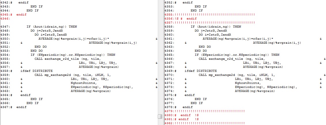

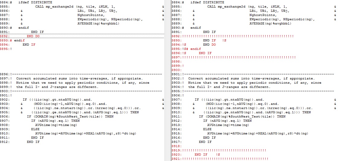

I try to work with a seaice code (omlab ver 1488). Tanslation process show error in set_avg.F. May be I haven't last vertion? In vertion 1488, as it seems to me, some corrections should be made (in attached files, left - original, right - corrected) I am not sure.

You are correct that there are bugs there. I had already hacked it once and I've hacked it again and pushed it out to the repo. I hope it's OK now.

I have replaced set_avg.F with last your version. Program work normally. My corrections were not absolutely correct.
