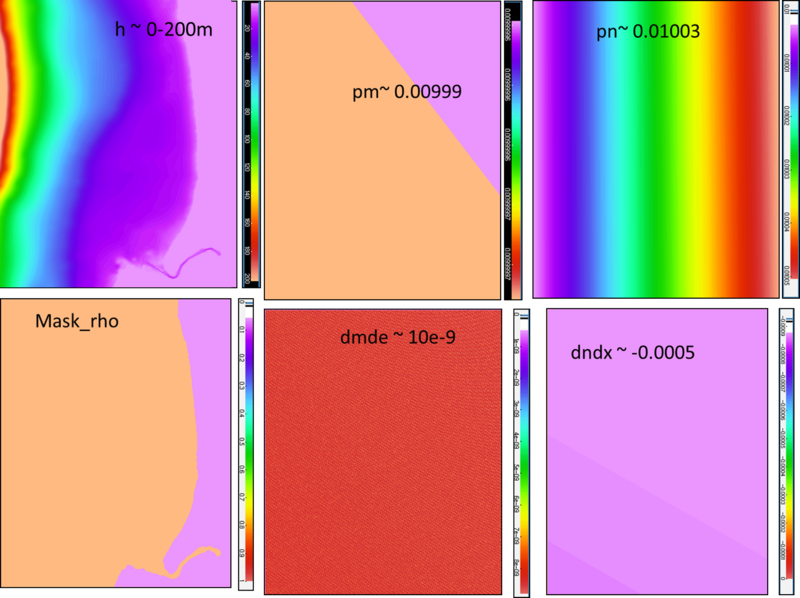

Regarding the grid, working with easygrid seems to work better in my case. The resolution of the grid is dx, dy = 100m approx. and Lx and Ly values are 54Km and 67km approx. respectively and h_max ~ 200m. Let me enclosed a picture with some parameter (ncview_snapshot.png) of the bathymetry.

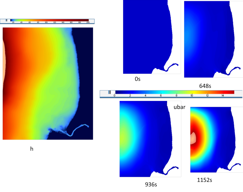

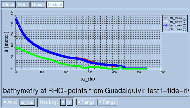

The problem came from the west boundary (left in the picture) a fast and high growth rate for variables is observed in the middle lower part of this boundary. find enclosed a picture (results.png). Also i attach a snapshot of bathymetric profiles (profiles.png) where can be noticed that bathymetry has not any shoal (the green one contains the river.)
I wonder what is the cause of the problem. If it is a bathymetry effect in the boundary, i would make another grid which west boundary start around 100m depth where would leave parallel to this boundary. Also seem to be a boundary problem so maybe the boundary conditions are no appropiated. In this hand i would ask some advise on how to treat the boundary conditions properly and if mines are correct.

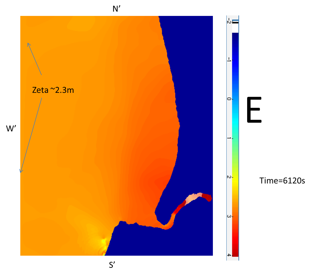

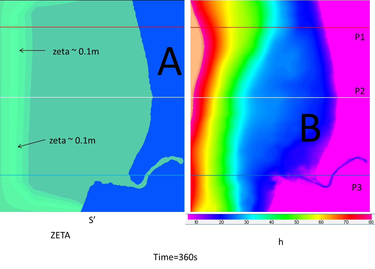

i think the boundary condition issue it is ok. with your comment and some views at roms tests i finally set FSBOC_REDUCED and ***_M2REDUCED,***_FSCHAPMAN and ***_M3RADIATION where ***=N',W',S' boundary. all three wave front are observed from this boundary as is expected. i've also activated WET_DRY and deactivated MASKING. My dx=dy=100m the model only run several steps (1260) until, finally, it blow up.
External mode or dt = dx/sqtr(gh_max)=3.5s; for 3D computations dt=1s (i tried first 20s,10s) and ndtfast=30s, so for 2D computations dt=0.03s (very small?)
let me enclosed some results. Profiles are defined in panel B.

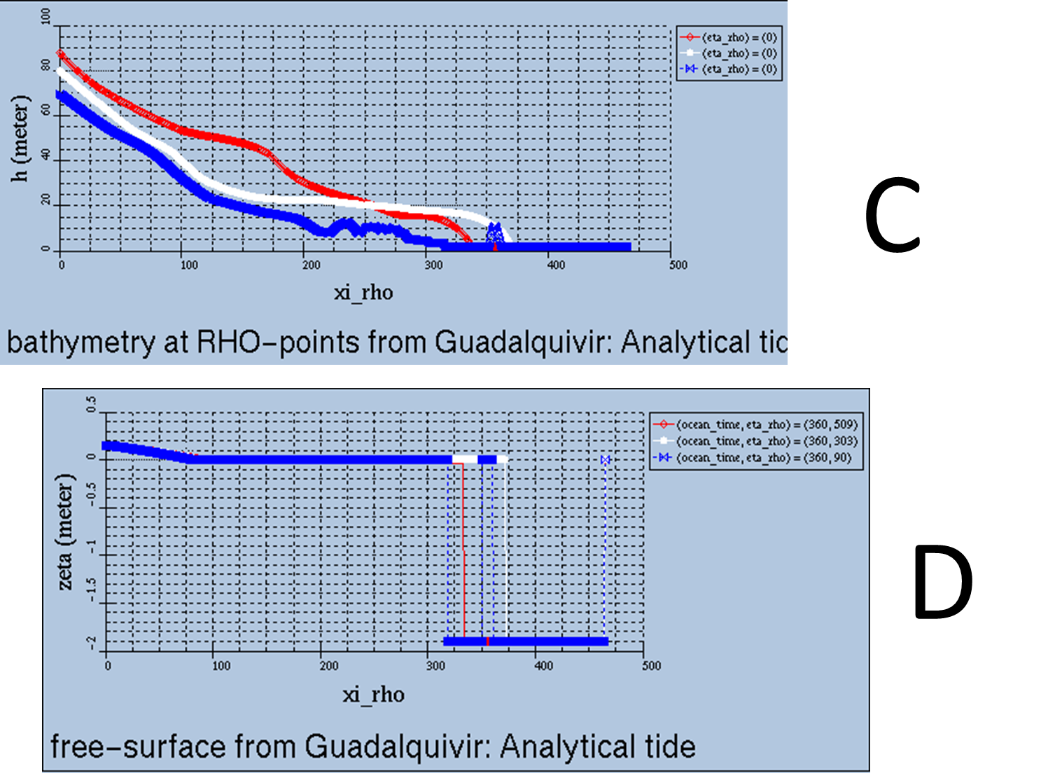

1. The values for zeta in the boundary are reasonable: 0.1m and 2.3m at 360s and 6120s respectively. See contour in panel A y E. Also no highly extreme values (like hundred or so are obtained but the model blow up), the last saved step is panel E.
2. if masking is not activated why i don't see any wet_dry effect?. Although my h is 2m everywhere beyond the coastline (wouldn't be -2m) and zeta is -1.9m (why this value?). please, see zeta and h profiles in panel C and D.
3. which value i should imposed for this variable in input file DCRIT? ( Minimum depth for wetting and drying.)
seeming that bc, time step (maybe so small) are working well could be the wet_dry or land issue the problem? maybe reflection in the coastline? how to solve or figure out that?
thousand thanks in advance.

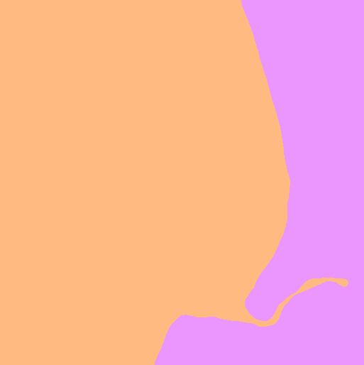

i would like to make a question about the wet_dry masks. i make the masks when making the grid via easygrid. i have got the mask_rho, mask_psi, mask_u and mask_v being all the same (mask.png). Having the WET_DRY option activated three more mask can be obtained (assume are made by ROMS this masks when the option is activated) and can be plotted with ncview (ncview_mask.png), for instance.
The point is that wetdry_mask_rho is the same than before, but wetdry_mask_u=wetdry_mask_v=0 everywhere,is that correct? in the results seem that velocities are doing the wet_dry but not for zeta, does that make any sense?
