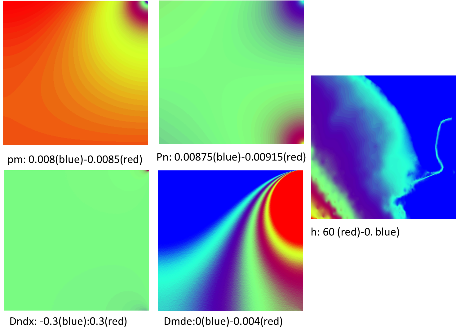

Re: SOURCE POINT FOR RIVER RUNOFF
Hi Ivica, thanks
First, i could not type your command in matlab2010b
>>ncdump -h roms_grd.nc
??? Undefined function or method 'ncid' for input arguments of type 'double'.
Error in ==> netcdf.netcdf at 432
if ncid(result) >= 0
Error in ==> ncdump at 58
nc = netcdf(theNetCDFFile, 'nowrite');
but, typing only ncdump and select my file from a matlab browser window was ok.
please find below the result for ncdump

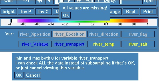

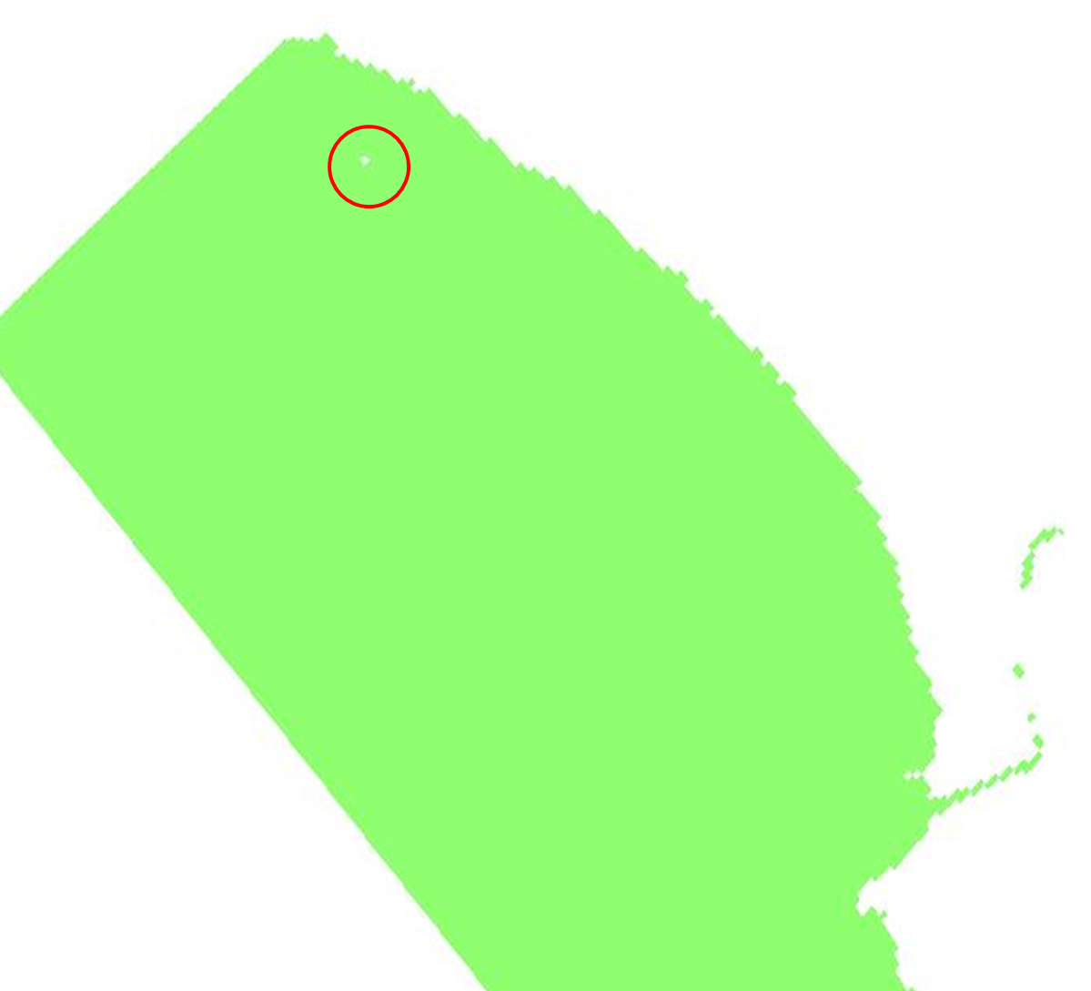

Finally i did get the index of the source point using the function getinput by matlab and using the structure that seagrid save for the grid. In the following variables is the information about grid coordinates.
X=s.geographic_grids{1};
Y=s.geographic_grids{2};
So i've got the index.
i have problem with the Initial basin volumes when try to run.
thanks.
TotVolume = NaN m3
i have added a case in the ana_psource.h for my area
#elif defined GUADALQUIVIR
Nsrc=2
i put 2 for temperature and salinity
Dsrc(Nsrc)=0.0_r8
i put 0, but i don't sure about that. i don;t know exactly what it means. i know it is about the rho_point or u-v points.
Isrc(Nsrc)=11
Jsrc(Nsrc)=36
i put the index i got in the seagrid .mat file.
LtracerSrc(itemp,ng)=F !
LtracerSrc(isalt,ng)=F !
i don't put any information about salt and temp in this point.
Qbar=500
depth integrated flow.
thanks in advanced.

by other hand, i am trying to generate a netcdf file from frc_river.cdl as (better) alternative, how i have been advised.
what is wrong?
also, how to specify the depth integrated flow here? (Qbar)
Here's a dump of a working rivers file:

When I try to create a NetCDF file from the original frc_rivers.cdl and also with a version based on the script posted by Kate (see below), I received the following message:
/usr/local/bin/ncgen -b frc_rivers.cdl
ncgen: frc_rivers.cdl: syntax error
Could you help me please?
Thanks in advence... Best regards

i am still plotting result and testing with tiddlyspot tools.
All the variables 'u',.. seems to be zero.
and i only could plot one time step, see below
i am excited to get correct result soon and start to have a robust model for my place (after 60 post).
thanks for you help kate.
by the way, where or how could i change the time step? i guess in .in file, is it?Requested time index 2 not available
There are 1 time records in ocean_his.nc
What is the circled value and what are all the green values? That's the u field, but did you look at the depth and pm, pn values in the grid file? Those all have to be non-zero and finite.
the green valued it is the 'u' field at some depth. IT is all zero valued, and i realized that there was a hole inside the circle, so that means sure there is a NaN value there maybe due to something wrong in the grid. Probably that the reason why i obtain
Initial basin volumes: TotVolume = NaN m3.
maybe some depth is NaN. i think maybe a finer grid would be better but before that:
i am trying all the command ncdump, ncview in matlab but i don't no why it is not working.
i could get to work with ncview. The grid cover an area of approx. 35km x 27km with dx=118m dy=89m, respectively.kate wrote:Maybe so. Where did you get the grid from? Have you looked at the grid file with ncview?
i took a look to several variables with ncview, for instance pn and pm, whose values are nonzero and finite. the typical values are 0.008 for pm 0.009 for pn.
regarding h, i've enclosed a figure. coast seems to be not well defined the in the mouth area (land and water is mixing?)
i get NaN for the initial basin volumns, Minimum anbd maximun Z-grid spacing and Maximum grid stiffness ratios:
these are the values of courant number, for Dt=5s
Minimum barotropic Courant Number = 0.00000000E+00
Maximum barotropic Courant Number = 1.00787915E-02
Maximum Coriolis Courant Number = 8.77401737E-05
many thanks.
The numbers you give at the bottom there for the range of h look more like your pm/pn numbers. h is the depth in meters and should be nonzero everywhere - unless you have WET_DRY defined.
yes, you are right that are the values for pn and pm (just i copied the caption for the figures of pn and pm), the depth range values varies between 65m and 0 (approx) for the sea and also i have negative values for land in my original file. wet/dry it is not define yet.
let enclose again.
many thanks.
let enclose again.
many thanks.
- Posts: 81
- Joined: Thu Dec 07, 2006 3:14 pm
- Location: USGS
I would suggest setting your minimum depth to a positive number (say 2 m) and see if it will run this time. It seems to me that you might be having a problem with the depth values. Do you think you might have a grid point that has not been masked properly and has a depth of 0 m maybe?
Zafer
Zafer
Regarding to the source point for river runoff i would like to introduce one my area like the picture indicated, please see attachment.
the first idea i've got was based on ANA_PSOURCE, TS_PSOURCE, UV_PSOURCE or "analytical way". After read the Arango's post viewtopic.php?f=30&t=1733&p=6270&hilit=TS_PSOURCE#p6270 and thinking on to develop a robust model for further realistic applications seem much more reasonable try the "netcdf file way".
I think that "analytical way", at first view, seems easier to understand and to get an idea on how river is being modelling. So, one should be able to specify
* Numbers of point, Nsrc, direction (eta or x directions), Dsrc, and index coordinates Isrc, Jsrc
* integrated mass transport (m3/s) Qbar (positive or negative)
* 3D distribution, if define 3D, for temperature and salinity Tsrc(is,k,itemp),Tsrc(is,k,isalt)
but as it is warned in the former link "we are representing an estuary with a single point". Please, just let me post some question about how to proceed in the second way to get an good idea how it works.
"netcdf way"
* from a .cdl you have to generate the netcdf file with ncgen -b filename.cdl. The .cdl file i have, posted by kate before, it is working (i can generate the netcdf file). i guess that the name of the .nc river file has to been provided in .in file.
* i assume that "xi", "eta" are the index where the source it is located and "s_rho" the sigma coordinate where to locate vertically the source. So, seems like again a simple point it has been specifying. am i wrong with that or another extra information would have been provided like shape or contour of the river, max and min coordinates of the river inside the grid,.....
* what are the variables "river" and "river time"?
* river_Xposition:valid_min, river_Xposition:valid_max, river_Eposition:valid_min, river_Eposition:valid_max would be the max-min index that river could be use (so these values have to match with the max-min index grid ones)
* i want to use both temp and salinity, i saw "river_flag:option_3", how to specify this flag? How to provide they values
* how to specify the Qbar in this case?
* should i still keep defined UV_PSOURCE or TS_PSOURCE in my .h file?
Among the grid file i never try to do a netcdf file. Some help or also ROMS-links to overcome the doubts will be very welcome.
Many thanks in advance.
"netcdf way"

When you use ncgen, what was in the source file? I probably just gave you the header. Are there any values in there for the variables? You need to set those somehow. You can run a full "ncdump" on the netcdf file to see the data values. Ncview is another way to see what's really in the file. You can also ncdump into a file, set the data, then run ncgen again.
thanks kate.
Yes, i think that not all variables are includes or at least not well included. That is what i really want to learn how to do it. Very clear how to (and which var) introduce via ana_psource.
the variables are defined but not valued. i took a look your .ppt but i not figure out how to give the values.
For "river_Xposition", "river_Eposition", "river_direction" and "river_flag": all missing values warning is obtained with ncview. And "river_Vshape", "river_transport", "river_temp" and "river_salt" i get the message "min and max both 0 for variable....".
this my (your) .cdl file, the variables are red highlighted. Where i have to specify the values in this file?
thanks in advance.
thanks in advance.
The ncl scripts shown in part in the ppt file are on my web site in full, in this directory. The "write" ones show how to create files that are populated with values.

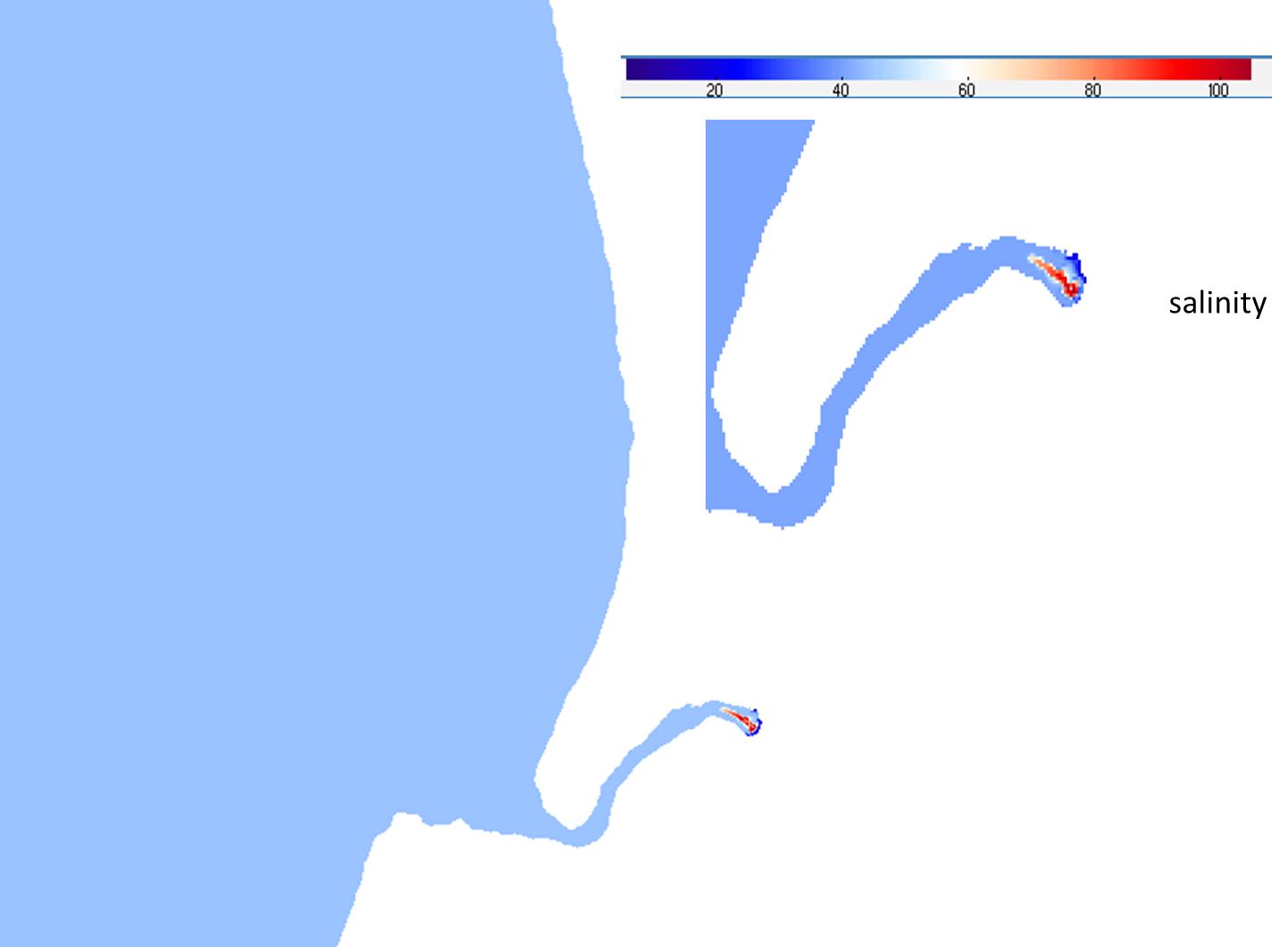

thanks kate, i think i get the idea, definitely gonna be, among others, on netcdf file. Let me post something about source point method.
After read "treatment of river" and about vertical structure or how many points to choose i think that's far away to be a simple problem. But i would like to see how much can i get from this via and see how is the behavior of Temp and salinity.
my entire domain start with constant values for Temp and Salinity, 18 and 35 resp.
in the source point i imposed a value for 500m^3, typical value for the river discharge, T=20 and Salinity=0.
the result after about 3800s is enclosed below.
I get high values of salinity. some idea what is happening that? should i activate some other options (maybe numerical scheme related) when salinity is working?
thanks in advance.

In the Data/ROMS/CDL directory, there is an example of how the river netcdf file should be structured. It is asking for the xi,eta positions of your rivers. These are required fields. The T and S are not required, depending on how you set LtracerSrc in your ocean.in file, but note that on inflow, you might need to set T and S for improved numerical stability.
Thank you so much Kate.I am trying that.
