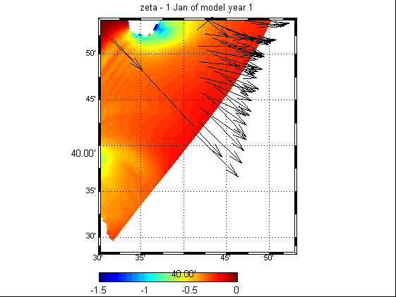

I also try do run it with a little time step, it takes a long time, but it still blow up at the same time. I think there is a problem with the Wet_Dry option, because I have some velocity which blows up near the coast
You can see on this picture that the velocity near the coast explode and is directed toward the coast.

Hi, I have the same problem with high velocity near the coast (resulting in model blow up). Did you solve yours?

Are you using the WET_DRY option? How shallow is your coastal water?

Hi Kate,
no, I'm not using WetDry and my shelf region has very shallow parts. I am gonna try that.
