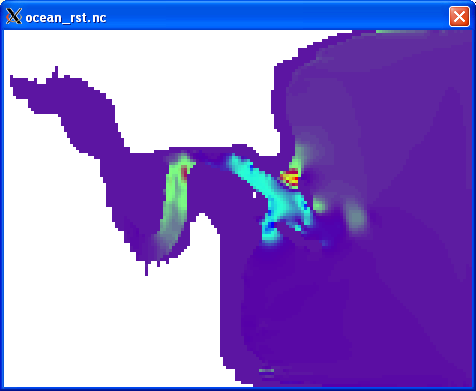

I have been trying to solve a blow-up with wetting and drying. The bathymetry has terrible metrics, according to the output:
 Maximum grid stiffness ratios:  rx0 =   1.960000E+02 (Beckmann and Haidvogel)
                                 rx1 =   1.466021E+04 (Haney)
However, I don't think this is the problem. For one thing, I am not sure these metrics are correct when used with bathymetry with both positive and negative values. (This is the Teignmouth case, with tide range of >4 m). I have added constant offset to the depth (to make it all positive), smoothed the bathymetry to a maximum rx0 of 0.3 (using Mathieu's LP_Bathymetry package), and then removed the offset. Mathieu's GRID_RoughnessMatrix.m file returns max rx0 of 0.3 when the offset is added, but approaches ~200 after the offset is removed, mostly on the edges of the estuary channel. Anyway, I don't think that is the problem, because the blow-up is not associated with the steeper parts of the bathy grid, it is on one of the flanking sandbars. Also, the model blew up at exactly the same spot and time step AFTER smoothing the bathymetry, which makes me think that is not the problem.
It appears as a NaN in u and v at the margin of a cell that is going dry. (White spot in ncview image).
I am doing a run with a changed tiling scheme and an increased Dcrit to see if that changes things. Any other suggestions?

Update on this problem: another run, with DCRIT increased to 0.5 m and tiling switched runs a little longer, and blows up in a different spot (steep channel edge as water level is rising). The location is not close to a tiling boundary.

Update: A simple case (no waves or sediment transport) with the smoothed grid (see note below) now runs to completion, with a tidal range of ~4 m.
Neil Ganju suggested changing the s-levels (He da man!). New values are: theta_s = 1; theta_b = .8, tcline = 0.
In addition, we switched from UV_QDRAG to UV_LOGDRAG and set both zos and zob to 0.004 m, in hopes of keeping them < 1/2 layer thick in dry cells, where DCRIT = 0.1 m. Maybe the zos and zob changes were pure superstition.
Note: This is the version with the smoothed grid, where rx0 = ~200 according to ROMS and Mathieu when both positive and negative depths are included, but is actually max rx0 = 0.3 after the depths are made all positive by adding 7 m prior to calculating rx0. I am even more sure that the formula for calculating rx0 needs to use the absolute value of h in the denominator when negative depths (i.e. regions above mean water level) are present.
We don't think the problem was related to tiling.
Of course, we changed several things at once, so we aren't sure which one was key to getting it to run, but we will do some runs to find out. Stay tuned.
