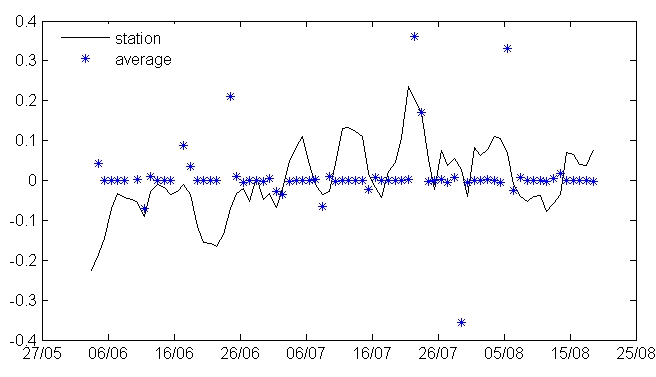

I have tried using the AVERAGES_DETIDE option to create detided data for the boundary of a child model. To test the detided output, I created an number of station files in the domain and used t_tide to calculate a detided zeta for these stations. I compared this with detided zeta (zeta_detided) from daily averages files for the same locations and found that they did not match at all (see attachment). In most case zeta_detided was zero or near zero (i.e. low frequency effects like inverse barometer are stripped out too).

Just to close this posting off, I found out that the tide harmonics in the tide forcing file were not being accumulated because the NRREC flag in the input script ocean.in was 0. I changed to -1 and now the detided data is looking good!
