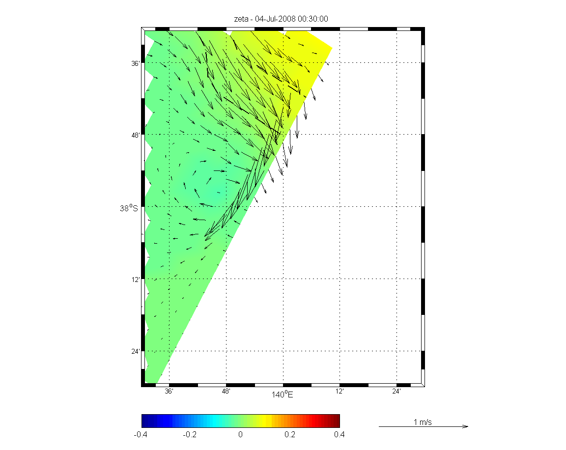

Well, in case anyone has a clue, here is a snapshot of what happens at the boundary.
The aberrant velocities are at column Iend-1. (The ubar BCs at the eastern boundary are calculated at Iend+1; they are not plotted). ubar is too small at Iend; vbar is too big at Iend-1.
The colours here are sea level. The sea levels look fine. So it seems like the overlarge velocity is due to continuity (ubar too small at Iend).
I read in the boundary condition ubar_east and zeta_east from a netcdf file. They are both set to zero at the eastern boundary. As before, it is an FSChapman+M2Flather boundary condition.
Thanks!
John

Well I would not be happy with that phrase "... a few cells inside things in velocity field is OK." We have seen this in our application for the Adriatic Sea when one can get strong along boundary current that is due only to boundary conditions; like yours.. Imagine that you have some tracer like T that is supposed to leave domain, with your figure fr ubar I am pretty sure that you'll have return inside the domain and endup with building up of T in a long run...
So be careful with that, a few cells are not enough!
