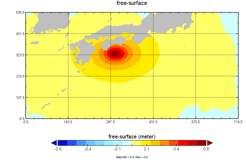

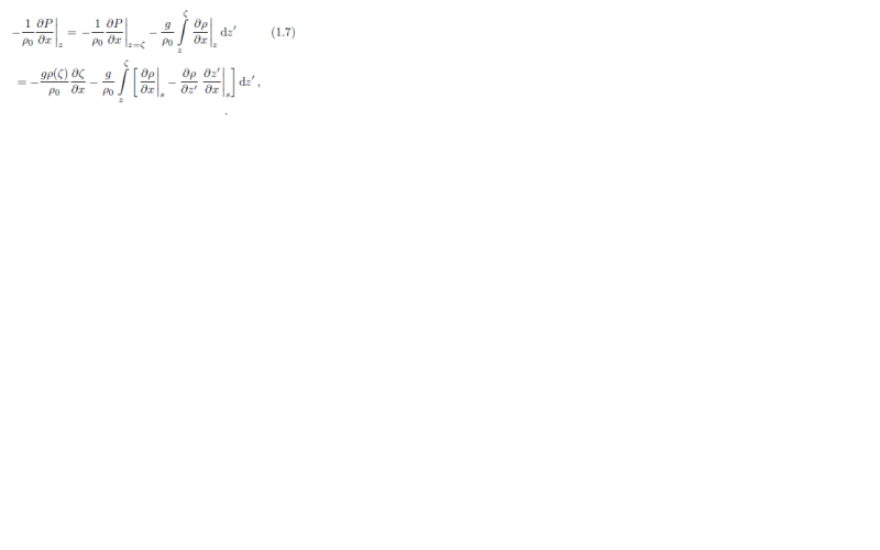

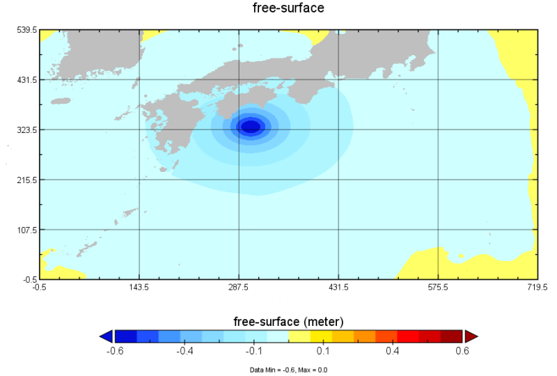

Okay, I know that this is an old post, but I have been looking at the 3D and 2D pressure gradient terms and the various algorithms available. I implemented the astronomical tide generation forces (TGF) in terms of the equilibrium tide (ζeq), defined as the shape that the sea surface (m) would assume if it were motionless and in equilibrium with the TGF on a fluid planet (see trac ticket).
The first thing that I noticed is a typo/bug in prsgrd32.h:
We are computing here kinematic pressure (P/rho0), so P has units of m2/s2. This algorithm is based on the density Jacobian, and we compute kinematic pressure, vertically integrate, and evaluate its gradient. The issue here is the first term that includes the surface elevation, z_w(i,j,N(ng)), needs to be scaled by g instead of Grho0 (g/rho0). That term is only affecting the value of g. It is around a 0.97 smaller. This bug has not yielded significant effects on my testing solutions. Recall that the value of P is not as important as its horizontal grandient.
However, I have lots of issues when I implemented the TGF term in the pressure gradient. Recall that the TGF term is defined as: -g [∂(ζ - ζeq)]/∂x . Therefore, the correct code is:
Below are two figures that show the sea surface elevation for the center of the Gulf of Maine (top) and at the entrance of the Bay of Fundi (bottom). ROMS is configured with boundary tidal forcing, tide generating force, and inverted barometer effect in the pressure gradient.
As expected, the TGF makes very small corrections to the boundary tidal forcing. Users will need to activate both tidal forcings (SSH_TIDES, UV_TIDES, TIDE_GENERATING_FORCES). The ATM_PRESS is activated for all solutions.
Now, I am wondering if the stability issues that Mark was talking about when implementing the inverted barometer (IB) effect term needed (Pair-OneAtm). See the ATM_PRESS option. Maybe the issue is due to the bug of the scaling of the sea surface term.
Recall that the inverted barometer effect is usually defined as: -g [∂(ζ - ζib)]/∂x where ζib = P'/(rho0*g). See Wunsch and Stammer (1997) paper: Atmospheric Loading and the Oceanic Inverted Barometer Effect.
Therefore, I think that there is also a bug in the barotropic inverted barometer effect. In step2d_LF_AM3.h we have:
It seems to me that if we follow Wunsch and Stammer (1997), we need to have instead:
We need the minus sign and flip the order of the spatial derivative of Pair. Similarly, we need to do the same for the other component rhs_vbar (m4/s2). We haven't noticed this because this part of the code is only activated for shallow-water applications (SOLVE3D is off). We need to design an application for testing this. Say a shallow-water storm surge application. Any volunteers? I am swamped a the moment, and it has very low priority on my long list.

The 1000/rho0 is density over density and those units cancel.
I think the reason for the 1000/rho0 scaling is from Sasha's paper:
A Method for Computing Horizontal Pressure-Gradient Force in an
Oceanic Model with a Non-Aligned Vertical Coordinate
equation 1.7 it has
1000.0_r8 * GRho * z_w =
1000.0_r8* g/rho0 * z_w
so this is g*z_w * 1000/rho0
and you want it to be
g*z_w
well, the difference is 1000/1025 = 0.97, as you said.
But it does not have the wrong units. The units are correct.
equation 1.7 it has
- arango

Dear arango
I try to run 2D mode in ROMS version 4.1.
In step2d_LF_AM3.h, we have:
The modified code is:
The same changes are made to rhs_vbar.
This case is storm surge caused by a typhoon. As a result, the original code shows the water level dropping at the center of the typhoon. On the other hands, the modified code shows the water level rising at the center of the typhoon due to inverted barometer effect.
I hope this helps.
Original code: Modified code:
! Compute pressure gradient terms.
cff1=0.5_r8*g
cff2=1.0_r8/3.0_r8
#if !defined SOLVE3D && defined ATM_PRESS
fac3=0.5_r8*100.0_r8/rho0
#if defined ATM_PRESS && !defined SOLVE3D
rhs_ubar(i,j)=rhs_ubar(i,j)+ &
& fac3*on_u(i,j)* &
& (h(i-1,j)+h(i,j)+ &
& gzeta(i-1,j)+gzeta(i,j))* &
& (Pair(i,j)-Pair(i-1,j))
!#endif
rhs_ubar(i,j)=rhs_ubar(i,j)- &
& fac3*on_u(i,j)* &
I hope this helps.

Re: Horizontal surface pressure gradient forcing in 2D and 3D
I don't have a shallow water (2D kernel) application to test this term. But, yes, a cyclone rotates counterclockwise around a center of low atmospheric pressure in the northern hemisphere. Consequently, the inverted barometer effect causes the water level to rise to form a dome around the low-pressure center. The opposite would happen over a cell of high air pressure causing the water level to drop.
Good catch, thank you I agree that we will need a minus sign in the barotropic pressure gradient above. However, we didn't discover this bug because we rarely run the shallow water setup, much less with atmospheric air pressure forcing.
Checking on my notes, I did notice the plus sign when I was coding the TIDE_GENERATING_FORCES adjacent term in step2d for a similar shallow water setup. I was supposed to set a test case with air pressure forcing, but it was low on my long priority list. So, I forgot. Thus, your application is a good one to test the ATM_PRESS term. Thanks.
