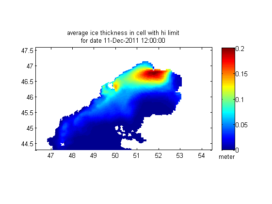

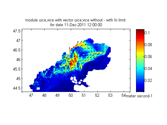

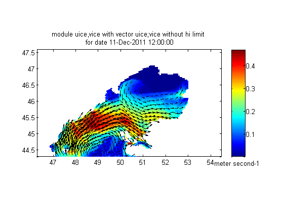

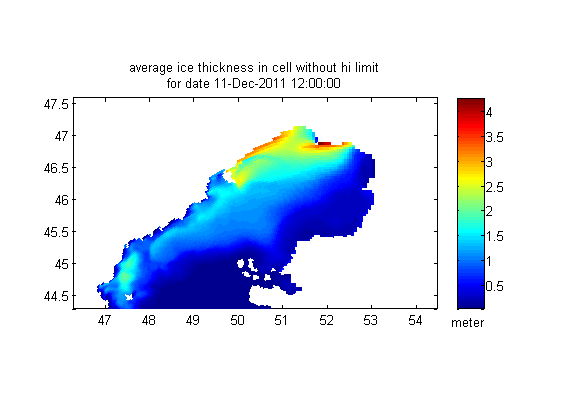

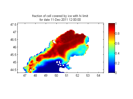

Some fast results are attached
Do not judge strictly
Difference of ice velocities
Ice velocities or experiment without hi limit
Ice thickness or experiment without hi limit
Ice thickness or experiment with hi limit

Ice compactness or experiment with hi limit
