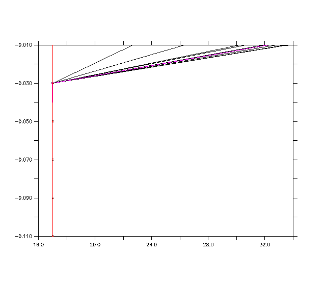

Dear Colleagues,
I have a 0.6x0.6 degrees simple grid setup with closed boundaries and constant initial fields for tracers (temp=17C, salt=20ppt).
I also use constant values for the BULK_FLUXES (Tair=23.567 C).
There is no wind or surface momentum flux and no salt or freshwater input from the surface.
When I check the his file I see high temperature values at the surface.
In the following figure red color is for the initial value and the purple is from the latest timestep (after 7 days).
As it is depicted the values go upto 32 C.
What might be the cause for this ?
I have the version 594 and my application.h file is as follows.
