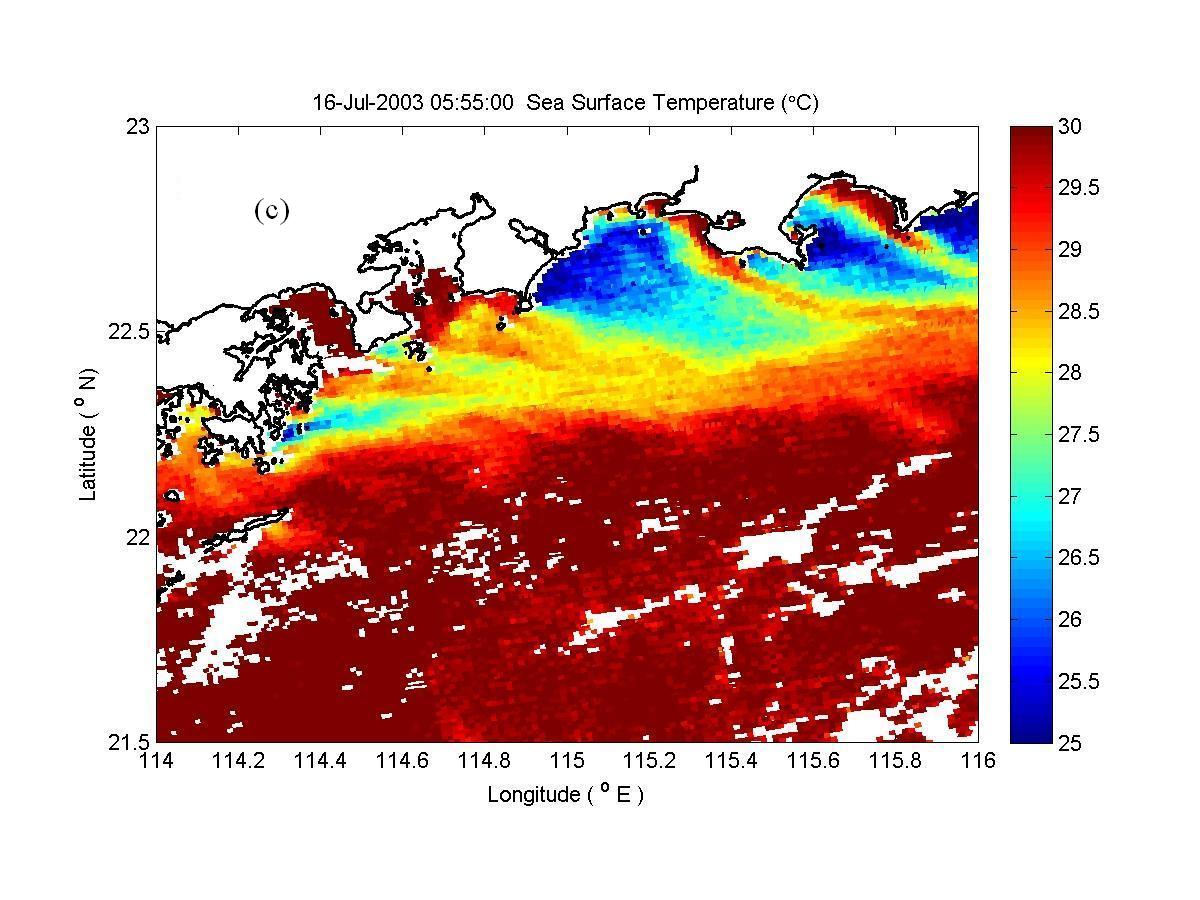

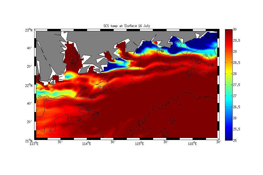

we dected the dramaticlly offshore transport of cold water off Guangdong coast, but I failed to reproduce this phenomenon. Attached are MODIS SST and my model result. Any suggestions are greatly appreciated

Model SST on 16 July
MODIS SST on 16 July
Re: offshoreward jet
This is largely a wind-driven event, right? What are you using to provide the surface stress to the model? BULK_FLUX? Stresses computed elsewhere? At what temporal and horizontal resolutions?
