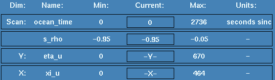

Re: Some questions about using ncview
Many thanks for your quick and vast answer. Also excuses for my, maybe a priori, simple questions about ncview. i think it is a very cool program and i would like to take advantage of it.
That is what i wanted to know: if different sections could be plotted, but i don't have the options you mentioned to do that in the controls screen. When i tried to change the axes, the pictured attached is what i see on ncview. So since, due to you say, that probably my files are 2D, but my computation it is assumed 3D
#define SOLVE3D /* use if solving 3D primitive equations */
Any suggestion?
thanks in advance and excuses for my questions.
Any suggestion?
For the purpose of Ncview and my post above 2D-, 3D-, and 4D-variables means
2-, 3-, 4-dimensional arrays.
The picture you attaching is exactly what is expected: your netCDF file have shown
all four netCDF dimensions, namely xi_rho, eta_rho, s_w, and ocean_time for the
variable you are trying to see. Highlighted dimensions -- xi_rho, eta_rho -- are
currently selected axes. You can change this by point and click.
thanks shchepet.
I didn't realize that when you select 3D variables, for instance, u,v,w, and plot X-Y map, also you can change (just clicking), in the enabled button or edit, the different depths.In my case from -.95 to -0.05. Now i can get 2D-map in diferent z-level.
Let me say that the quality of the plot and the .ps file by ncview it is much better than the matlab one. i think ncview is a very cool program and remind me gnuplot (simple but very cool)
thanks.
thanks.

a wrapper around the standard netCDF function.
So what you are observing -- you have to wait until the run is complete -- indicates
that this mechanism does not work.
To debug, edit file Modules/mod_netcdf.F and place a print statement just if front of
the line (there is only one occasion) and see whether it is actually called.
any buffered writing to the disk): as long as file is not closed or forcefully
synchronized, the data does not land onto the disk, but in the memory of the machine,
and consequently, is not accessible by any process other than the writing process
itself. This is done to improve performance, so many small pieces of data aggregated
before being written onto the disk. So if you run the model and see how it progresses,
and, simultaneously try to read its netCDF output you may see less data than expected.
However, ROMS is designed to synchronize netCDF files after every time record, so at
the end of "wrt_his.F", "wrt_rst.F", "wrt_avg.F", etc files you see calls like this:
! Synchronize history NetCDF file to disk to allow other processes
! to access data immediately after it is written.
CALL netcdf_sync (ng, iNLM, HIS(ng)%name, HIS(ng)%ncid)
IF (exit_flag.ne.NoError) RETURN
it happens) so once the model passes this point ncview should see the correct number
of records.
Subroutine "netcdf_sync" is defined at the end of Modules/mod_netcdf.F and is just
the line
status=nf90_sync(ncid)
