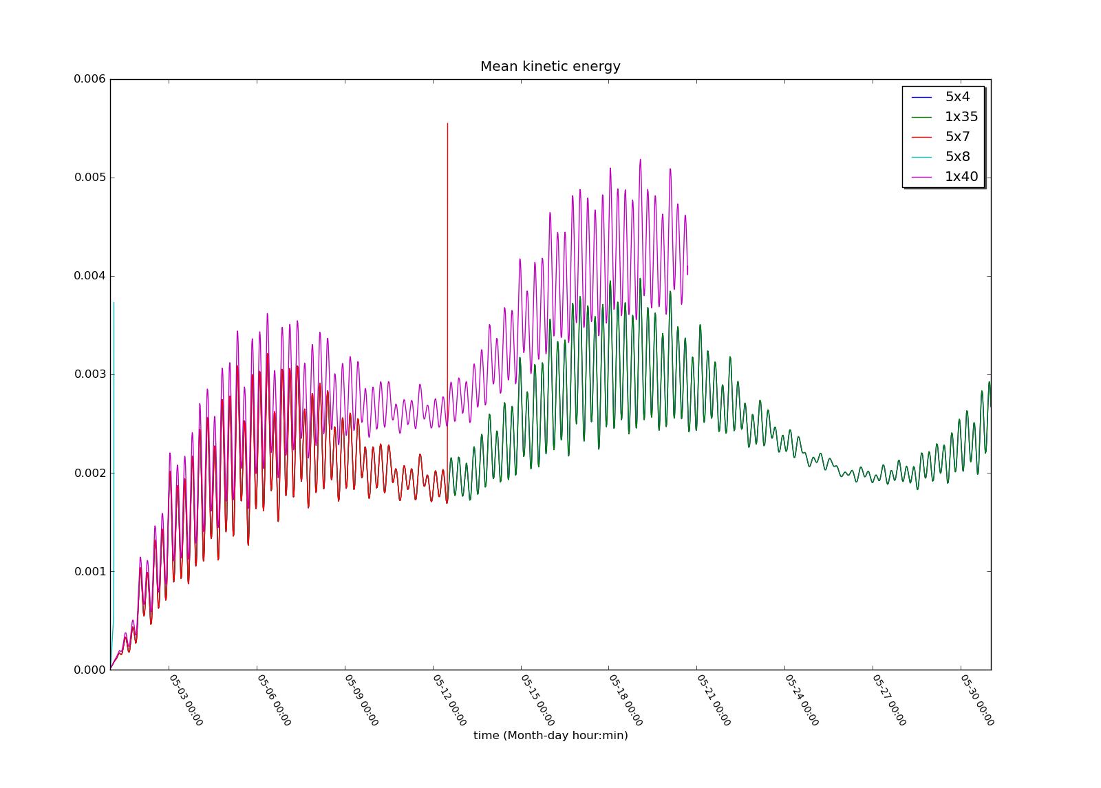

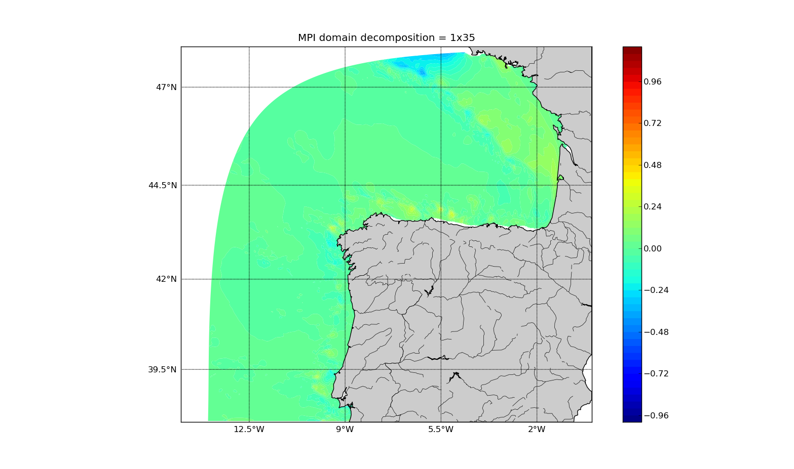

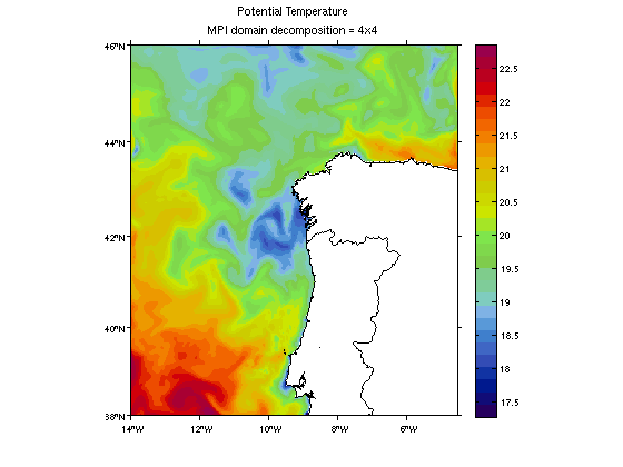

With the different configurations, normally there is no difference in the mean kynetic energy (up to the point when it blows up), as you can see in the figure attached (the blue and green lines overlap). But with some configurations using 40 processors (both 5x8 and 1x40) the mean kynetic energy increases, owing to a strong current near the southern boundary, that you can see in the plot. The configuration 1x35 worked, 1x40 didn't.

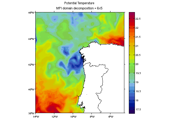

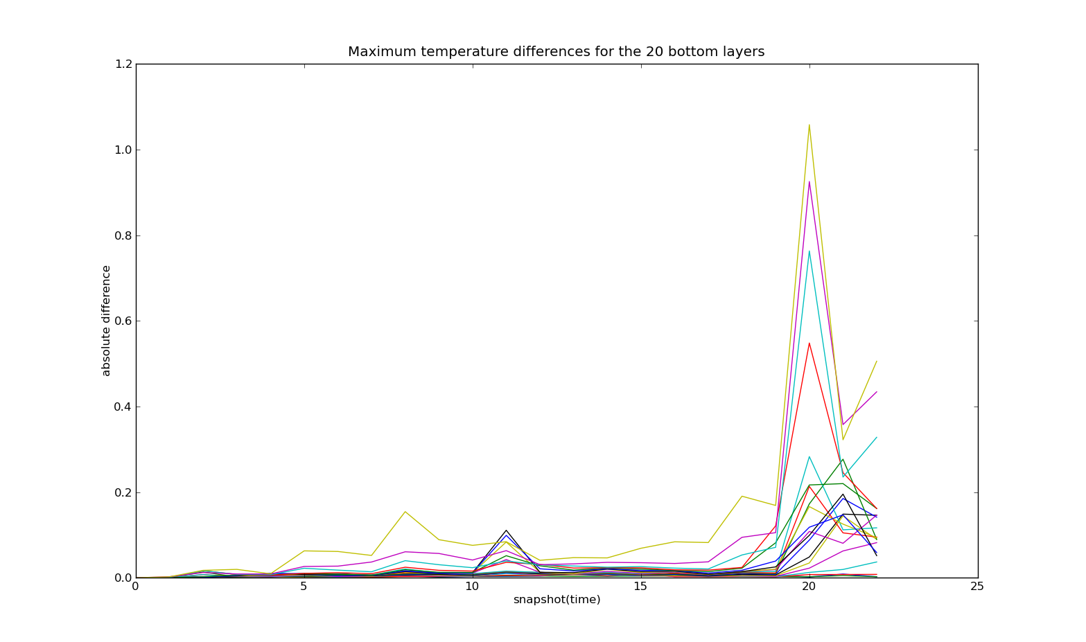

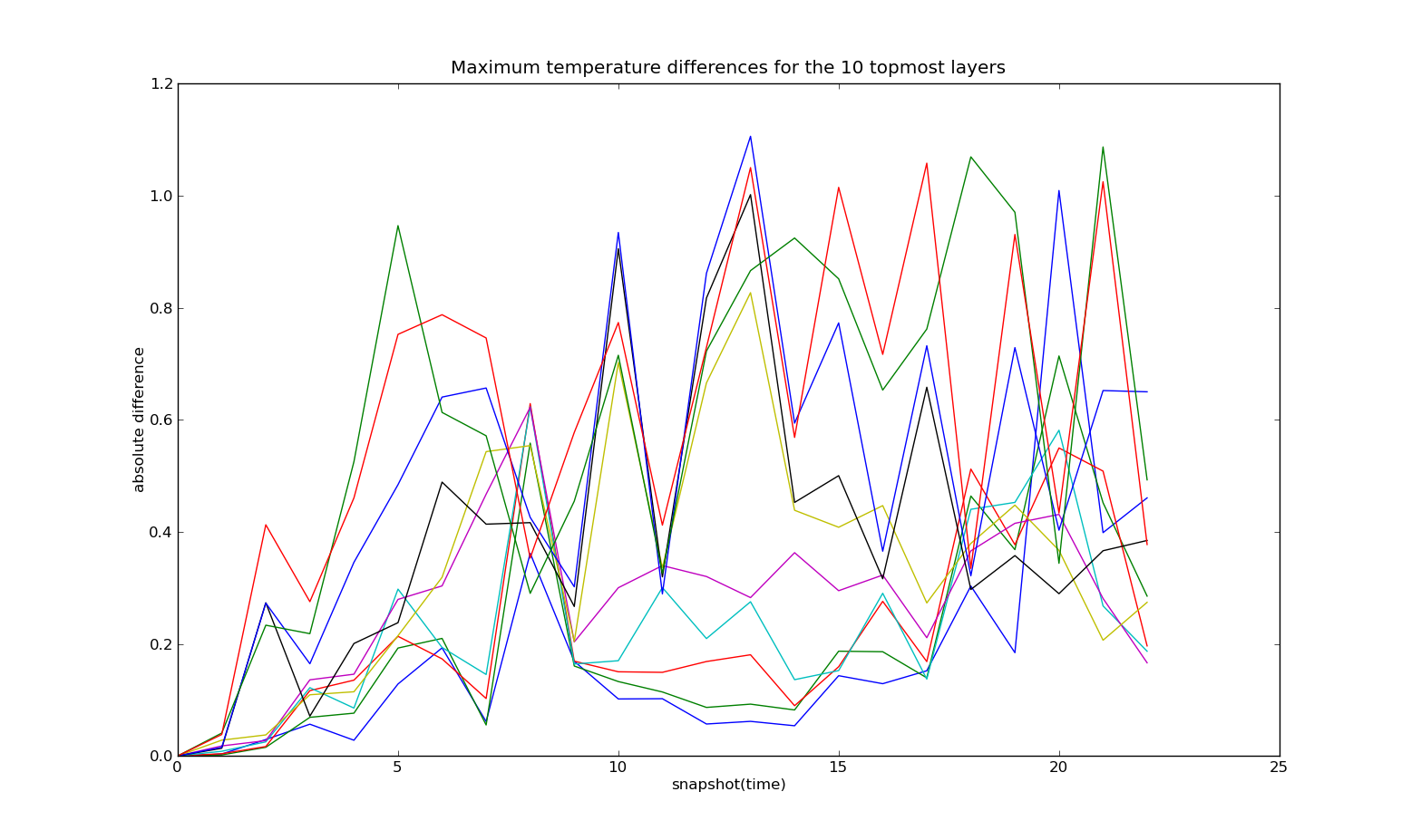

So far I had compared the solutions visually, and they seemed equal to me. But today I took the two configurations with 35 processors (5x7 and 1x35) and compared the temperature at every layer. The difference is relevant for the top layers, as you may see in the figures attached, from the very beguinning. The differences in the bottom layers are much smaller, up to 2 days before it blows up (the output is saved every 12 hours, approx.)
The values of Lm and Mm are Lm = 258 and Mm = 508. I picked some bad numbers. 508 is only divisible by 2,4,127 and 254. If I had chosen 500, or even 507, I would have more options. 258 is only divisible by 2,3,6, and much bigger numbers. I will try a decomposition in 6x4, which gives integer values of Lm/NtileI and Mm/NtileJ, as you suggest.

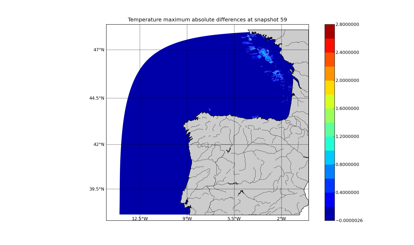

The run for the 6x4 domain decomposition didn't work either. Besides, I noticed there are differences between the OpenMP 4x4 and MPI 1x35 runs. In temperature the maximum difference is over 2.5 degrees. The differences in temperature, salinity, zeta, u and v concentrate near the shelf break, mainly, and have a similar pattern.
