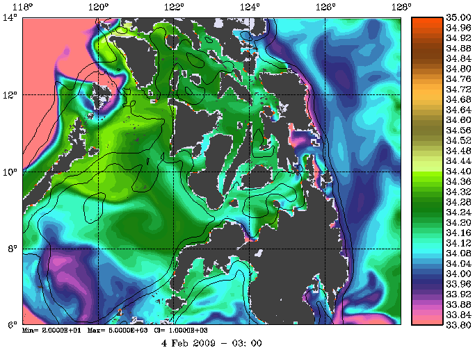

I have not seen this yet but I noticed that you are not including the zebra palette (it is nonlinear) and great for salinity sometimes:

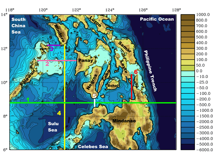

I also like the GEBCO palette for topography (ocean and land):

I don't know. This is plotted with ROMS plotting package. I also have Matlab scripts for these palettes.

It seems the figures posted by Herman are plotted by ROMS Plotting Package. On seeing the sections(marked by 1,2,3,4,5,6) on the second figure, I think of one question that has always been in my mind-- Can the plotting package plots sections that are curve or connecting any two locations, instead of exactly zonal or meridional ones?
