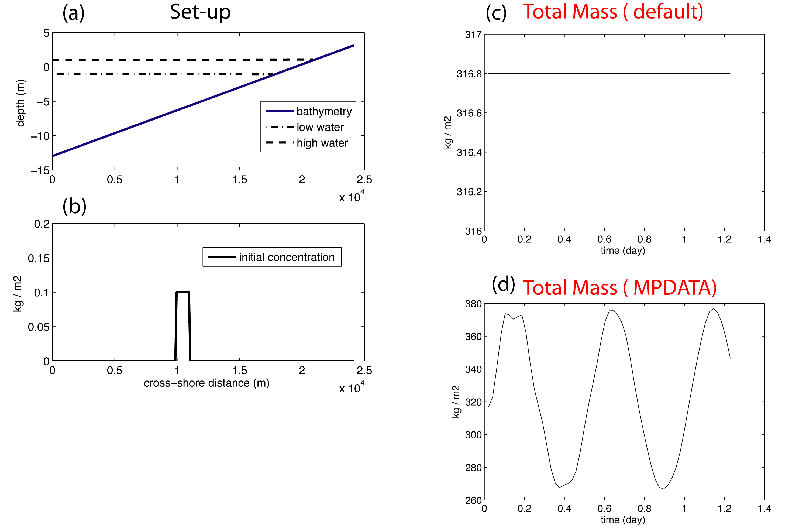

I set up a very simple case to test whether passive tracer is conserved in shallow waters. I used sediment as a tracer (only one size class) but set the setting velocity to zero. So it behaves like passive tracer. When I used the ROMS-default advection scheme, the total mass conserves very well (see figure below). But, when I used TS_MPDATA, the total mass is not conserved.
Setup:
In Fig 1(a) below. A beach with a constant slope (slope is 4m/6km). The north, south, and east boundaries are closed. At the western boundary, I imposed M2 tides with WEST_FSCLAMPED + WEST_M2REDUCED + WEST_M3GRADIENT (tidal amplitude is 1 meter). There are 243 x 48 x 10 grid points (east-west, north-south, along-shore, vertical, respectively). The dx and dy are 100 and 200 meter, respectively (x is west-east). Maximum water depth is 13 meter.
Initial condition:
In Fig. 1(b) below. There is an uniform patch of tracer (concentration is 0.1 kg/m3) from grid point i = 100 ~ 110, and j = 1~ 48. So, this is a 2D problem
Results:
Fig. 1(c), total mass conserves very well when the default advection is used.
Fig. 1(d), mass is NOT conserved with TS_MPDATA
Sensitivities:
I changed both barotropic and baroclinic time steps, but the results remain unchanged
DT = 60, NDTFAST = 20
DT = 60, NDTFAST = 60
DT = 30, NDTFAST = 30
DT = 10, NDTFAST = 10
Any suggestion is highly appreciated!!

I forgot to mention that the patch of suspended sediment never reaches the open boundary within the first two days.
John Warner has helped identify a potential bug in sed_settling.F
He suggested:
line 177 (or close to that number):
              qc(i,k)=t(i,j,k,nnew,indx)*Hz_inv(i,k)
relace that line with:
# ifdef TS_MPDATA
              qc(i,k)=t(i,j,k,3,indx)
# else
I recompile, and it works!!
